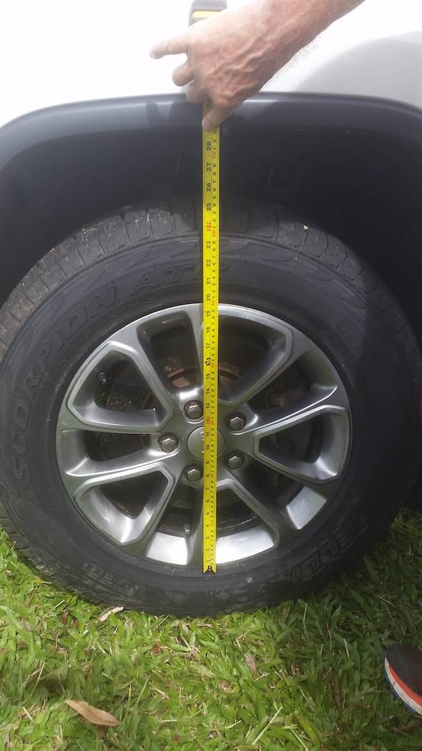

I’ve always been taught that to properly measure ride height, measure from the bottom lip of the wheel, through the centerline of the wheel to the edge of wheel opening. If you measure from the ground, you are also measuring the tire.

Wow I just looked to see if I could find a picture to better illustrate ride height measurement but most are showing the incorrect methods (one method is technically OK, but difficult to be accurate - shows center of wheel to wheel opening edge. Depends on how good you are at estimating the center of the wheel). Using the bottom edge of the rim is the easiest to get a consistent measurement every time because you can just hook the tape measure on the rim and pull up and line up through the center of the wheel.
anyway, this is not a mustang, but the process is the same.
