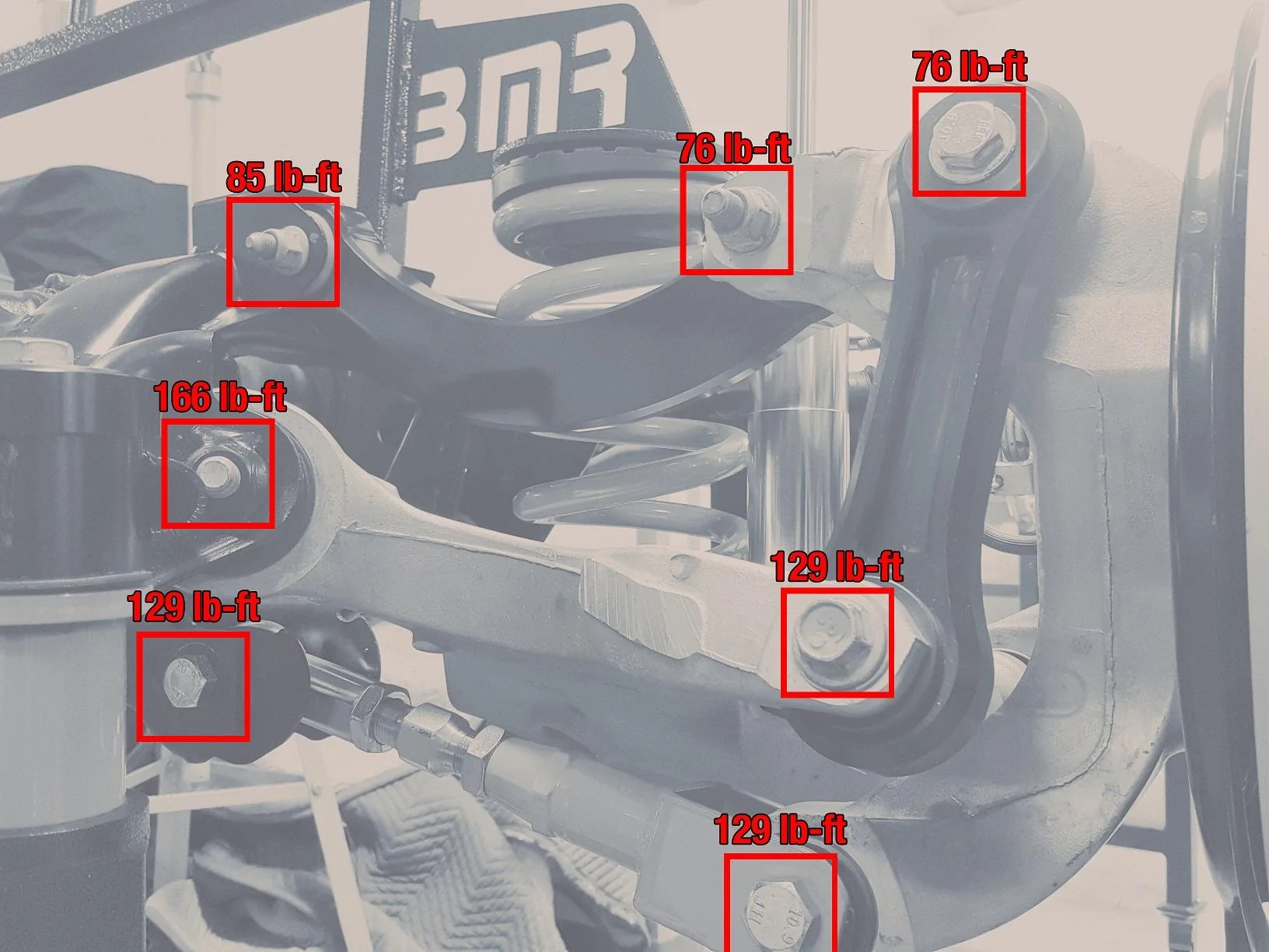

So I’ll check the strut to knuckle bolts for torque and the strut nuts for being there and torqued. I am confused about which bits of the irs need to be clocked? And by clicked I assume you mean losened and then torqued while under load. Would you recommend the subframe bolts themselves? The guy I spoke to at lmr said he just loseened whatever he could reach inside the wheel well. Didn’t get under the car. Is that what you are referring to BmacIL?

All the rubber in the suspension should be clocked. The important ones are the forward/upper arm in the front, and the front inner point of the rear control arm. It's also a good idea to do the outer camber link.

Everyone thanks for all the help! That thread on clocking the rubber mount fasteners was super helpful! Now if only I had a 4 post lift!

Hey BmacIL, you say the important ones are the forward/upper arm in the front and the front inner point of the rear control arm. Could you elaborate on that? I wan to make sure I understand completely. Do you mean the front inner lower control arm and the outer control arm bolt? I'm referring to the wording cited by Coaster in the thread that you linked to. Not to be a hassle, but if you don't mind using that wording, that would help me clarify exactly which ones are most important.

Did you see the pic on page 7? I don't know which one he was referring to, but the image definitely helped me to understand it better.

Now that you post that, I remember seeing it, I think I was just bogged down by knowledge at that point.
