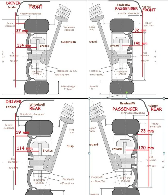

I´m planning to change the wheels of my 2016 Mustang GT. To calculate the best offset I measured the fender clearance from the rim lip using a wire with a weight, sticked to the outer fender.
My surprise came when I measured the other side, to confirm, and there is a difference. About 5-6 mm. On the driver side, the wheels are 5- 6 mm outer than on the right side!
To ensure that it is not problem of the wheels, I measured the distance from the disc brake to the wire, but the difference remains from one side to the other.
So my questions are:
Is this normal on a Mustang to find a difference of a wheel goes outer than in the other side?
Is it easy to fix this misalignment? My car dind´t have an accident. Maybe a camber adjust, or something similar? How can I know if the problem is the whole chasis itself? I´ve discovered Steeda sells IRS subframe alignment kit, but don´t know if this is the problem to solve or is another thing. https://www.steeda.com/steeda-s550-mustang-irs-subframe-alignment-kit-2015-all-555-4438.html
My worry is if I buy new wheels and want to be flush, the other side will poke out a bit. When the wheel is inwards you don´t see the mistake, but with the new set you see the difference.
I attach a picture with the different measurements (5-6 mm difference).

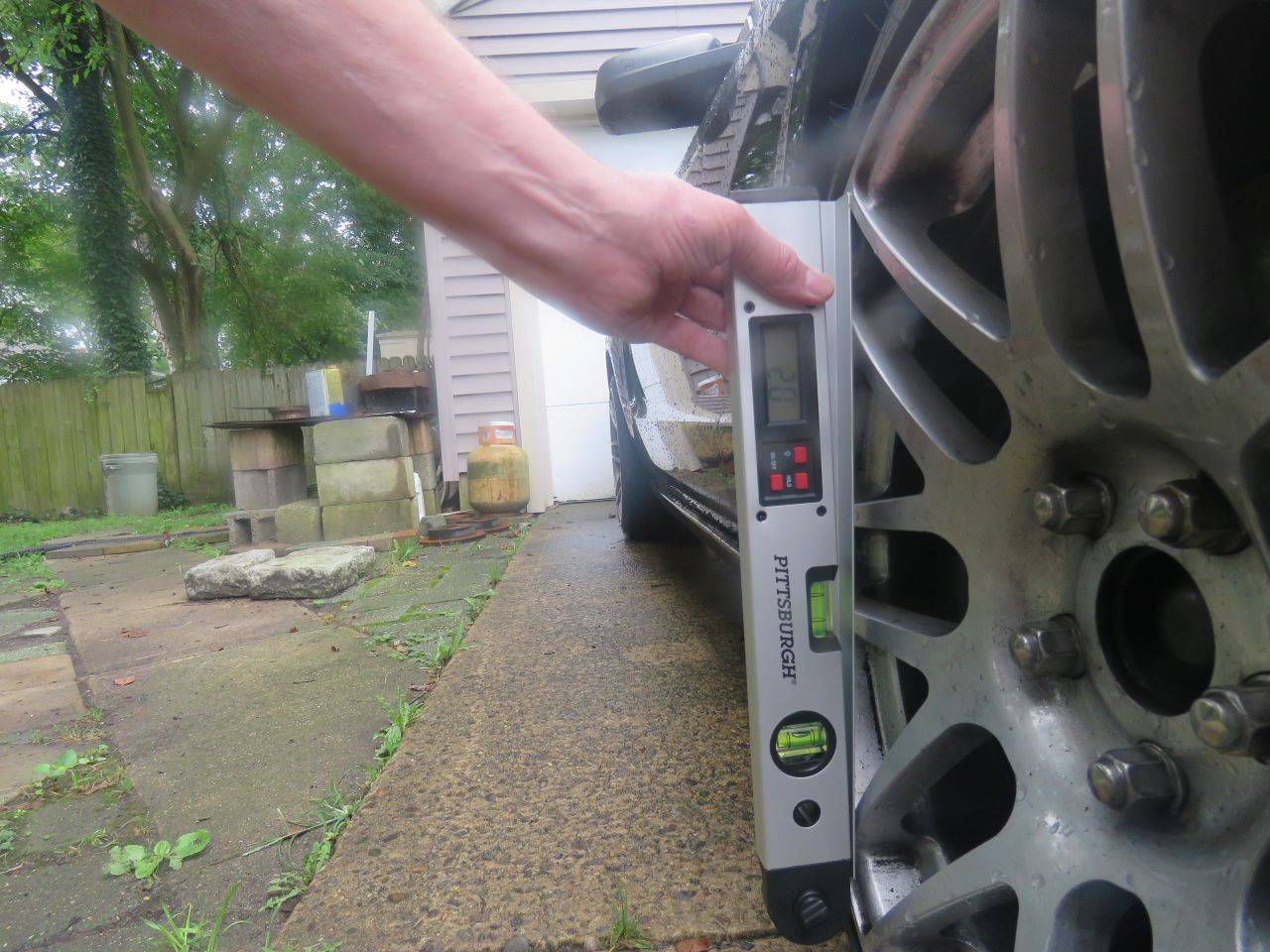

Have you actually measured it for level or at least checked it with a carpenter's bubble level? Any out-of-level will leave the car body at an angle to your weighted strings. On one side, the out-of-level error will add to the correct dimension, on the other side it will subtract, so the difference between your side to side measurements is basically a double dose of any error in setup area levelness.
In addition to making sure that the tire pressures were equal, are the tire tread depths equal side to side? I'll assume that the tires are the same make, model, and size.
But I have discovered something interesting. I have invented a very rudimentary system to know the camber angle. Well, my purpose is not to know the exact value, because is impossible without specific tools
Actually, its quite easy to measure camber, and to measure it to within ±0.1° doesn't take expensive equipment at all. This is entirely good enough for checking the alignment for a street-driven car, and good enough for most amateur track driving purposes.

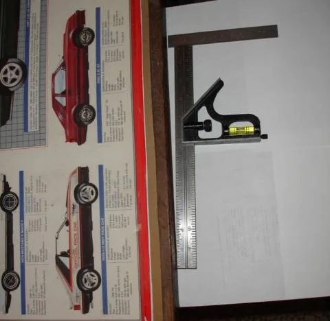

You don't even need equipment that fancy. For at least ten years I measured camber with these tools . . . well, OK, I did have to do a little pocket-calculator math to get camber in degrees.

I'm afraid you're either going to have to source some special bolts from Ford for front camber (there's a factory procedure for this) or install camber plates at the tops of the struts. There are other sources for camber bolts, but they are not full strength and I can't in good conscience recommend them. Finally, there's a couple of DIY methods of obtaining a little camber adjustability.
When you get actual camber measurements from a positively-known-to-be-level surface there are people here who can give you specific non-stock alignment suggestions if you provide some description of your driving.

I suspect your weight on a wire measuring system only has an accuracy of +/-10mm.
A good experiment would to be repeat the same process (without looking at the old numbers, i.e. cheating) and see how well the new measurements match the old.
It´s a good idea because the way you measure can add or sustract a pair of mm. If you think the accuracy is 10 mm, then it´s better not to contiune doing these measurements. I only want not to have surprises when I purchase the new wheels with different offsets.
Measure once, then turn the car around 180 degrees and measure again.
You had the same idea I had when I read Norm´s post. Read above. Thank you very much for your suggestion.

What you can do is level up your setup area using something like vinyl floor tiles to shim under the low side tire locations. Or, you can take careful side to side measurements and determine how far out of level the concrete is, and work that angle back into your measured cambers to get true cambers.
Don't worry about your English on my account. I spent a good number of years working in an engineering office where English being somebody's second language was a common occurrence.
