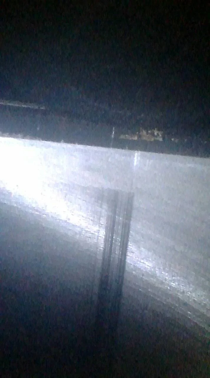

I did an oil change on my 19 at 3000 miles and all was well. Checked the oil at 4000 miles and it wasn't even on the dip stick. It took almost 2 quarts. I decided to scope the cylinders. A photo of cylinder #5 is attached. All cylinders had some level of scuffing and scratches but nothing like #5. Brought it to the dealer and they did a consumption test where it used 2.6 quarts in 1000 miles. This was last November and since I was putting the car away for the winter, we decided to re-visit this spring. Well, now we're into this pandemic and my dealer is running with a skeleton crew so I'm just driving it and keeping an eye on the oil. I guessing a new short block in in my future.
