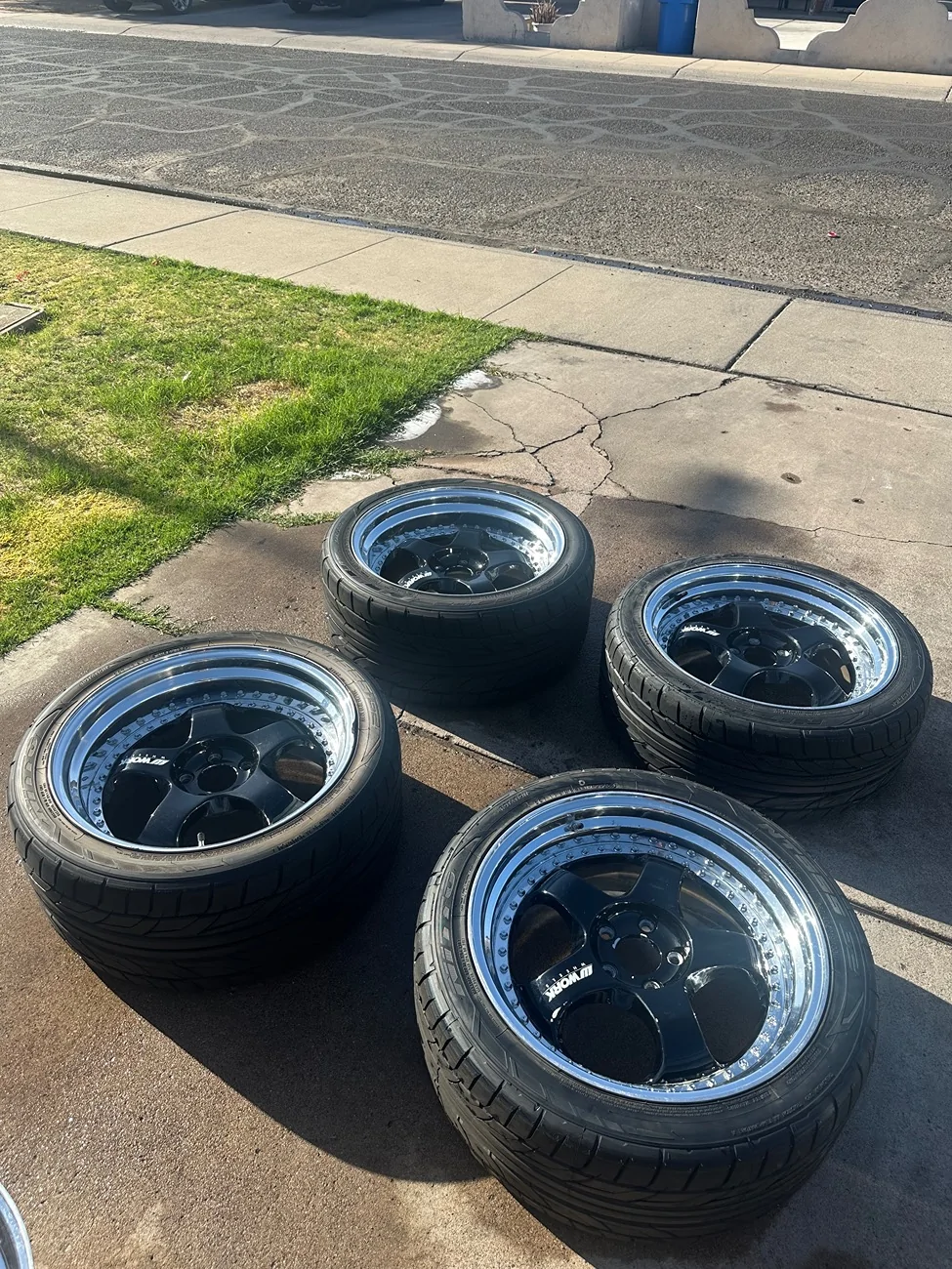

Hello, I recently purchased some work meisters S1 for my Mustang. I am running into a clearance issue with the fronts. I have brembo brakes. Even with a 10mm spacer it was hit. Is there any solution to this ? Or I’m I screwed and have to sell my wheels. Thank you !

What is hitting? The face of the caliper or the border? If face, more spacer. If border, SOL.

It’s hitting towards the top/middle of the caliper. Thanks for the reply !

To do it right, get the right wheels. If the clearance just off a tad, maybe a slight grind on the offending area of the caliper. Im not in favor of this, but I have seen it done.

what is the rim dims?

I agree with you. It’s hard to let go of them since they are my dream wheels for this car but very true.

they rub on the top center? That is odd. Honestly if the wheel doesn't fit I would not grind on the caliper. sell the wheel and buy some that fit the brakes

Yea I think that’s the best option. Work wheels USA do not sell faces so I can’t even make them fit

If you’re really wanting the wheels, you could always replace the brembo’s with the standard GT 4 pots
