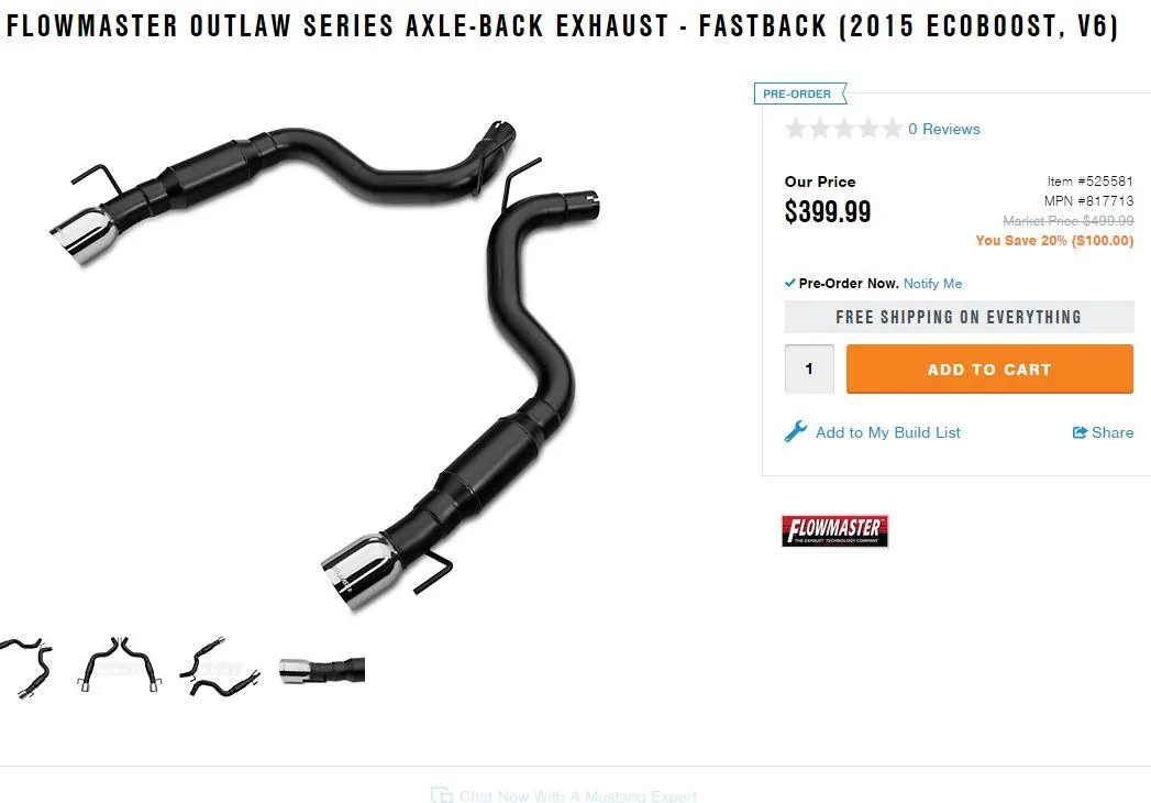

Wow, just watched your drive by vids, and it sounds better than any aftermarket exhaust I've heard so far. This might be it IMO and it's way better than wasting money on overpriced systems like the Flowmaster Outlaw that's basically a muffler delete
