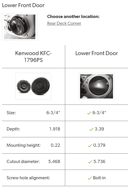

When Crutchfields shows you this
That means it will fit your car without modification using the brackets they provide. So the answer to your question is no it won't run into your door panel or rear package tray if it shows it Fits like above. If the speakers you want show this for your car, you are good to go and you don't need to bother with the extra info below.
Note that they only provide brackets that work for the front door and rear deck. They do not provide a midrange bracket, you will either need to fabricate one or modify the exiting midrange speaker to accept your new midrange speaker.
Keep in mind there are a lot more speakers available that will work in the Mustang if you don't limit yourself to the Metra bracket that they offer free with their speakers.
I have Morel speakers that technically do not fit for the reason you asked about, the Metra adapter is tall so a speaker with a little more height and more excursion can run into the speaker grill. I am using a fabricated bracket that's thinner than the Metra giving me the extra clearance I need in front of the speaker and still have plenty of room behind the speaker.
It just so happens the Metra bracket is pretty tall, without looking it up is in the neighborhood of around 3/4" IN so fabricating a 1/2" or 3/8" thick bracket gives you extra room, you just need to double check your mounting depth of which there's plenty for most speakers. With a shorter bracket, you will likely need Fastrings or some other foam product to close of the gap created and keep your sound from leaking into the door panels.
When you click into the Fit Info link it gives you all the info you need to figure things out

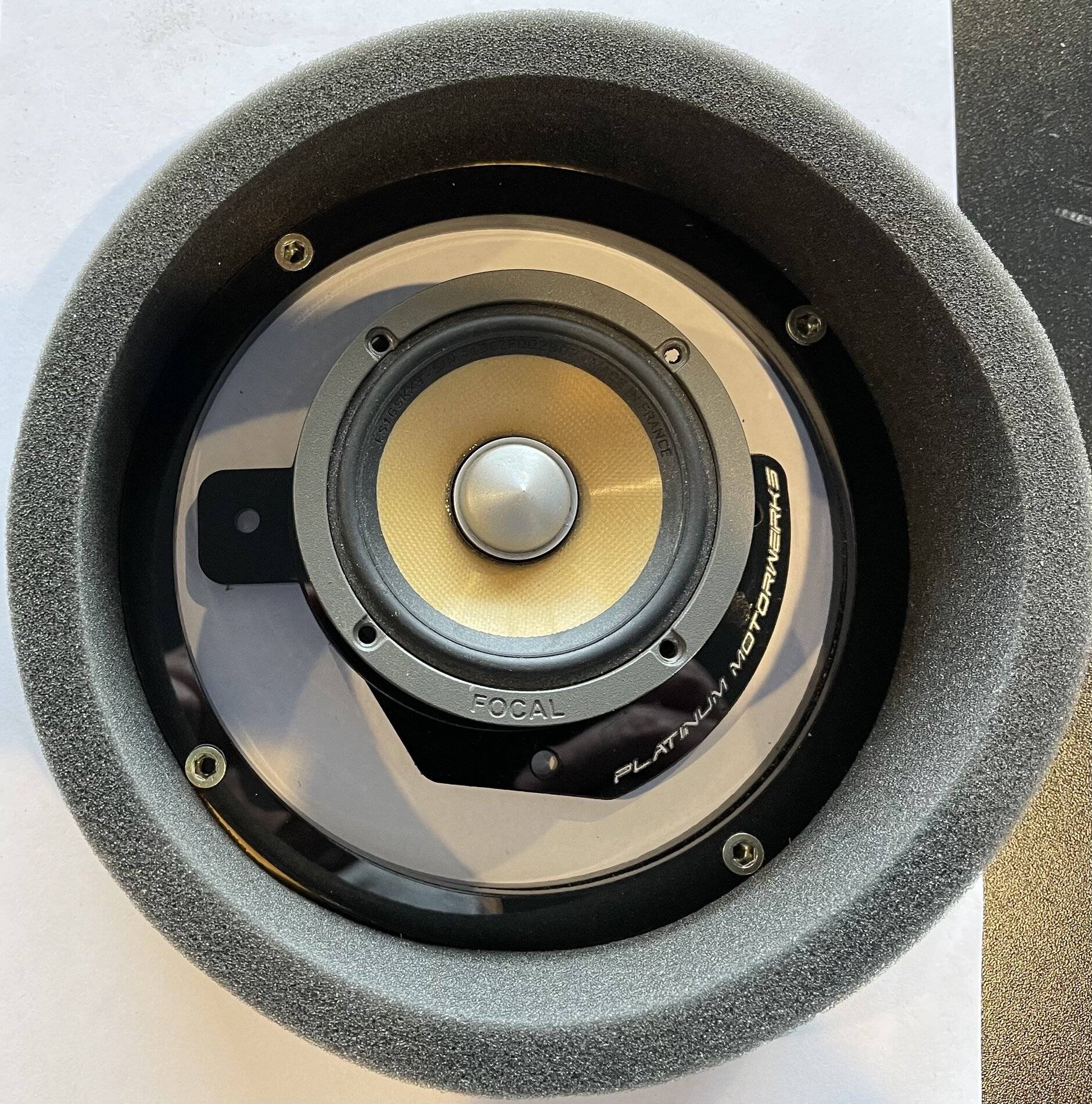

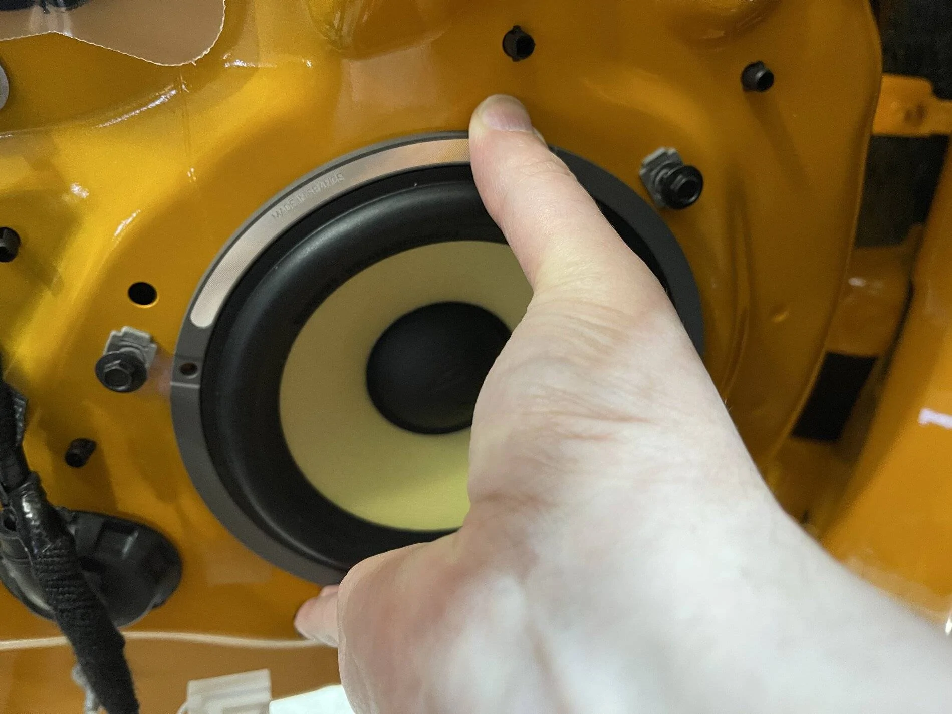

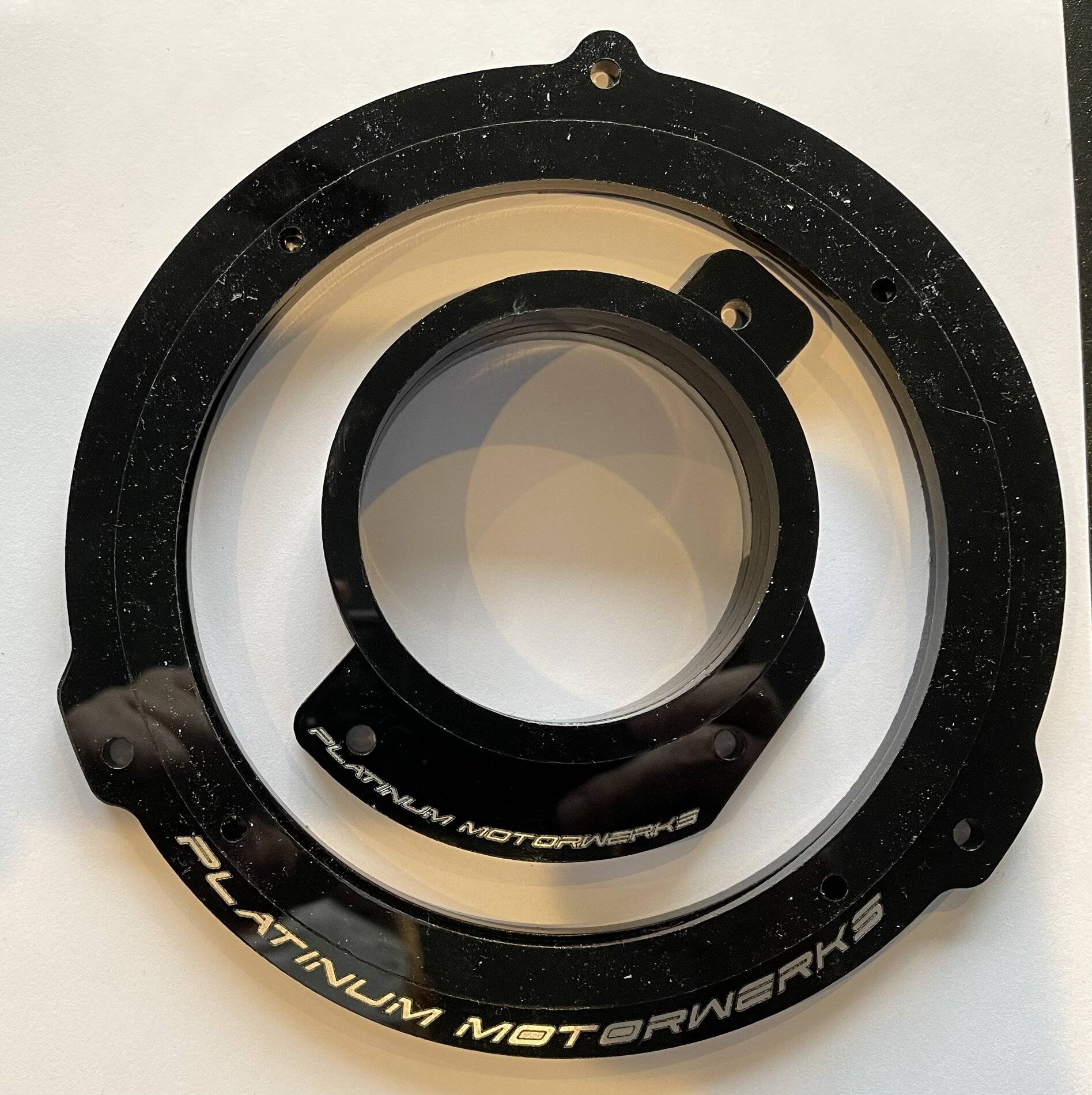

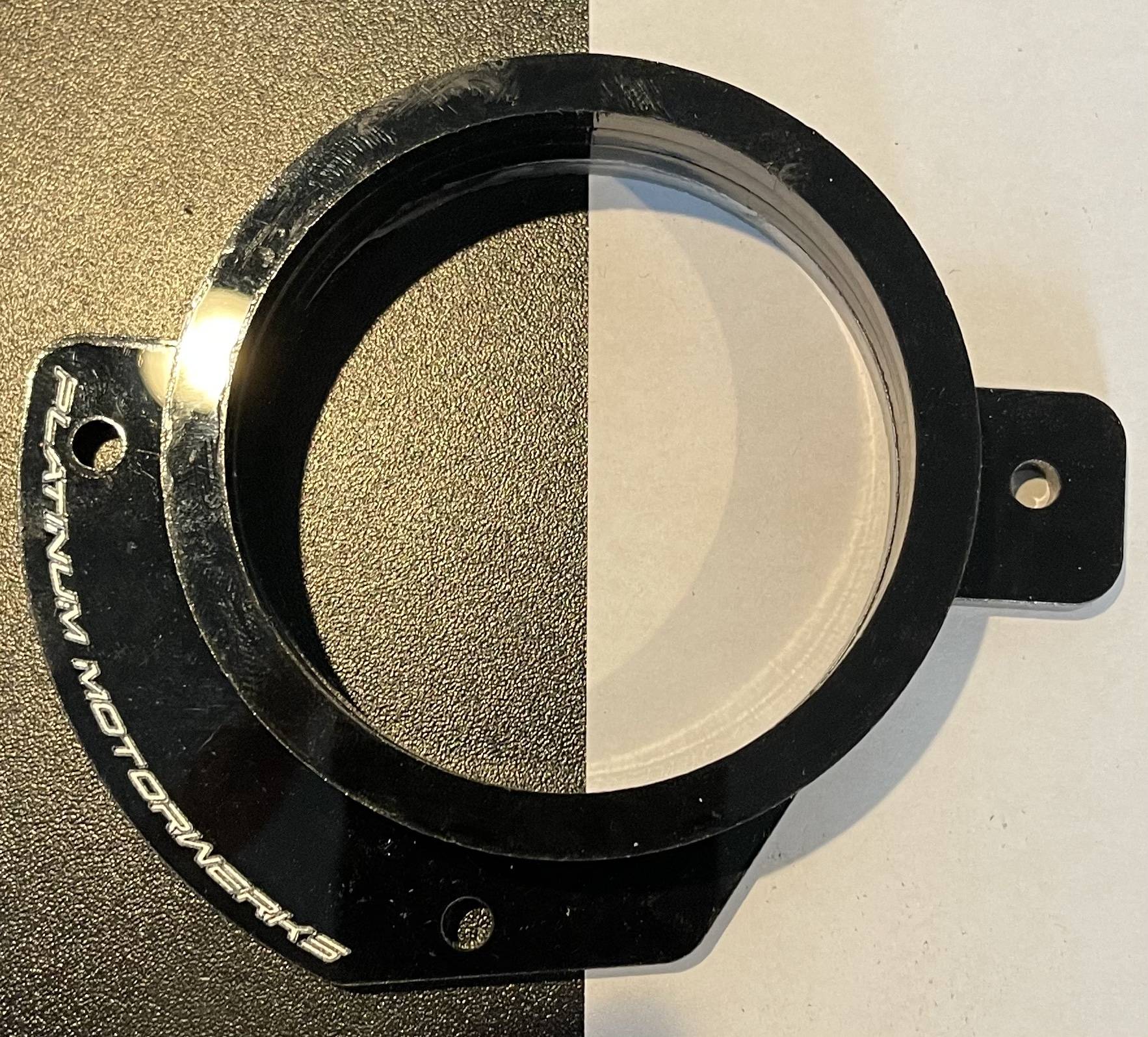

Here is my solution for the 3-way Focal component set. I had my fantastic local shop (Platinum Motorwerks) laser cut the adapters. The adapters mount to the door using the stock screws. The woofer adapter has threaded inserts for ease of removal of the driver and a built-in flange for the FAST ring. The midrange adapter thickness + speaker flange thickness is a little bit less than the stock adapter + stock speaker, so no annoying door panel buzzing.
