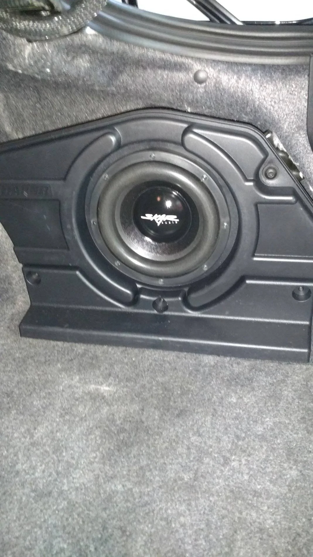

I just went with a sundown 8" and left the factory sub there, doesn't bother me. I think its also better if you get a custom box made for your new sub and replace the location of that one

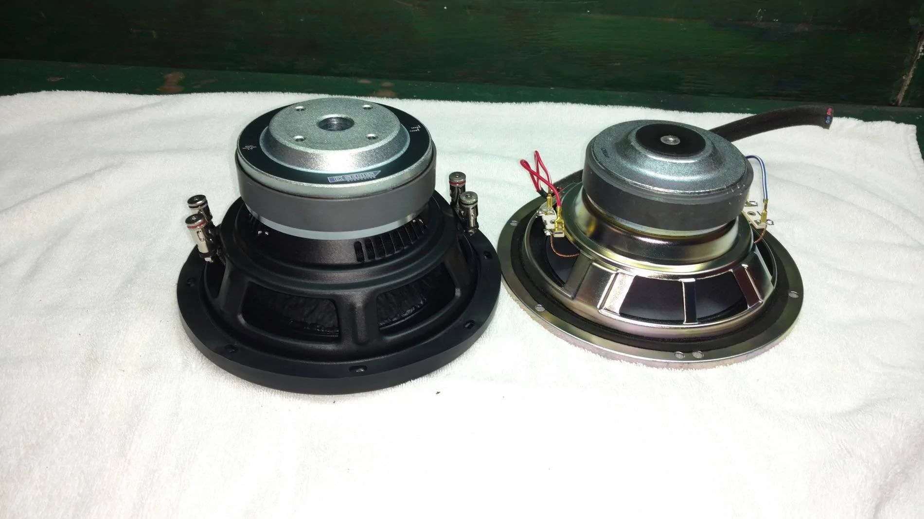

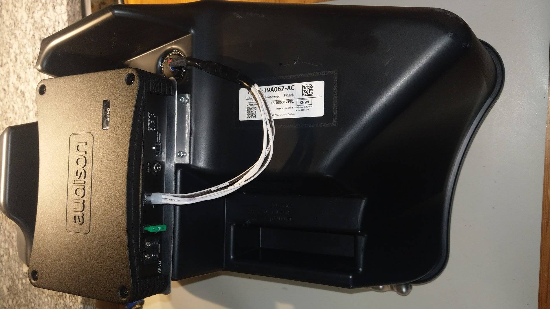

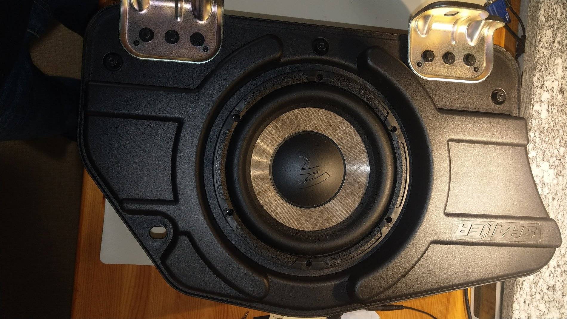

I replaced the shaker sub with a different sub.
The sub was only bolted in from the back. Once you removed the screw and the front cover, it was not difficult to remove the sub.
When you plan to replace the sub, consider that the amplifier delivers power for 2 coils in the subwoofer. And the shaker sub has actually 2 coils.
There are only very few direct replacement subs available out there. I replaced the amplifier as well and therefore had no issues.
My sub is a Focal P20F and my amp is a Audison Prima AP1D.
