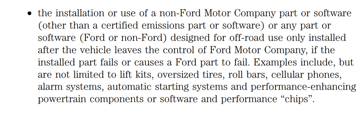

Lol according to this Ford can void your warranty for the "installation of a cell phone" LMAO...
Just saying don't worry about it too much most dealerships will just tell you to take the parts off before they work on the car. They wont rat u out.

Ford cannot "void" your warranty.
That is 100% against the law.

"Void" is the wrong word to use when discussing mods and warranty work. A repair may not be covered if it was caused by a modification but that is not the same thing as "voiding" the warranty. For example, if I put a Whipple supercharger on my car and the engine blows up, Ford has every reason NOT to repair it under warranty. However, if I put the Whipple on and my power window, air conditioner, sound system or some other unrelated item fails, it is absolutely covered as long as I am in the warranty period.
I have had tunes and other mods on every car I have owned for at least 10 years and NEVER had a warranty claim denied. I will never forget what a service manager told me once when I was looking at a used Mustang with a CAI and full exhaust system. He said, "I don't pay my techs to find reasons NOT to do warranty work and we sure as hell don't look for ways to piss off customers by refusing to honor warranty claims." He went to to say that there are occasionally cases where Ford asks for photos or documentation if a repair seems sketchy but that is more the exception than the rule.
