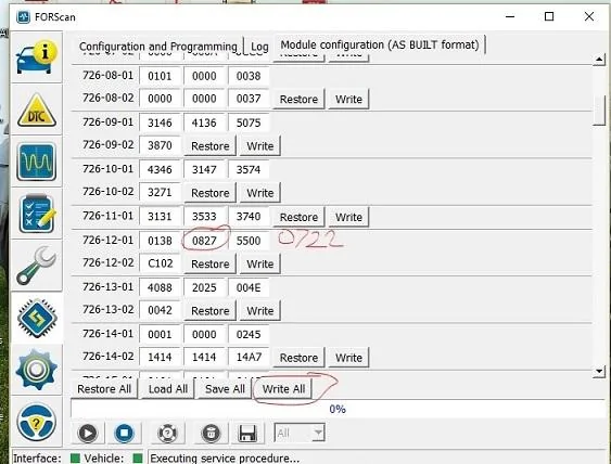

Ok I found the axle change code. I had 3.55 and put in 3.15. Now if I change the tire size (305/35/20) according to the spread sheet this is the change. Do I enter it and hit write all if no other changes? My speedo is off 5 mph at 80.

you could just write the 726-12 block.
Thats all I want to change. There is not a write on that line so I assume my only option is write all at the bottom
The write button is just below the 5500 in your image.
The individual block write buttons write everything between the horizontal lines that contain that particular write button.

THANK YOU! Now I see.
Change your axle ratio first, drive the car and measure your speedo against GPS, then make any necessary changes to the tire size section.
Both the axle ratio and the tire size affect your speedometer output.
when i do this i get an error " invalid..... are you sure you wanna do this" what am i doing wrong?
The last Bytes are a checksum which will be wrong, but automatically adjusted.
The incorrect checksum throws that "invalid" message. If you allow it to continue you will notice that the checksum changes after the write event.

ok.. i am trying to change my tire size.. i only need to change part of the line and kept getting that error..... so its normal? i dont wanna mess it up..lol
worked great..... thanks!!
