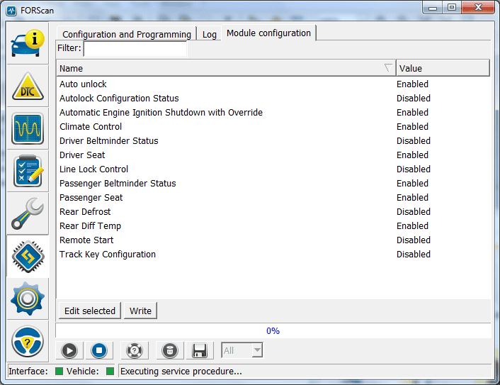

So, Line-Lock has been found and enabled - but can that only be done on vehicles with a certain hardware package? The resulting info in this thread is not real clear if Line-Lock is only a software change via As Built or can only be activated if software and certain hardware coexists. Please clarify.
I have enabled the line lock and i can now see it in track apps but it is grey'd out and can not be selected.
Am i missing something else? Can some one with line locker activated post some info for us.

Does any one know what track key is and what it does?
