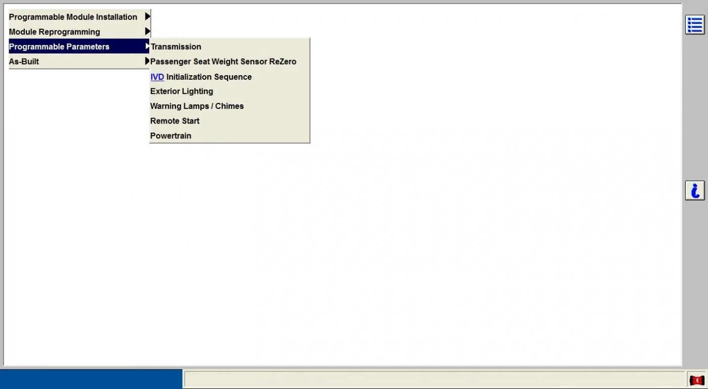

I would have to look. I don't believe it's available with the ids to adjust and I can't recall if it's even a PID when running diagnostic data. I would like to have mine available on the dash as well. I'm sure it's possible with enough work
I am one of the few who thinks IDS is boring lol... I barely use it anymore except to check for module firmware/calibration updates in Module Reprogramming.
Not much in there for programmable parameters for my vehicle.
