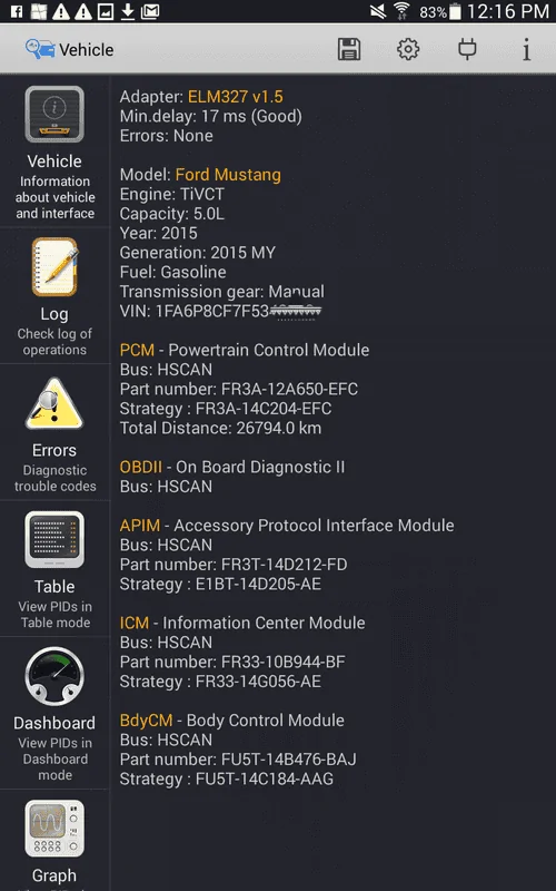

Am I doing this right so far???
Found that FORSCAN will connect up and read thru the BT/OBD2 connector that I already have. Hoping that it can write also....
