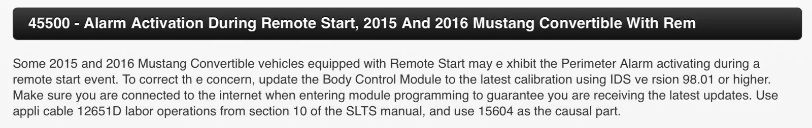

One thing that is still an annoyance is this: I bought the car with factory remote start and used it fine for a few months. It then setting off the alarm right after starting and has done this consistently since. I've had it in for service on this three times and gave up after the last time. Techs at first said nothing was wrong, then they said they wanted it back in because they suspected the alarm was mis-reading the vehicle angle. They replaced that sensor and said it was fixed. I remote started it at the dealership when I went to pick it up and the alarm went off right in front of them. I just SMH and drove away, but I am starting to think it could be as simple as the break-in mics triggering from my exhaust. It's not open-pipes loud, but it's pretty throaty before the car idles down.
That said, is there a setting we can get to that could turn down the sensitivity (or turn off) the break-in mics so I can test this?

Tell you servicing Dealership to follow the instructions in the attached Ford SSM 45500...
