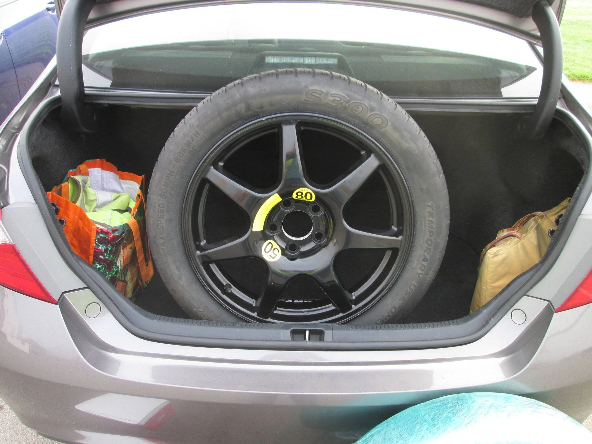

I bought a spare tire kit. The tire on rim, jack, lug nut wrench. Was expensive , 500 bucks but the rim fits fine over the brembo brakes. The rim is black like the stock tires. Automotive Authority has them.

My AA spare fit easily into the pit, I didn't need to use the little extension. The panel covered it perfectly. I have roadside assistance coverage but being towed to a probably closed FORD dealer while away from home on a trip just is not a good solution for me.

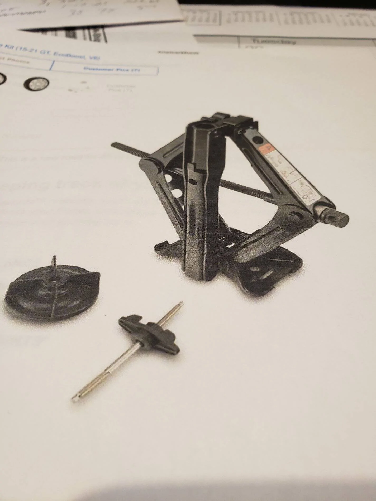

Was debating about where to get the jack and other hardware, when I remembered the 42,000 Ford Pass Reward Points that I earned when I bought my new 2019 BULLITT last February. It took several calls to the dealer and Ford to find out how the points worked. Most people use the reward points in the service department. With the plan formula 42,000 points converts to a cash value of $210 towards parts through your Ford Dealer (can't be redeemed online). The parts guy has to have the service dept. open a ticket against your car in order to pay for the parts. I was able to get the trade price and got the jack parts at no cost to me. These are the 4 items needed. Jack: HR3Z-17080-A ; Wrench: FR3Z-17032-A ; Retainer: ES7Z-17091-A ; Storage Compartment Retainer: ES7Z-1424-A. Retail for this group is around $220.

Great info. I already had a jack and just bought the Ford lug wrench. Good to know for future purchases though.

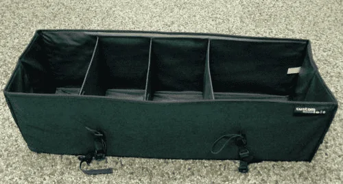

Ditto on the above, but took it just a bit further. Ford (or aftermarket) makes a nice little storage area compartment organizer (below). The partitions fold back & the left three (3) compartments will neatly contain a Harbor Freight aluminum jack. Wrap it nicely to minimize movement while driving. The jack handle splits in two (2) & fits in the same area as the jack. The organizer slides forward & fits perfectly between the rear wheel housings. What's left will easily accept two (2) suit cases + a suit bag or two (2) across the top.

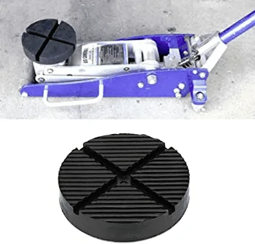

A couple of quick notes ... 1) Get one of those nice little jack pads (below) & 2) Pack a couple of large heavy duty trash bags to put your busted wheel/tire in cuz they will have to go into the rear seat area. Both of these items can be packed in w/the jack. Fortunately I had everything in place when my LR tire became a DOA @ 6,000 miles. :curse:
