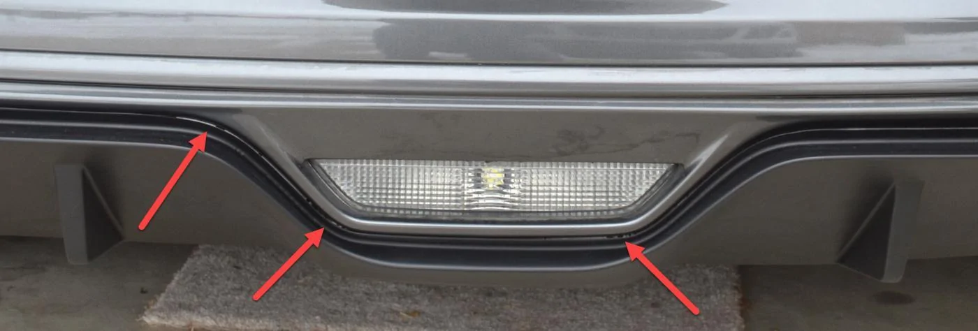

Diffuser has been on the car for a week and has not left the garage since install. The diffuser is already beginning to separate from the rear bumper. :mad:

Tape is one issue... I can always retape with super strength black before installation. How's the original stress points looking? Any known issues with cracking/splitting on the new ones?

That grey tape has got to go...MMD needs to use better automotive tape. And while removing my diffuser for a return, it came off easily because it looks like the adhesive tape was barely holding on to the part. (installed in August) Tape was also beginning to fall apart, my usual method of removing the leftover tape using a microfiber & WD40 was a no go. I had to scrape the residue off using the wide end of one of my panel removal tools along with WD40 to prevent damage to the paint. It was to say the least, a PITA.
