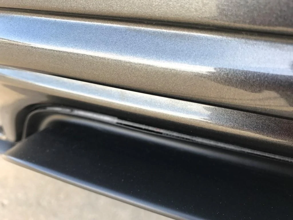

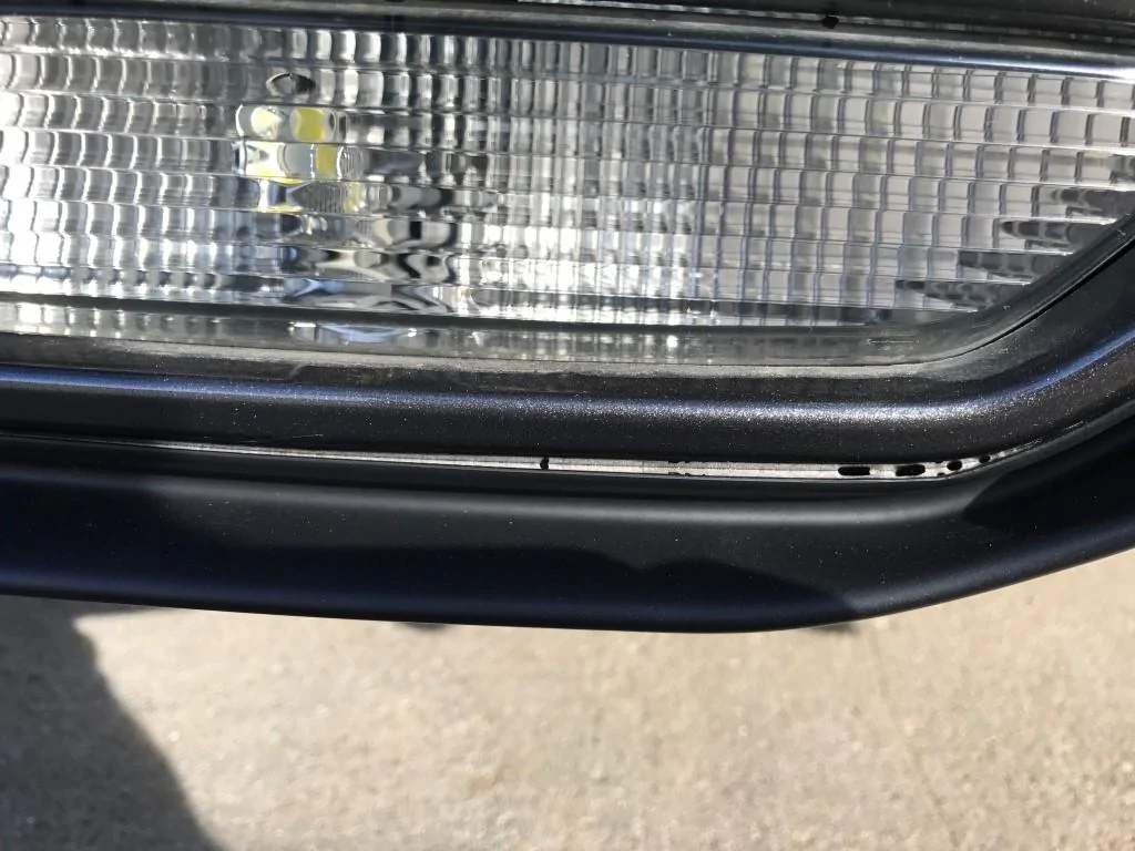

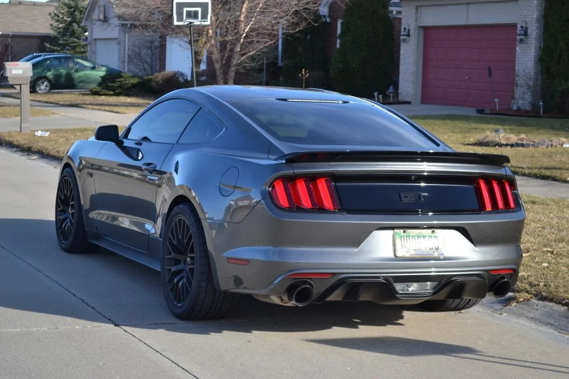

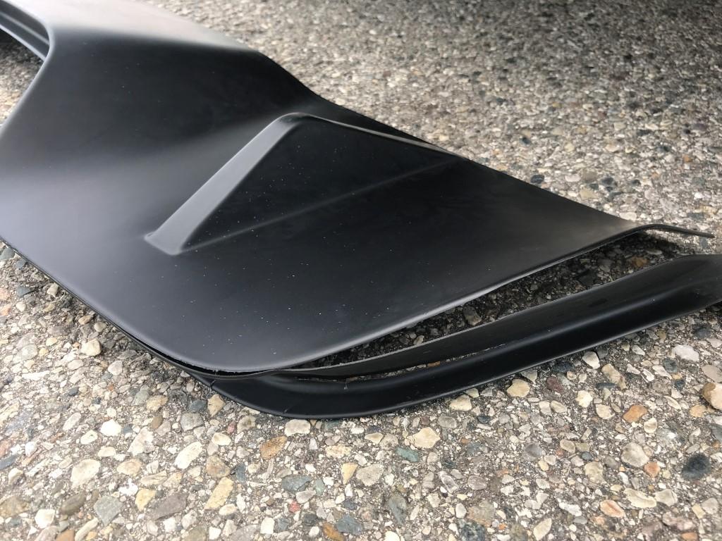

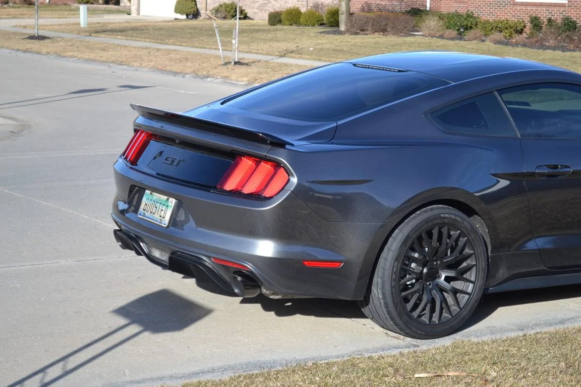

With the crazy warm weather here in Michigan this weekend I pulled the car out from under the cover and pulled it outside to get a look at how things have been holding up.
I installed the updated version of this unit back in Nov in a climate controlled garage where the temp is a constant 60-65 degrees. The fit and finish is extremely poor and looks like A$$ on my car. You can see where it pulls away and you see the grey 3M tape. Even with a grey car you can still see the tape. This thing is an eye soar. Totally disappointed with this purchase. I fear removing the diffuser to try new tape will damage it since its so thin and poorly made.

what a poorly designed diffuser , with the bad grey tape, the stupid gap underneath catching air , MMD messed this up. it do not look horrible, but a little plain. I wouldn't put this on my car. I'm going to paint the lower half of the stock bumper black , a lot of mustang owners are doing , and look really good. never mind this aftermarket junk

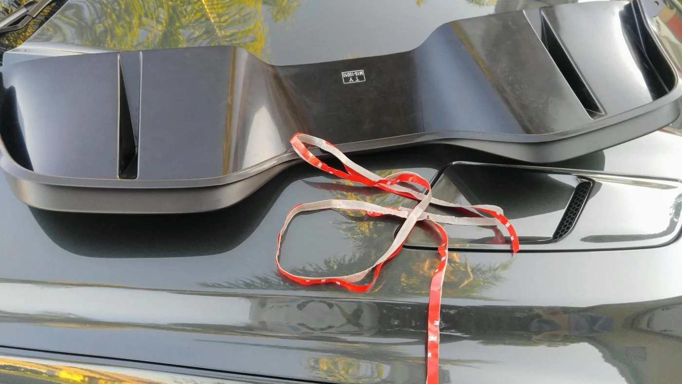

I got mine with the tape falling off. It literally peeled off the diffuser as I peeled off the backing. Obviously got rid of this junk tape.
I used VHB tape and the usual adhesive promoter combo.
That diffuser is not going anywhere without taking the bumper with it.
Also be careful cause VHB tape is a days work to take off if you choose to take it off.

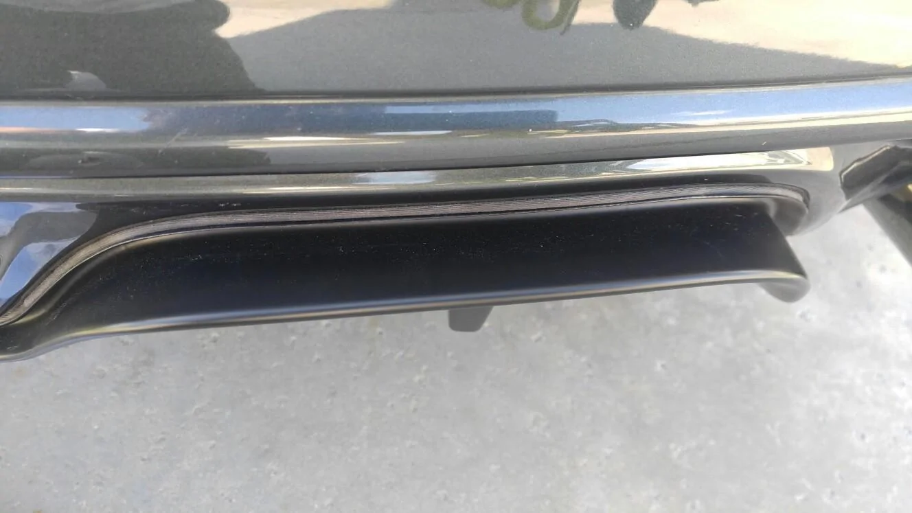

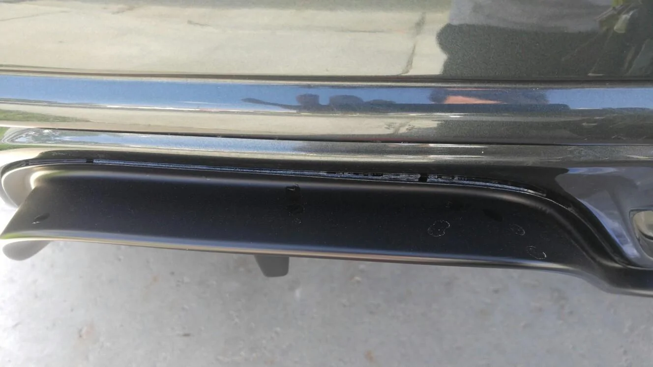

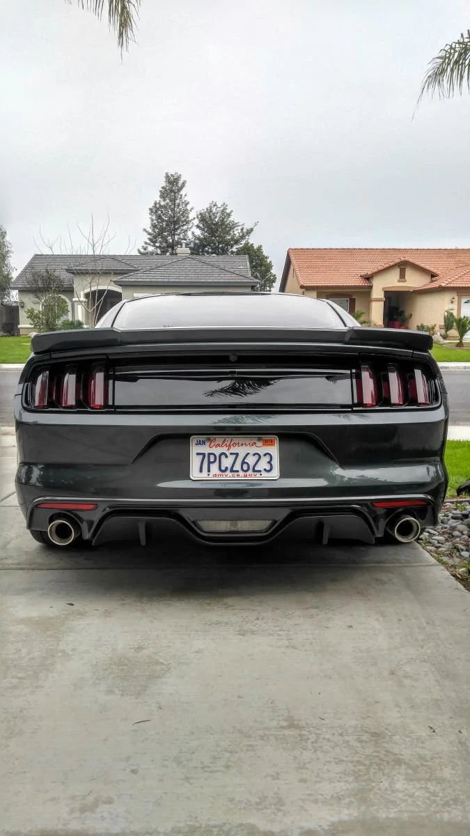

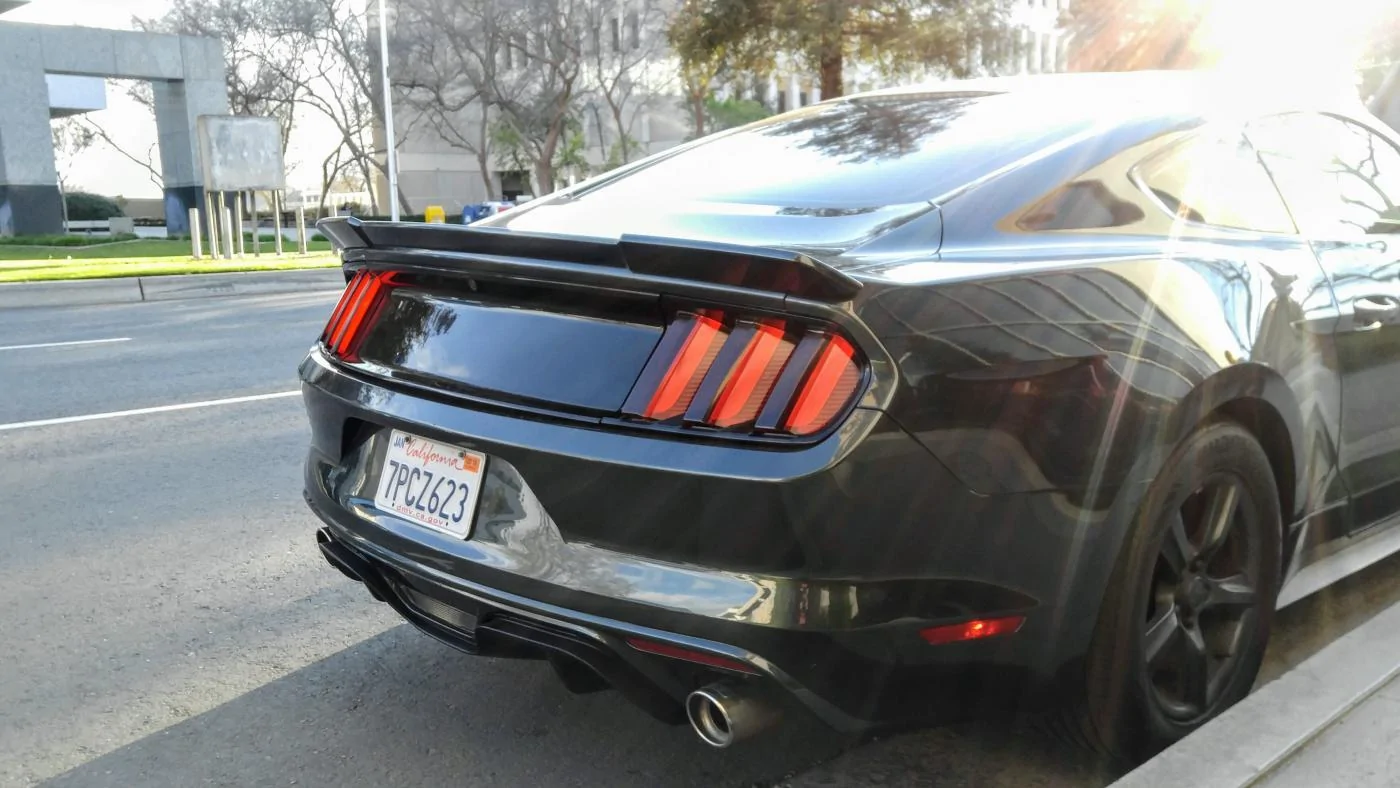

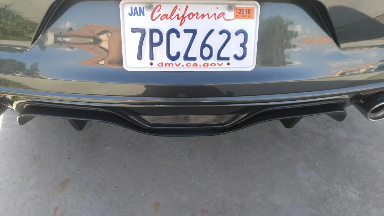

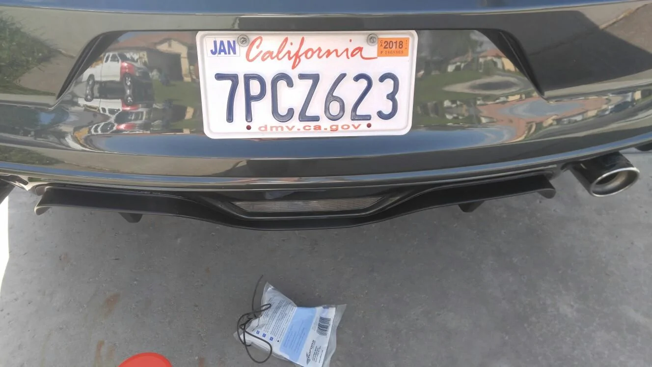

So i let the tape weather. Its been raining here alot.
But this is what i did to the seams to make them waterproof and look better.
I used window screen spline.
How it looks just the tape Without the spline .
Half and half
Full spline

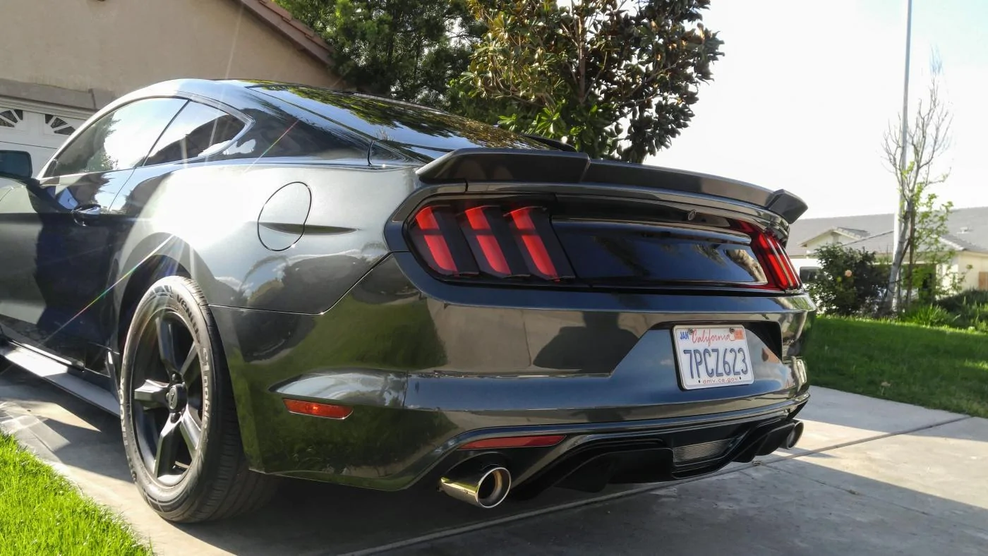

Bonus shot

[MENTION=23457]chaospiece[/MENTION] that is a great idea. Will be pulling my car out of storage in the next week or so and will most likely be doing this mod :thumbsup:

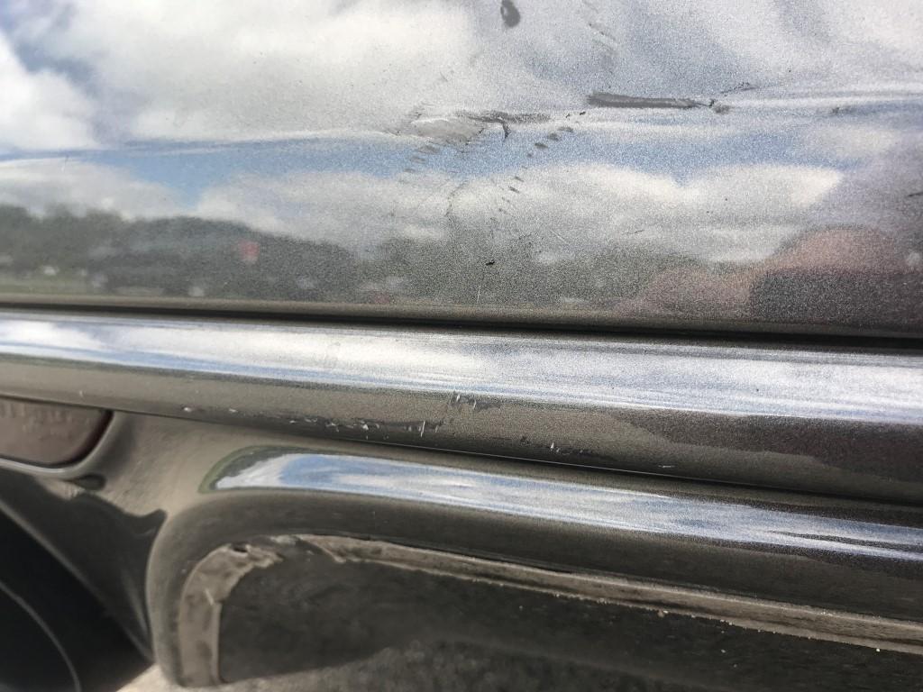

Made a few passes at the drag strip tonight and my rear diffuser is now junk. My rear bumper was also severally scratched and damaged in the process of it coming off the car. JUNK!

MMD is giving me a store credit. Better than nothing. Looks like I will attempt the Roush valance mod this time around.
