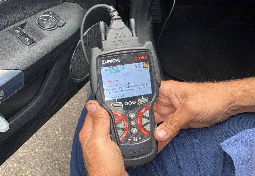

Went to mechanic. Hooked up scanner #1 (Zurich ZR15S)
I took a picture of the code: P0304 (meaning cylinder misfire in 4th cylinder) to look up later even though mechanic told me not to worry about it.
I looked it up and seemed like it was potentially pretty dangerous
Did some research on ford forums and found discussions about people having had a similar error code (as well as other P03 codes for other cylinder misfires) specifically following clutch and flywheel replacement. These forums mentioned crank relearn and misfire monitor neutral profile correction as potential solution.

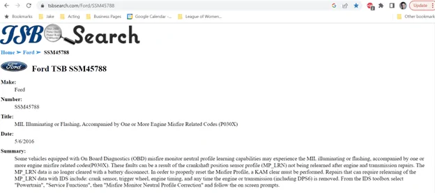

See official ford technical service bulletin (TSB) outlining the problem:
Had car towed to shop just to be safe since I’d experienced an actual engine misfire the nigh before
He hooked up the Snap On scanner above and when I got there, he said he thinks I might be right. Cleared the check engine light, then ran the profile correction.

Turns out then whenever transmission is removed from engine, the computers inside the car need to be recalibrated.
See 2:06 for what it looks like when your transmission Is separated from the engine to access the clutch and flywheel for replacement:
Bottom line: super easy fix, just have to know about the “misfire monitor neutral profile correction” process and send them this doc/insist that your mechanic hook his scanner up and run it, even if he’s understandably skeptical because he’s never heard of it.
