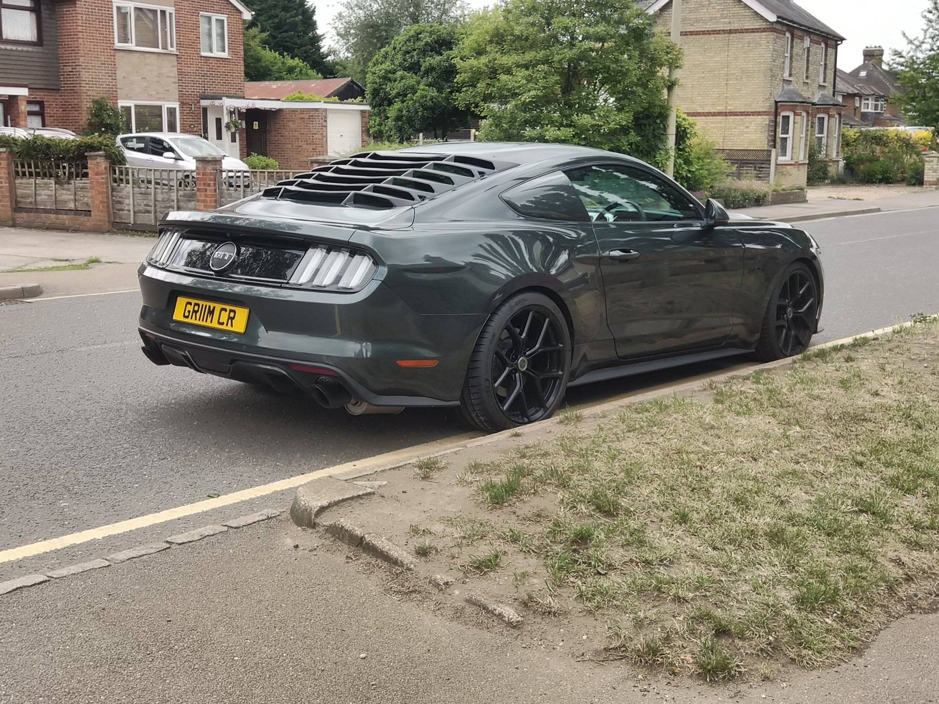

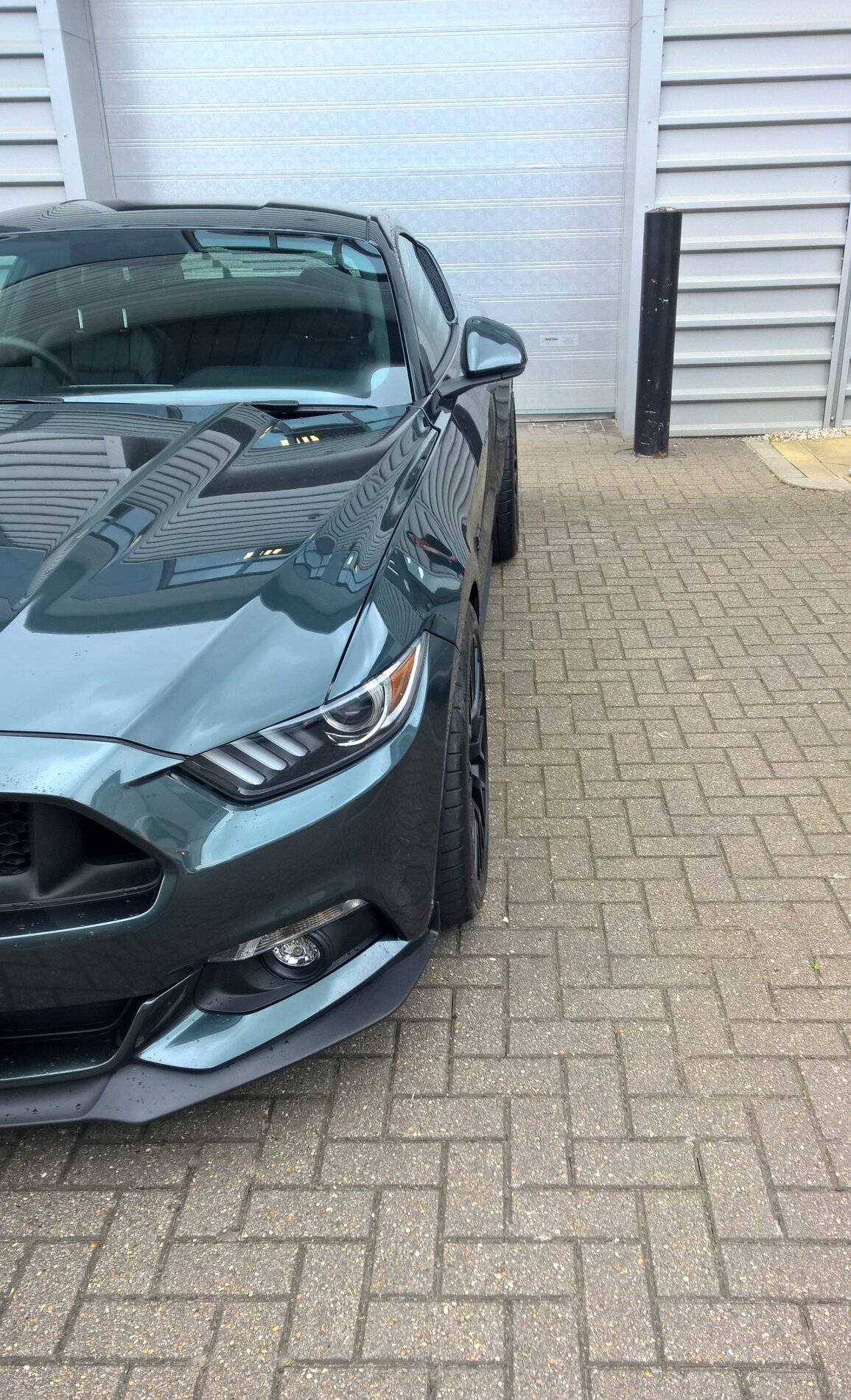

You don't need to cut the studs, I was running 25mm front and rear with a 1 inch drop in suspension height on stock wheels and never had an issue with clearance.

or get bigger wheels, I removed the spacers once I went 20" 😁

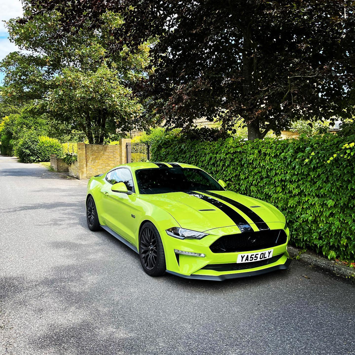

I have 18mm spacers on the front of mine. I actually have a pair of 18mm and 25mm that I will be looking to put on Ebay in the next day or two separately FYI...
