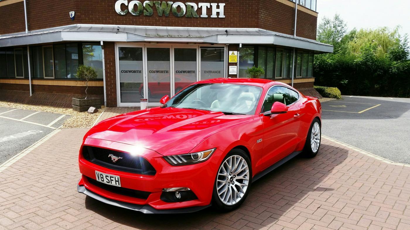

That's a good point, Mike at Modurstang did the work, and I'm not too sure whether the studs were modified or the wheels, he's got the same setup on his own car.But its the stock studs poking through the spacers and hitting the back of the wheel that's the problem is it not?
Your car look great btw
