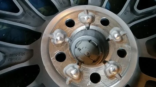

Thought this might be of interest
20mm Spacer on the rear of a GT hits the back of the wheel like so
IMG_20170122_154254 by lbvsvt, on Flickr

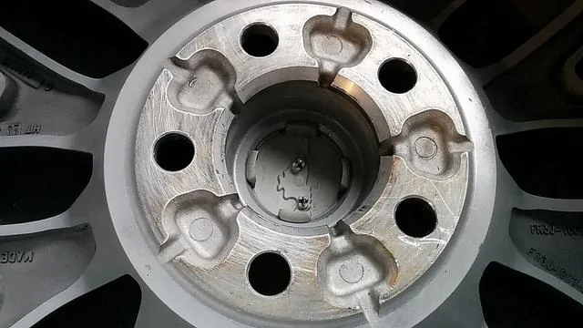

This guy (and someone else mentioned here) drilled the bits that were touching
IMG_20170122_155048 by lbvsvt, on Flickr
tempted to go down this route instead of sourcing 23mm

Apparently 23mm can touch as well. Mine seem fine and most (if not all) of the US guys involved in the group buy were fine also, but (I think it was) Ian_whu said his touched the back of the wheel pockets.
ughhhh :)
i'm trying everything in my power to avoid putting these 15mm's on the back but everything i read sounds like just as much of a pain in the ass unless i just get 25mm

I would drill or shorten the studs in order to get the bigger spacers, but that's just personal choice.

That's exactly what I did
seems like slightly less hassle than removing the brake caliper, brake disc, splash shield and smacking the bolts out...
you did that on a EU GT with 20mm spacers?
