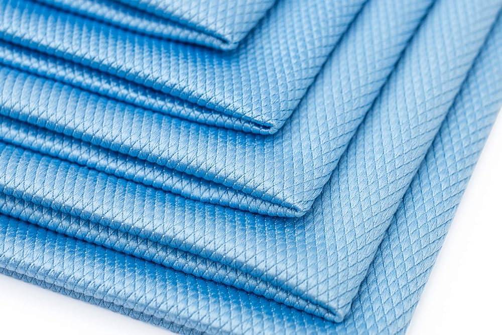

Diamond Weave –
Specifically designed for glass, a diamond pattern towel mimics a waffle weave in having reduced surface area for a smoother, less grabby feel.
Pro’s – Reduced drag and easier wiping across glass. They can also be great on polished metals. Low/no linting.
Con’s – Limited use, lack of versatility.

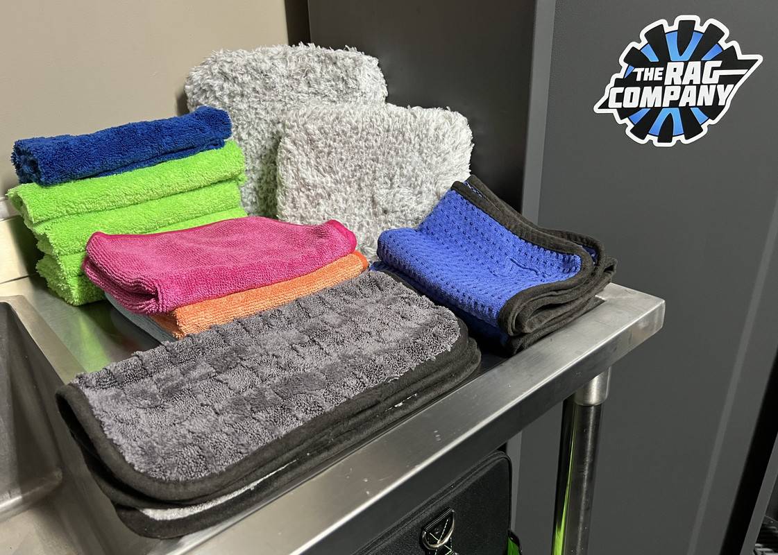

Pairing Towels to Specific Tasks
It’s taken me years to arrive at the following list. It’s worth noting that towels can be very subjective and personal, so use this listing as guide to get you started or what to look for.
Most of my towels are from The Rag Company (TRC), with a couple from Microfiber Madness. You will notice some duplication here, with colour used to differentiate towels into usages. Where I have specified a colour, this has been done to provide differentiation where the same towel serves dual roles. I probably have a lot of unnecessary categories here, so pick and choose those that are relevant to your needs.

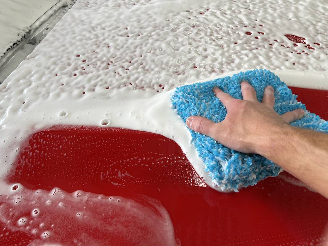

Wash Media (Mitts, Pads) –
Personally, I hate wash mitts and much prefer a wash pad, but I know that is subjective. After trying many different formats and brands, these are what I have settled on –
DFB’ Pick – TRC Cyclone Ultra
Any of the TRC wash mitts and pads are great, but the Ultra line is their softest and safest of the bunch. These are available in four different formats; mini-mitt (wheels), regular mitt, regular pad and the 10x extra-large pad. Personally, I use the regular size pad on passenger vehicles, the 10x for larger SUV’s and pickups. The wheel mitt is excellent too.
DFB’s Wildcard – Microfiber Madness Deli-Pad/Mitt
Available in mitt or pad, this is an excellent option for softer, more delicate paint. The Deli-Pad and Mitt are thinner than expected, but much plusher and softer feeling.
DFB’s Suggested Quantity – At least one per vehicle.

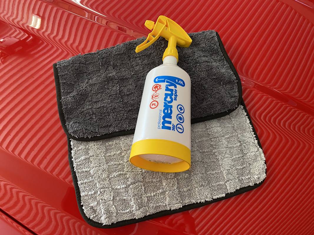

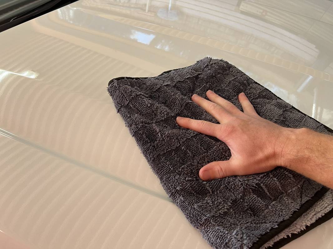

Drying Towels (Large) –
This is probably one of the most subjective towel categories. Some prefer the lack of bulk and extreme absorbency of a twist-loop, some like that ultra soft padded feel of a plush towel, some favour the smoothness of a waffle weave. For me, the ideal drying towel combines all of those attributes.
DFB’s Pick – TRC Gauntlet
Available in several sizes, I prefer the medium as it’s more than big enough for most vehicles without becoming a bulky pain in the neck. I like these towels because they combine the absorbance of a twist-loop towel, but the softness and smoothness across the paint of waffle weave and plush towels. 700 GSM and a 70/30 blend made in Korea.
DFB’s Wildcard – Waxit Tempest or Microfiber Madness Dry Me Crazy
Considering my dislike of twist-loop, it was hard to make a suggestion here. Prior to the Gauntlet, I was using something like the NV Tempest or Microfiber Madness Dry Me Crazy. These are ultra plush 1000 - 1200 GSM towels that are thicker than most modern towels, but the feel of plushness gives an impression of safeness.

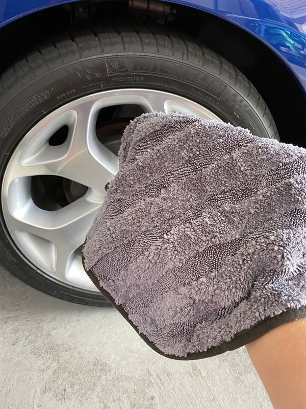

Wheel Towel -
Probably a useless addition, especially if you are blow drying, but I still like to give wheels a final wipe down after dressing the tyres. Because of the closeness to the floor, I think you need a smaller than average towel to avoid dragging it across the ground.
DFB’s Pick – TRC Gauntlet (30cm x 30cm)
I know this is probably too nice of a towel to subject to this task, but me, this is one of those towels that suits its job so well. It’s perfectly sized and perfectly weighted to work between the wheel spokes without excessive bulk or change of dragging on the ground or on the tyre. One of my favorite towels.
DFB’s Wildcard – TRC Creature Edgeless (Black)
This is a hard choice because of how transcendent the Gauntlet is at this task. I settled on the Creature because of its 420 GSM, dual-pile versatility, size and relative cost effectiveness. You could also do the Spectrum, which is a edged version of the Creature, but the edgeless is easier to manage.
DFB’s Suggested Quantity – At least 2, or 2 per vehicle.

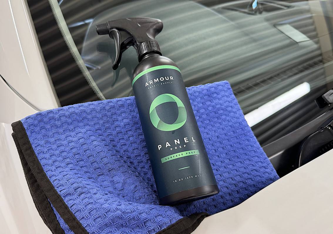

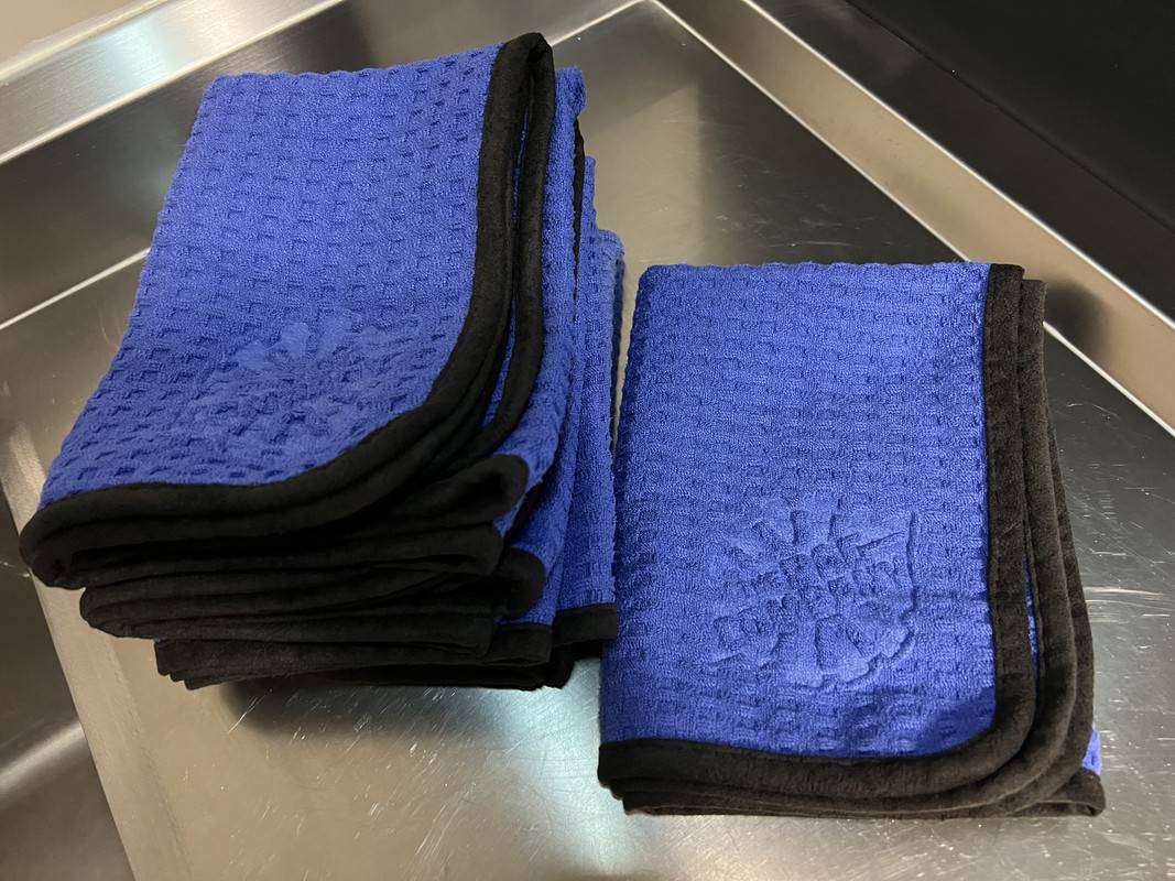

Glass Towels –
For glass, you need a dense, low pile towel to limit streaking and linting. There are a variety of glass-specific towels, but I’ve settled on waffle weave.
DFB’s Pick – TRC Dry Me A River
TRC make a variety of waffle weave towels, but their premium DMAR is the best for glass. In particular, you want the 16x24 version. I’ve found these to be the smoothest and easiest towel to clean glass.
DFB’s Wildcard – TRC FTW
While I listed this towel as a drying aid towel, it was originally designed for glass, FTW means “for the windows” or “for the win”. The lower pile and high density makes them a great choice for glass.
DFB’s Suggested Quantity – At least 4, two per vehicle. If you have really nasty interior glass, you will burn through more towels as each becomes loaded with grime, so you may need up to 6.

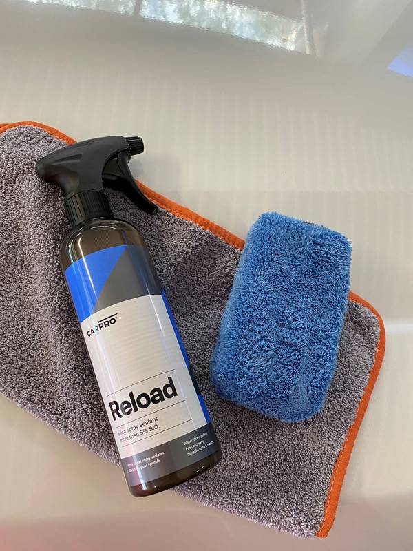

Coating Removal Towels –
This category is probably the most complex when it comes to choosing the right towel. As a rule of thumb, for coating removal you want a low pile and around 300 GSM to help cut through that initial residue and prevent pushing product around. When leveling, you use two towels, one for the initial wipe, a second for a final buff. To help with this, I like to have the same towel in two different colours, that way you easily remember which is which.
There are two ways to look at this. Considering these towels are best thrown into the rag pile after use, the dried coating will ruin your hard work in seconds if used on paint again, investing in expensive towels here is a fool’s game. On the other hand, using a cheap towel could compromise the finish you have spent hours perfecting. Which route you chose would depend on the paint you are dealing with. For soft Japanese paint, I would spend the extra on a pearl weave towel. For medium to hard paints, wheels, glass and trim, a cheaper terry weave towel will be just fine.
DFB’s Pick (Soft Paint) – TRC Edgeless Pearl
These are a 320-gsm pearl weave towel that are extremely efficient at coating removal. They are also available in grey, orange and green to help you colour-code their first/second wipe statis.
DFB’s Pick (Medium-Hard Paint) – TRC Edgeless 300
As the name suggests, this is a 300 GSM towel that balances a cost vs performance equation. These can be had for about $3.00 each compared to the $5.50 for the Edgeless Pearl.
DFB’s Wildcard – TRC Ultra Rip’n’Rag XL
These towels come in a roll of 50 for $99.95, which works out to be just on $2.00 a towel. That low cost doesn’t mean low quality because these are a pearl weave towel with 280 GSM and a 70/30 blend. In actual fact, this is probably the best balance between the two towels above.
DFB’s Suggested Quantity – At least 4 to 6 per vehicle depending on the coating and surface area treated. I would order a 10 or 12 pack of the Edgeless 300 or Edgeless Pearl for bulk price rates.

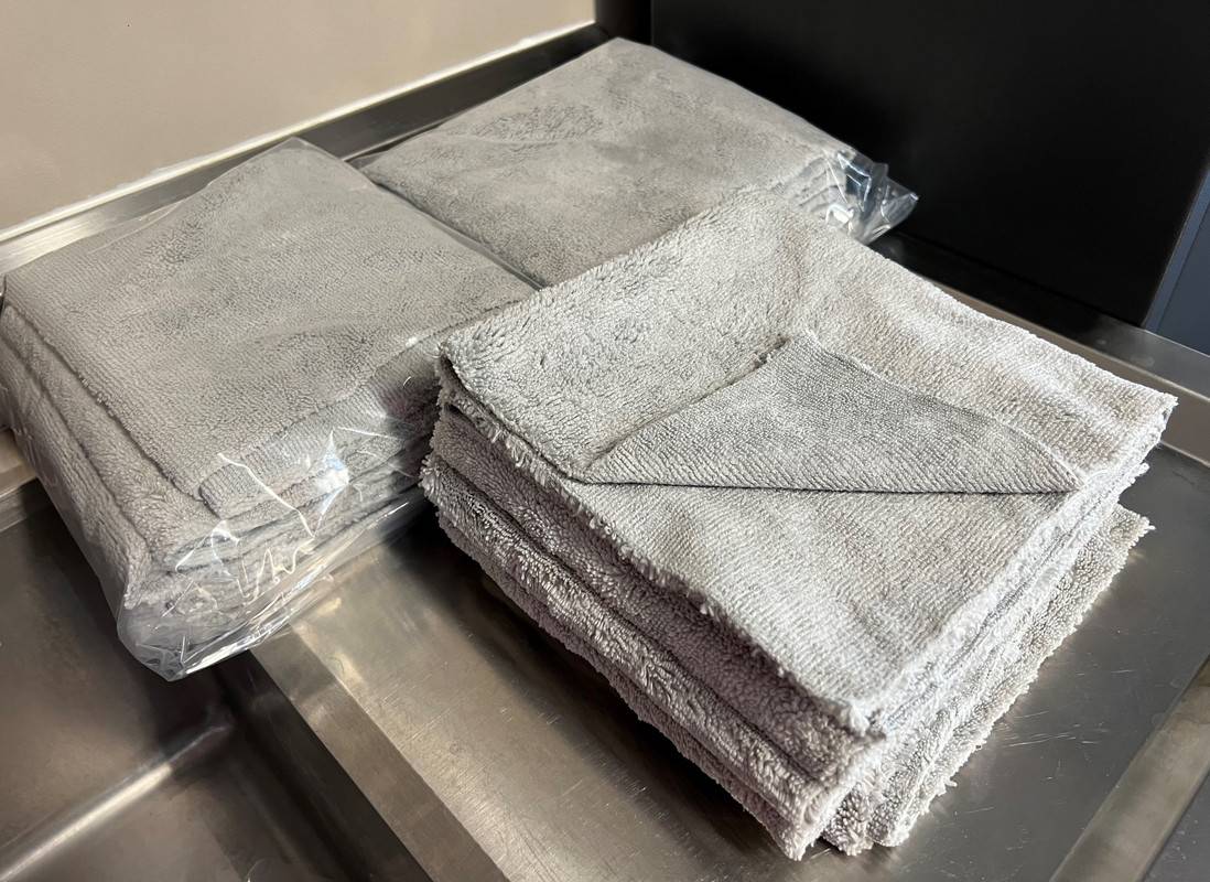

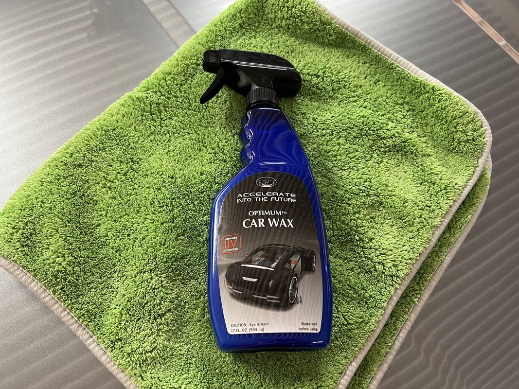

Wax/Sealant/Polish Removal Towels –
It took me a long time to figure this one out, but for polish and wax removal, a low pile towel is much more effective here. That can be hard deal with if you have soft paint, so my choices below mimic the coating removal category. Having sufficient quantity of these towels is important, a fresh, clean towel will be more efficient, so this allows you to swap them out more often.
DFB’s Pick (Medium-Hard Paint) – TRC Edgeless 365
As the name suggests, this is a 365 GSM, 70/30 blend towel. These terry-weave towels deliver a nice balance between a low pile without sacrificing quality.
DFB’s Pick (Soft Paint) – TRC Eagle Edgeless 350
Despite the lower 350 GSM rating, this plush towel is better suited to soft paint. The Eagle 350 is better suited to polish removal than the thicker Eagle Edgeless 500.
DFB’s Wildcard – TRC Creature Edgeless (Grey)
As a dual-pile towel, the Creature is basically two towels in one. In theory, having a set of these would negate the need for two separate towels to cater for soft and hard paint. At 420 GSM, they share the same 40cm x 40cm size of the two above.
DFB’s Suggested Quantity – At least 10, probably 15.

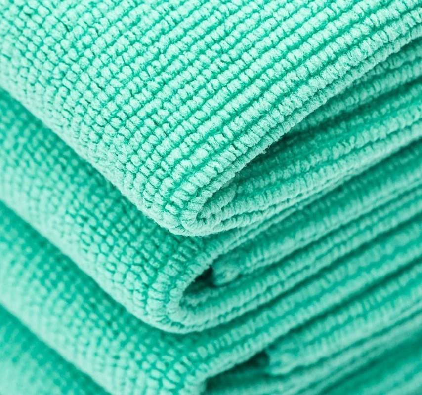

Interior Cleaning Towels –
In most cases, you want a lower pile terry-weave towel for interior cleaning purposes as they will better deal with cutting through grime. I also think you want a slightly larger rectangular towel here, especially when cleaning larger areas such as leather.
DFB’s Pick – TRC Car Wash Towel (Green)
These 80/20 320 GSM towels have been my go-to interiors for years now, they are perfectly sized at 41cm x 69cm and are also extremely durable. I’m using these to clean leather and plastics, wipe screens and instrument clusters, cleaning fabric and general wipe downs/dusting. Cost effective too.
DFB’s Wildcard – TRC Creature Edgeless (Green)
Another appearance of this towel, the plusher pile and higher 420 GSM makes it better suited for delicate surfaces such as piano-black gloss trims.
DFB’s Suggested Quantity – At least 10.

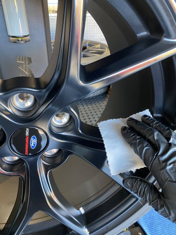

Applicators -
Available in multiple sizes and shapes, applicators are used for tyre dressing, polishing, waxing, trim dressing, glass cleaning, leather care and interior dressing. For the most part, these are pretty universal, at the moment I have been using TRC Pearl Applicators, and the Eagle Applicators are great for delicate surfaces.

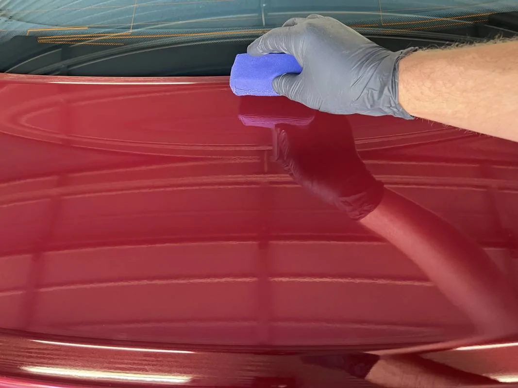

Ceramic Coating Applicators -
Another subjective category. The original block and suede method is still favored by some, but most use microfiber applicator bricks, me included. Having said that, having some of the suedes on hand can come in handy for intricate areas.
