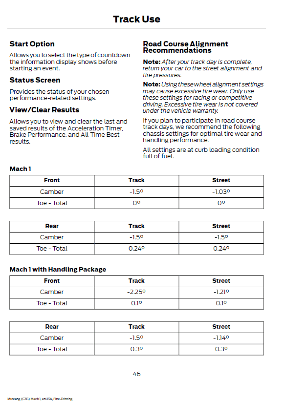

Do you know if the HP alignment spec are the same as the regular mustang specs?
Charlemagne
Jan 14, 2021
1,974
3,483
Czech Republic (Europe)
Nick
They are not, they differ in both street and track recommendations. See the Mach 1 supplement manual.
