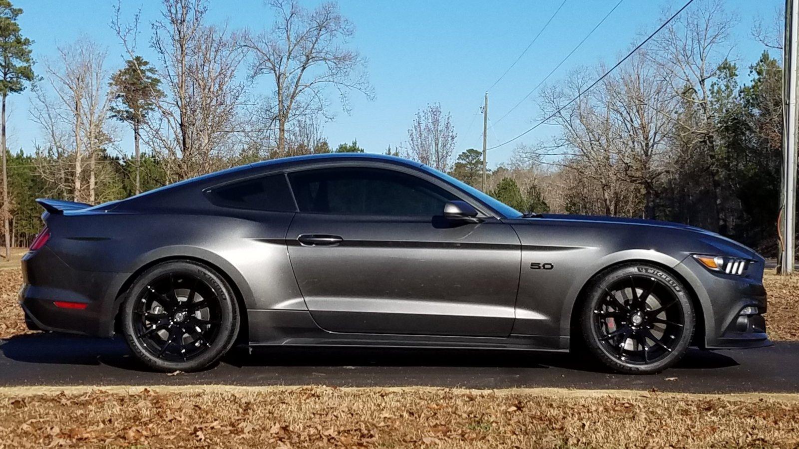

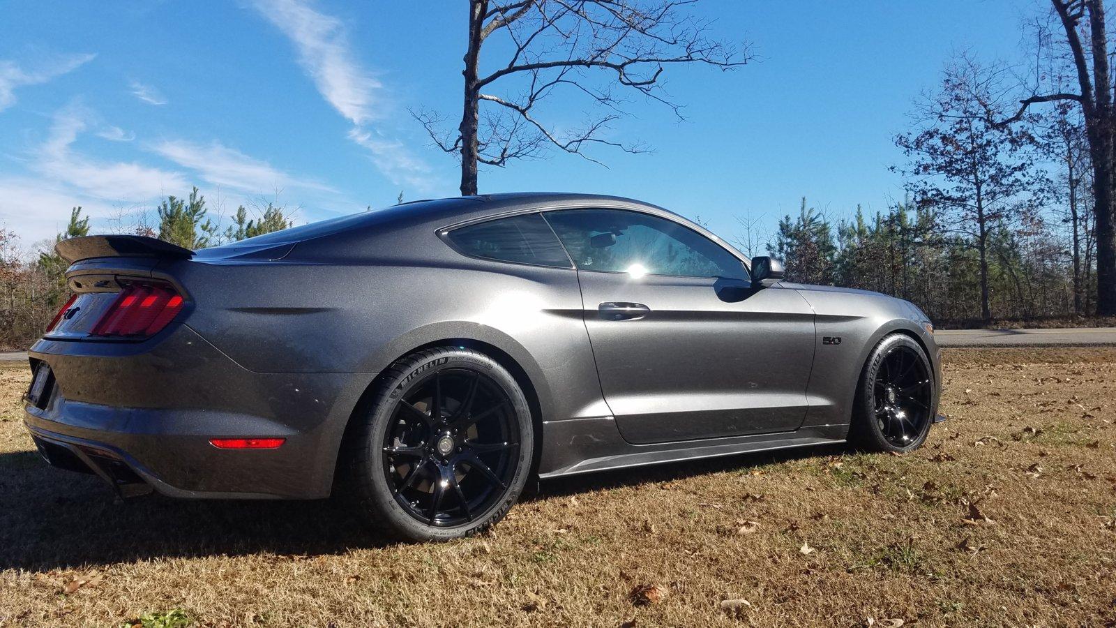

I have a 2017 Gt PP. I recently got new wheels and tires to replace my PP wheels. Here is a pic of my new setup.

What are you lowered on if you dont mind me asking

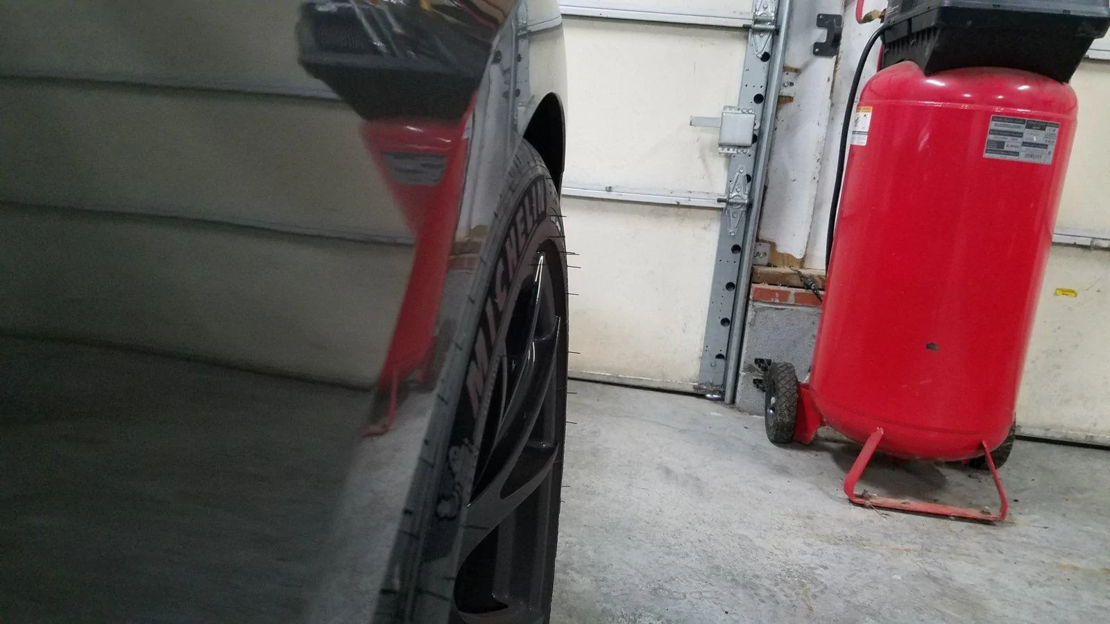

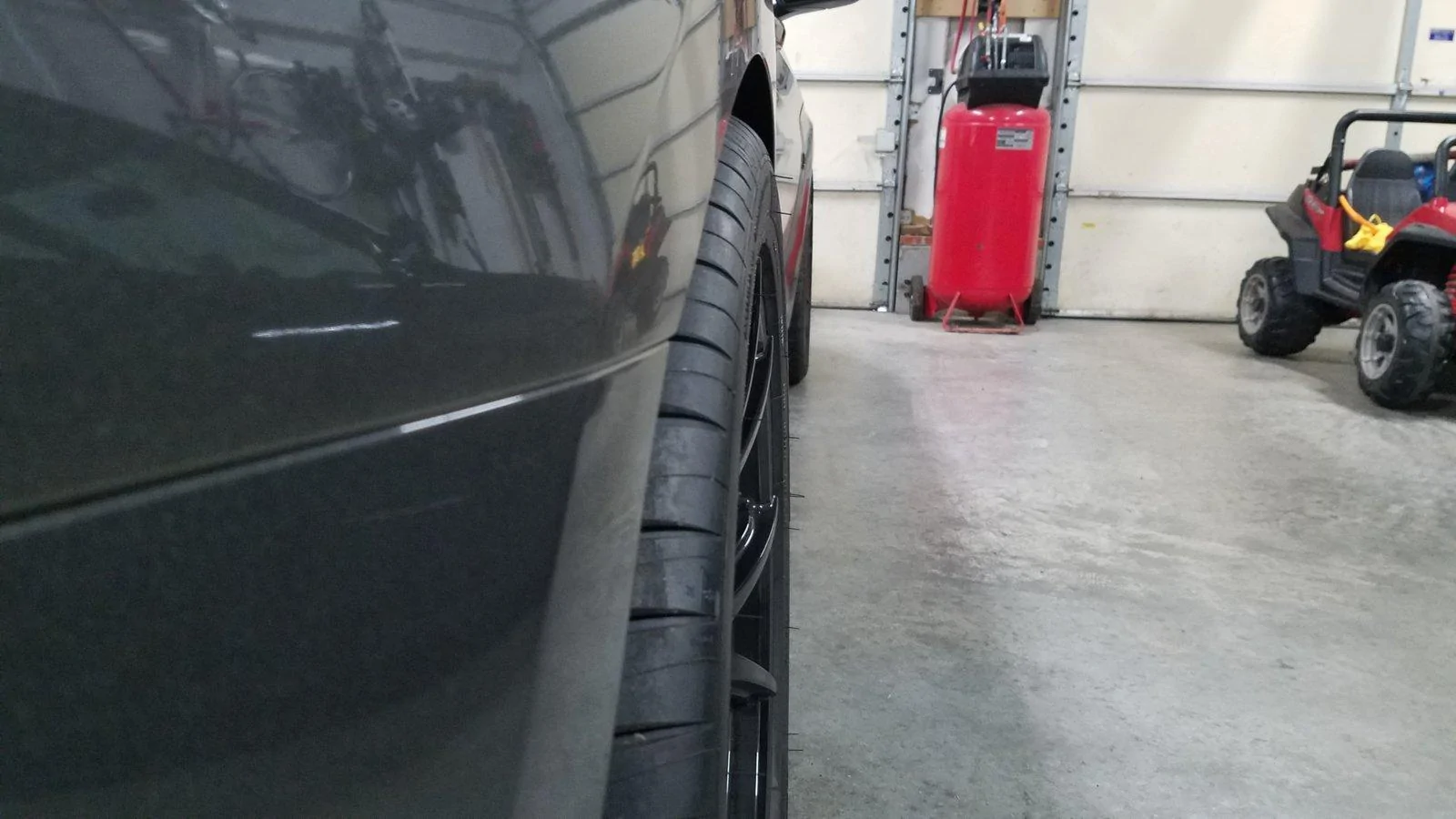

305/35r19 will have more sidewall compared 325/30. In my opinion more sidewall on the rears looks better as apposed to a more low profile look on the s550 that is.
The 305 should also have a very slight stretch on an 11" wheel just like my 285/35 have on a 10". The 325 on an 11" have a very slight bulg. Not noticable from a slight distance and also have kinda of a square sidewall. So aesthetically the 305/35 to me would look better and would match the look of my front tires.
Although Michelin states the 325 can safely be mounted on min. 11" wheel I feel they would be better fitted on a 12" maybe even a 11.5.
Also it has been said the that a tire with a slight stretch will perform better with less roll.
Here are a couple comparison pics.
