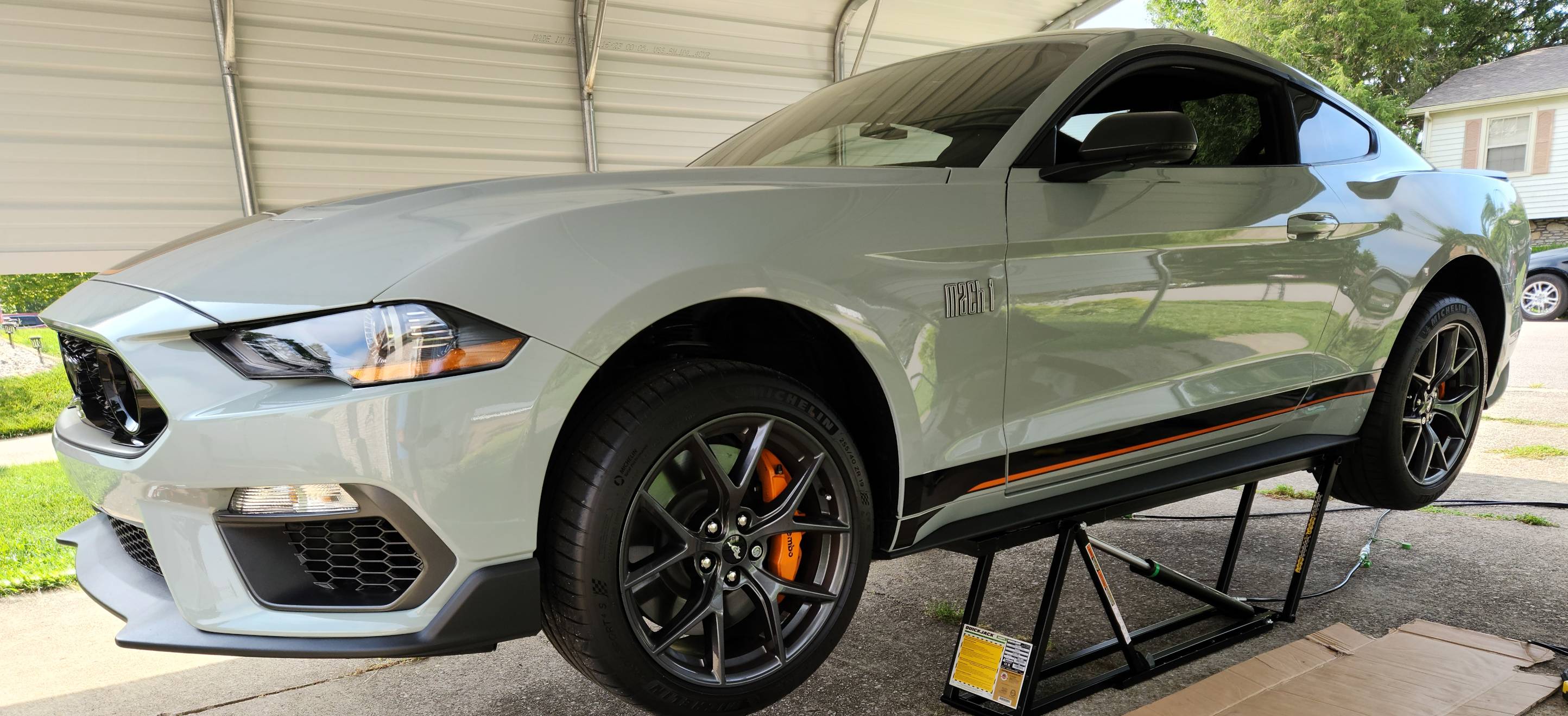

You will need a lot of room under the car, if you don't have that you will have issues. I used a QuickJack and at times I was still wishing I had more room. Being able to stand under the car would have made this way easier.
