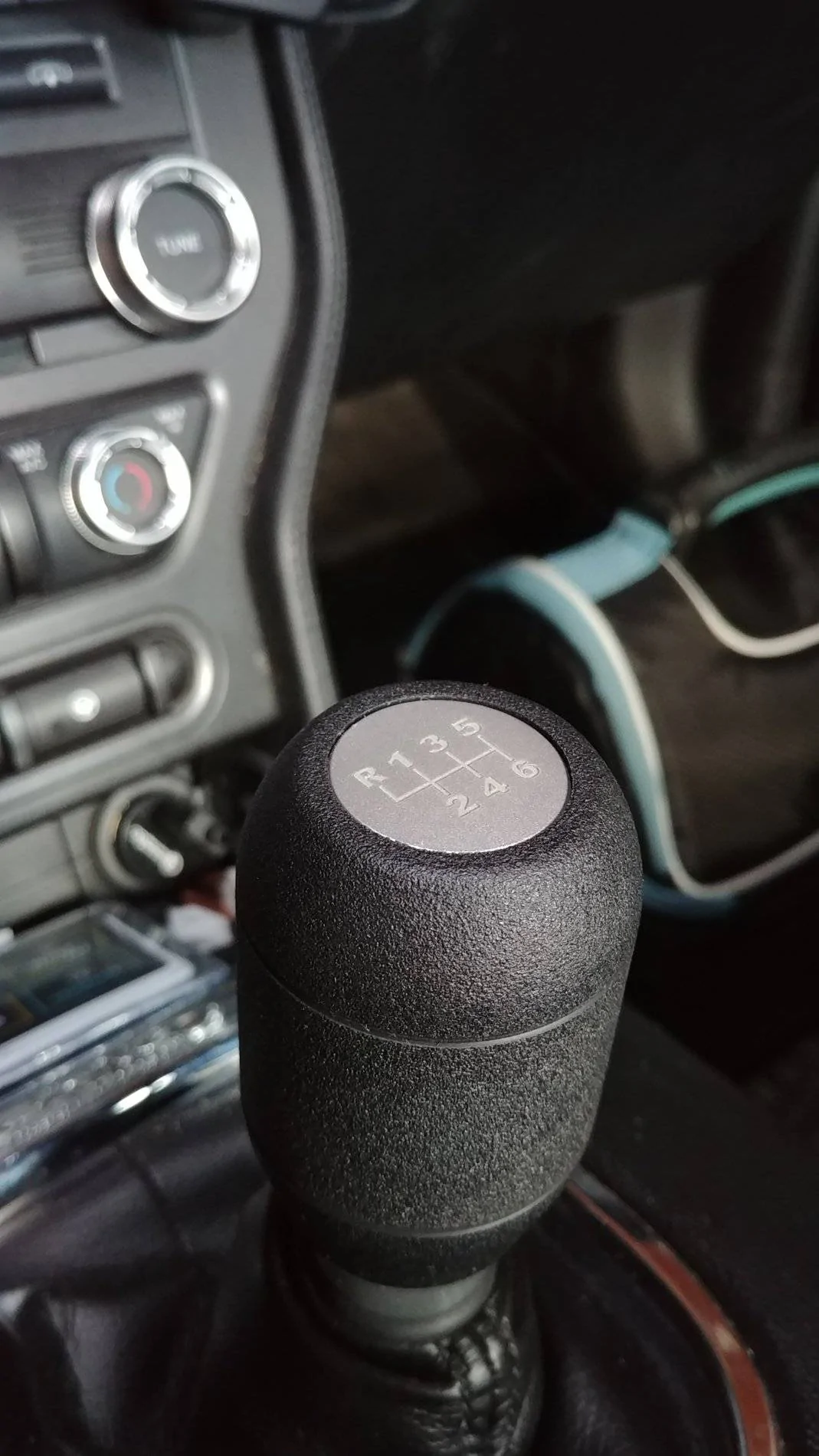

I had to spend some time adjusting mine to get the 1-2 just right, too. Once I did, fantastic. I'd highly recommend the MGW cylindrical gripper knob. View attachment 408317
