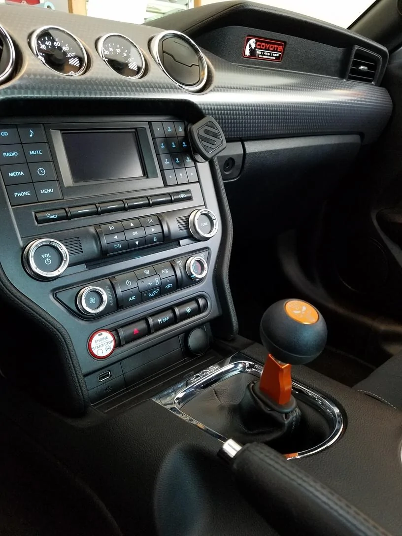

Had Evo Rob give me a hand with my install over the weekend. That bolt only fought us once. We backed the carrier bolts out about half and inch. Rob pulled down on the trans and I slid the bolt back in place with ease.
Putting the boot on the shifter was a tougher job! Probably more my fault for trying to use as little silicone spray as possible so it wouldn't make a mess.

[MENTION=8079]rj67[/MENTION] where did you get that coyote plaque on the dash? I'm pretty sure I need that.
rj67
Apr 18, 2014
370
260
Va. Beach
2015 GT/PP Competition Orange
Got it from The Anchor Room. I'm lucky enough to be local and was able to pick it up from them. Jason and Jenifer are great to work with.
