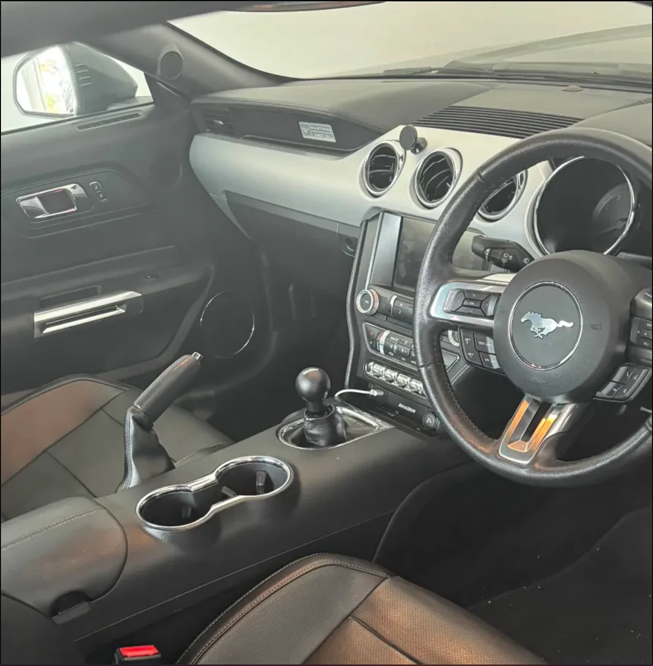

I got this done not long after my last reply. The trick for me was letting the dust boot soak in hot water for a good 20 minutes, made it a lot more pliable and easier to get into the groove on one side, then I slowly worked it around. But because I'm from Australia, the distributor I bought the MGW from did not mention that I needed either an adapter to keep the stock shift knob, or one of MGWs shift knobs, so rather than waiting on one getting shipped here from the US, or using the stock one but with a massive gap on the shifter, I ordered one from Temu for $10 and it surprisingly slotted in okay.
Thank god this is finally done. Lucky I had a second car to drive around while this was out of commission, otherwise I would've given in and just taken it to a shop much earlier.
Thanks for the tips along the way Mr.Sweet
Haven't driven it too much yet since the install but so far, definitely feels a lot notchier than the stock shifter. Throw is a little less but nothing too drastic. Doesn't sit too low either thankfully. Main thing I like is the 2-3 shift needing basically no guidance, makes it a lot faster. I can just bang it into 3rd by pushing up and not have to worry about a money shift
