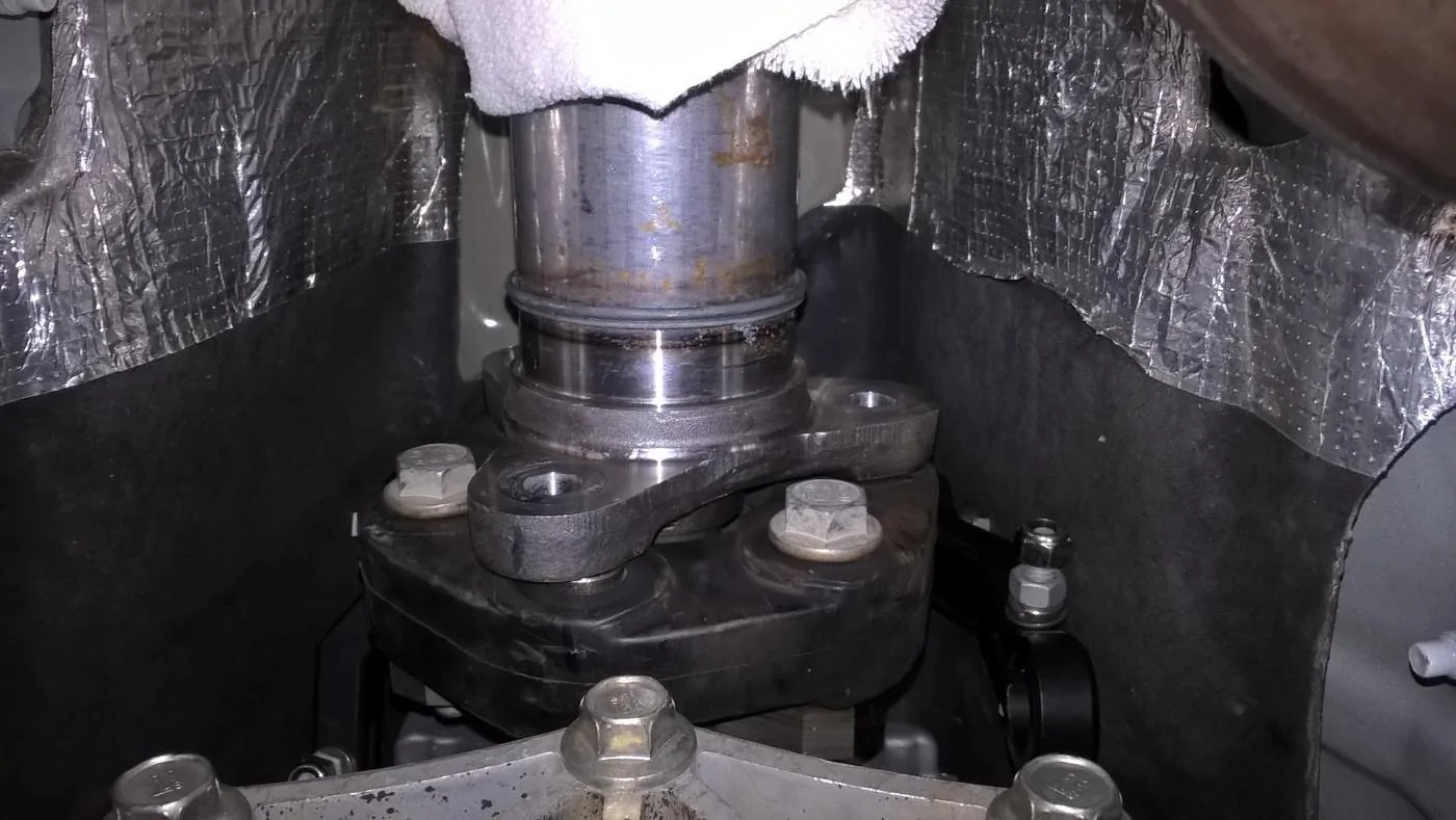

I unbolted the driveshaft. I guess I wrongly assumed the slip joint would let me pull the DS toward the rear of the car and drop it down. I can pull it back some but there is a lot of resistance and I don't see the slip joint move. So I stopped because the last thing I need now is to manage to drop the DS and not be able to get it back on.

After unbolting it, the plate the bolts go thru won't move back at all just from me pulling on it. I can put a pry bar between the part the bolts were removed from and the shock-absorbing (rubber like) piece it bolts to and they will separate a little but it feels like I'm just compressing some bushing somewhere. As I said, the slip joint doesn't slip at all while I'm doing this.
Maybe I could use the pry-bar to compress whatever it is enough to get the DS out of the trans but maybe not. I have no idea how much movement is needed. But if I do manage to force the DS back enough to pull it out of the trans, I could end up with a new problem similar to the one I already have, namely: can I force the DS back enough by myself to reinstall it?
But bottom line: I'm reluctant to force it anyway when it is SUPPOSED to just slip out with no forcing.
Probably useless but here is a pic of the DS where it was unbolted.
As I said, that slip joint does not move at all if I force the parts the bolts go thru apart.

Sounds good in theory and obviously works for some, but I don't want to force things with no understanding of why it just slips out in other cars.
Drop the carrier, then. It'll bend more than enough to come out and yes, you'll be able to put it back up yourself. It sucks that you had to take off so much to get this thing installed.
