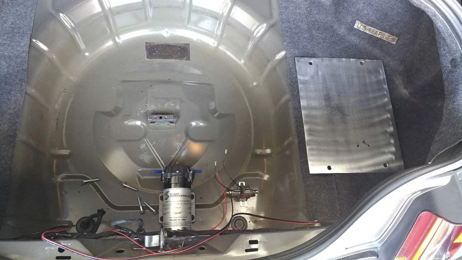

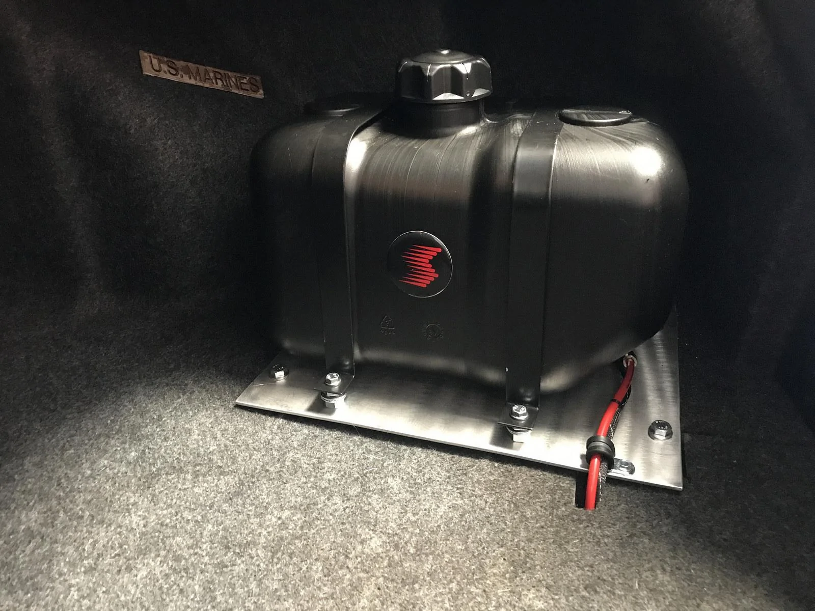

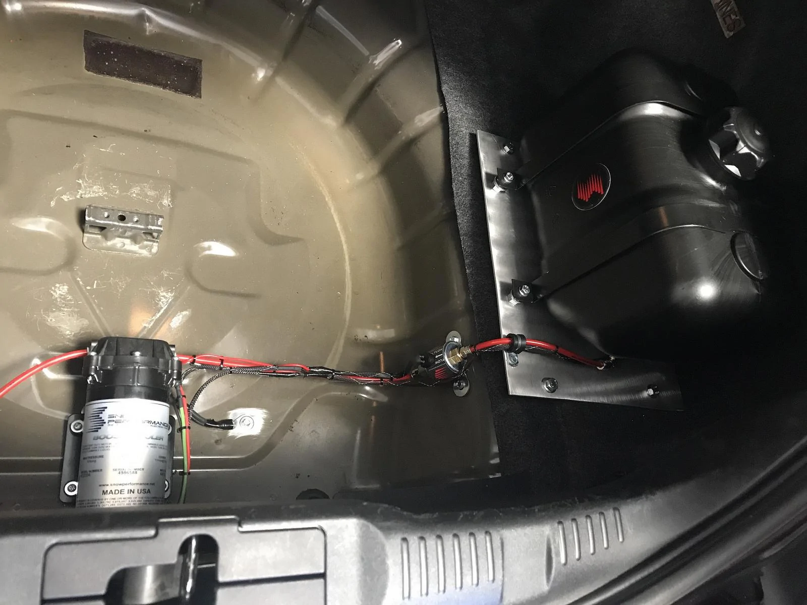

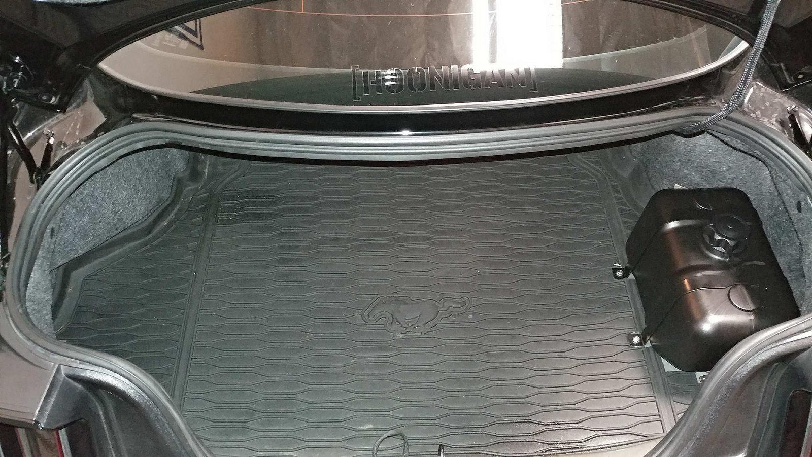

This week I purchased a Snow Performance Stage 2 Methanol injection kit and installed it on the car. I currently have their #5 325ml nozzle on it, due to a shipping error. I will be putting on the #6 625ml nozzle next week when it arrives and dropping down to a 3.5" pulley (currently running 3.625"). So far I am pretty stoked with the kit as when it sprays it is dropping my IAT's fairly quickly. Should see even better results once I have the bigger nozzle installed. It is a fairly straight forward installation and a really nice kit. bought VP M1 Methanol and mixed it 50/50 with distilled water since my Boost Juice from Snow did not arrive yet. The Boost Juice is pre-mixed 50/50. The car will going on the dyno on the 27th, so I will update when I have the results.

install looks clean bro! cant wait to see results for the 27th. torque will go up huge.

Good install but I always plumbed my meth after the TB.
Snow's instructions are to mount it either before or after. After the TB requires a solenoid upgrade.
