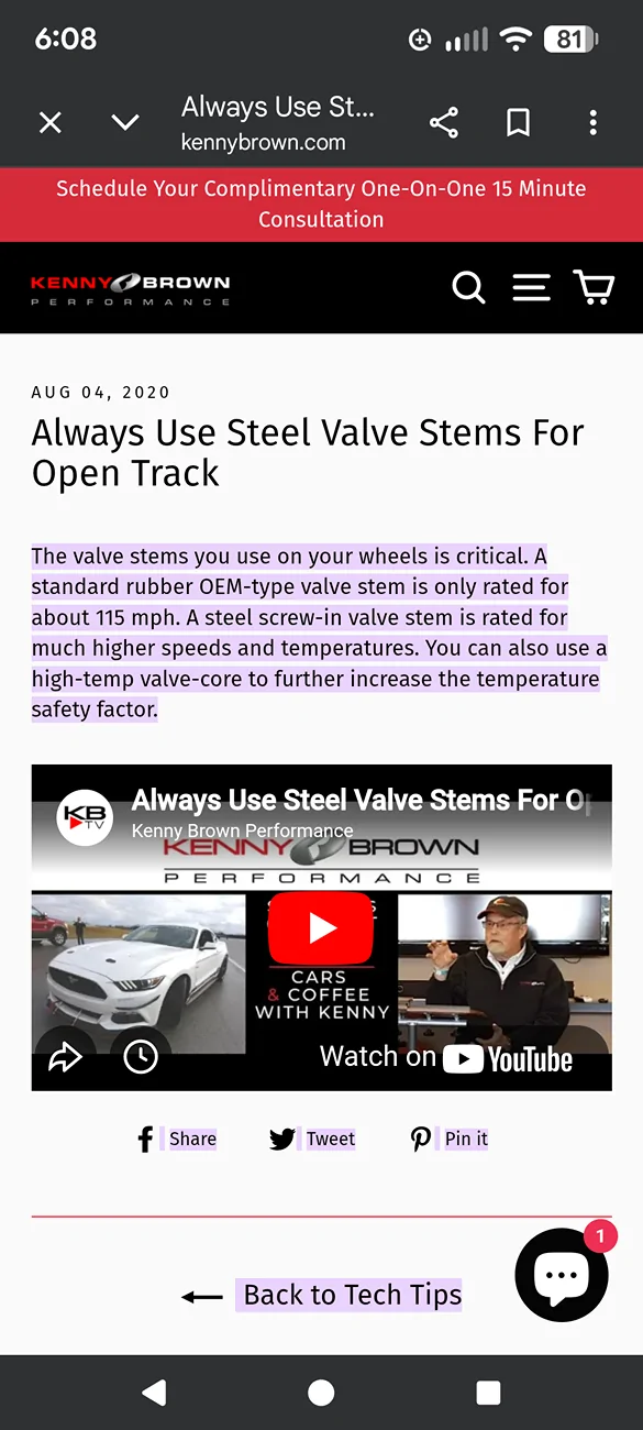

Understandable, but I believe they are only rated to 115 mph about's . What if you not in a wet salty environment?

You are wrong it is 130 mph but if that was real, ford mustangs would not install them on all their cars. You have never heard of rubber vale stem failure due to speed. Rubber stems are changed every time new tires are installed so they are not subjected to UV break down but metal stems don't get new rubber seal when tires are installed so the rubber seals get old and are more prone to dry rot and UV degradation.

You are wrong , I have metal and they replace when I purchase new tires , In between I've never had a valve stem leak . I was off 15 mph and why I said about's MO covered that 15 mph . 😁
I'll stick with metal on a Performance Car.
