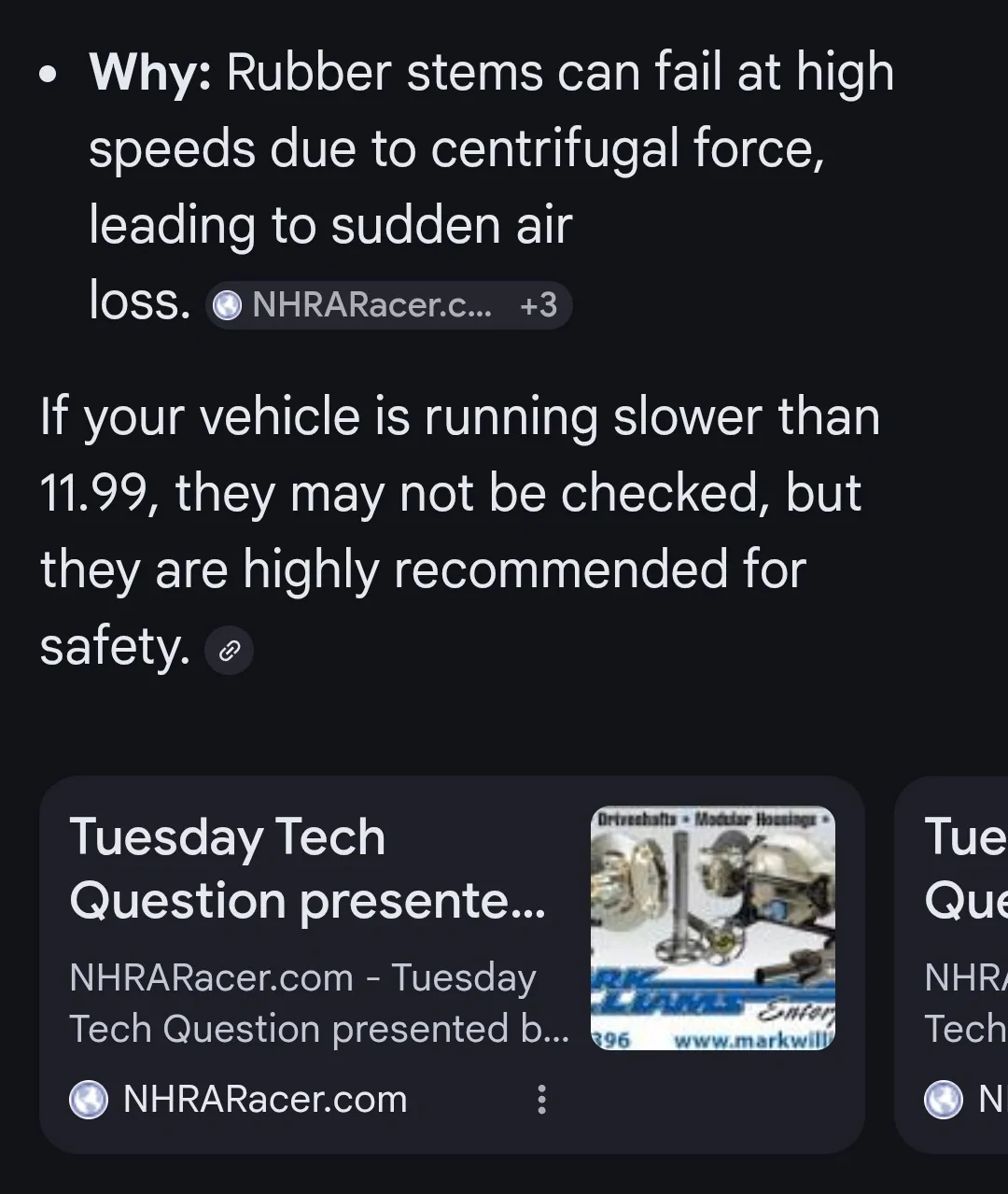

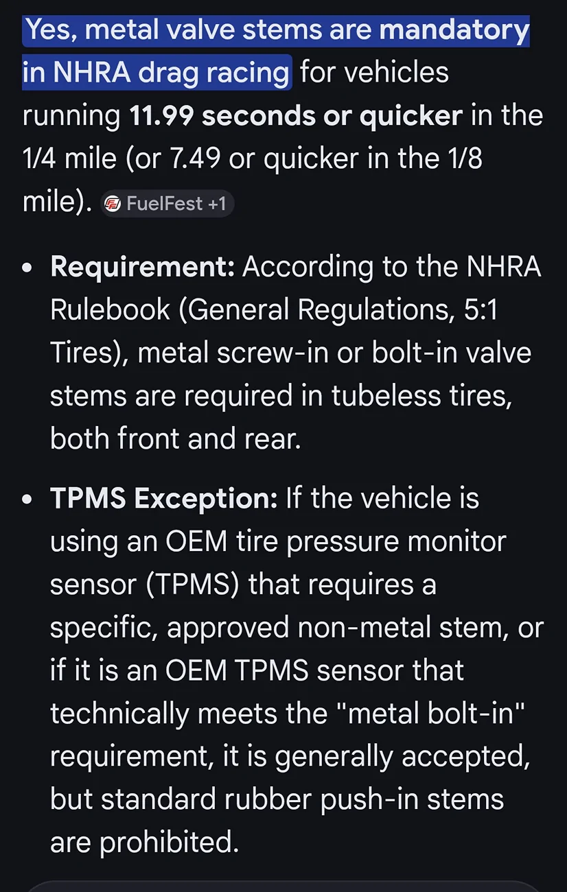

Check post #6 , Kenny Brown Utube, also I checked NHRA rules and NHRAracer and information below . I didn't check any other Racing Sanctioned Body .
Agreed they do look more Professional and must have a grater safety factor if Required by NHRA . There is exceptions for TPMS , read your sanctioning body rules.
I'm a Drag Racer part time now , after 25 plus years in the Sportman racing series.
