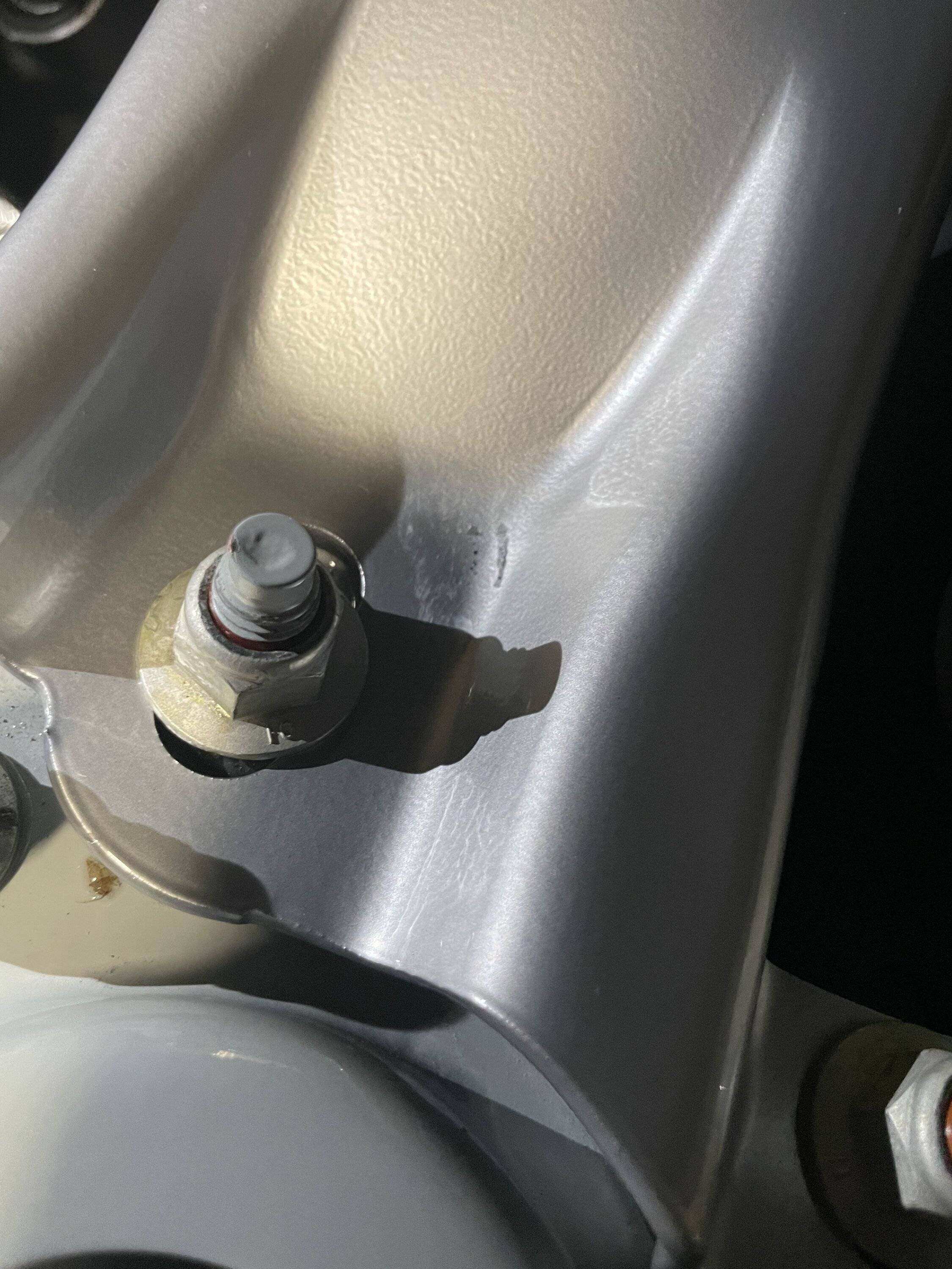

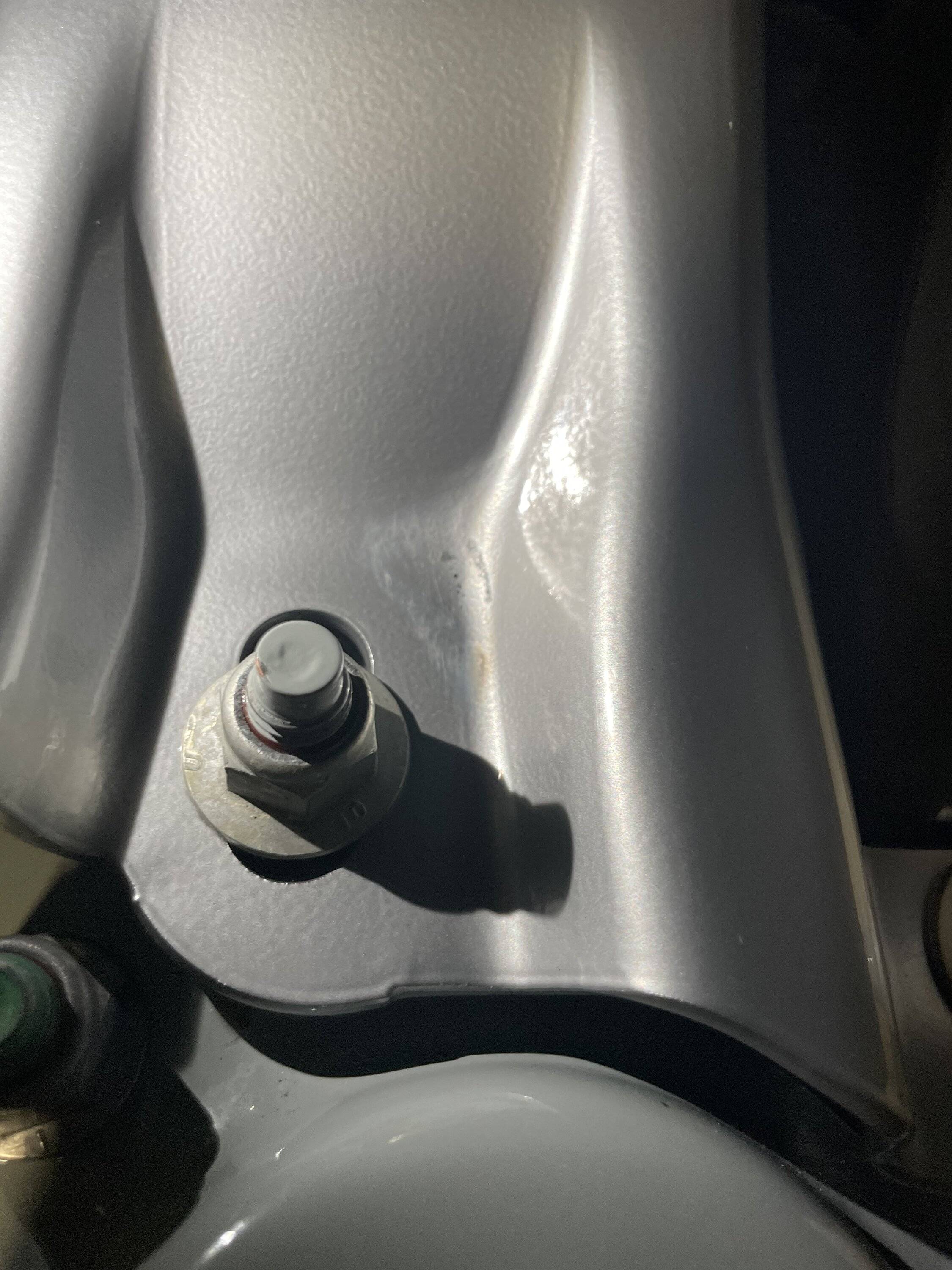

Hello everyone was hoping to find some help here. I Went to clean the engine bay on my 2021 Mach 1. When I started cleaning the cross brace the Meguiars all purple cleaner left a white coating over the cross brace and I am not sure if it took paint off as well or if is just dirt. I tried a damp microfiber towel to wipe it off but I can’t get it off. Any ideas or help is greatly appreciated. I didn’t have the best lighting since it was the evening in my garage but I can retake more photos in the morning.

If just residue maybe try WD40.

An alcohol wipe should get that off real easy

I tried but no luck it seems like part of the paint definitely came off with that detail spray

No doubt it's this.
OP: I have had Simple Green remove paint so it is entirely possible that this stuff did the same to your cross brace. I dilute 50/50. Thankfully, the spot is under the hood. By chance did you leave it on the surface for an extended period of time? Were you using a towell or a brush? I'm gonna guess, a rag. Obviously, Ford doesn't put much paint on that brace.
For engine bay cleaning, it's generally considered best practice to soak the area with an engine cleaning product, agitate with a detail brush as necessary, than rinse and air dry.

These strut tower braces are "silver powder coated finish".
Meguiar's All-Purpose Cleaner if not diluted correctly could have caused a reaction with the finish. I say that in the assumption you used the green dilutable APC sold by the gallon, which is then diluted to suit the cleaning power required. In which case, what was your dilution ratio?
Meguiar's® D101 Detailer All Purpose Cleaner, 1 Gallon (meguiarsdirect.com)
Also, did you remove the product residue before it dried?
APC's can do this sort of thing, they are highly alkaline and unless removed via water to neutralize that alkalinity, the white spots will be the result.
Sometimes, removing like with like can work. Also try using an IPA product. Failing that, try using some polish on a test section and see what you get.

It’s the green all service cleaner. I was using a brush then a rag to wipe it off. Lesson learned here. I have the paint code to touch that spot up in the future. It’s unfortunate I see so many people using this product.

apc will never remove powder coating if used correctly. There is something else going on

From what I am reading I don't think I diluted the product enough. From talking to others quite a few people don't dilute as much as people are recommending here. Thank you everyone for the advice.
