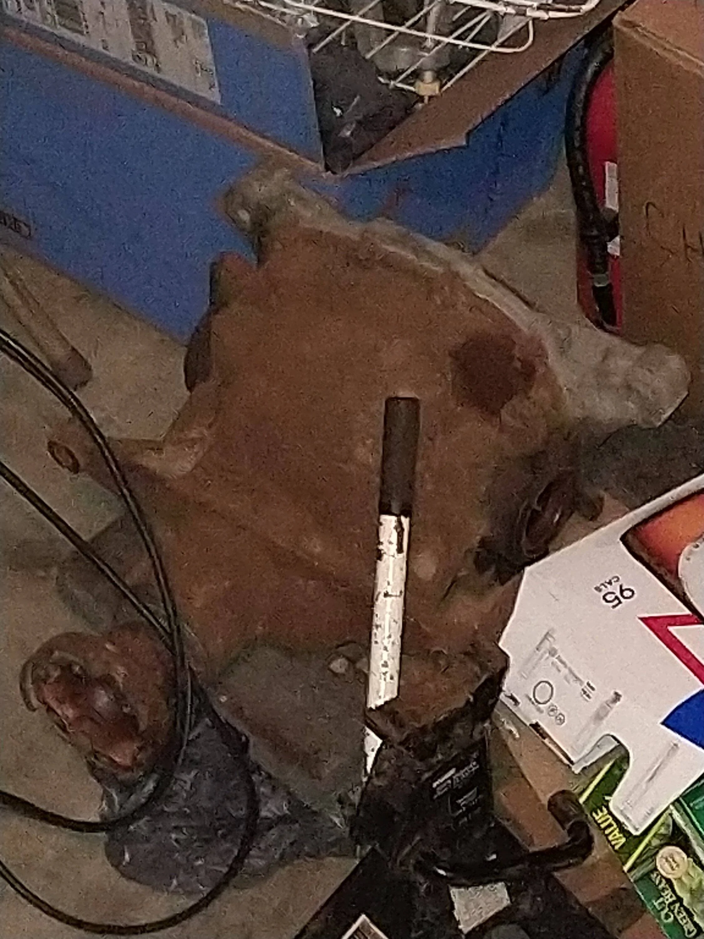

Looks like I got lucky with my $275 eBay purchase. It has a steel housing!
Does anyone know if the Mustang axles are a one size fits all??
Cast Iron housing adds 20# over the Diff brace on alum though, and the aluminum diff with support is stronger than the Iron without the support. Hopefully it has the correct gears for you. Most all half shafts are interchangeable, as long as they are for an S550.

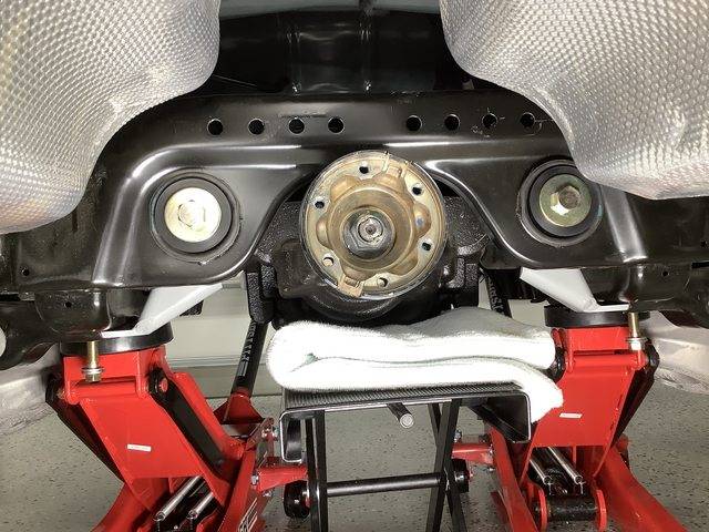

Thanks for posting the video! And that's the way I'd do it, if I had a 3 man Crew and lift... But, I do all my own work by myself and only have a scissor lift (which 1k times better than I've had in the past), so I was thinking of pulling the complete rear cradle out and upgrading everything, in preparation for the possibility of a future 700 HP motor/tranny combination.
I’m with you. I pulled mine with two floor jacks and motorcycle scissor jack (as seen in post #10), by myself. I just kept alternating between all three jacks when lowering and raising the cradle. Certainly not the best way, but it went smoothly.
