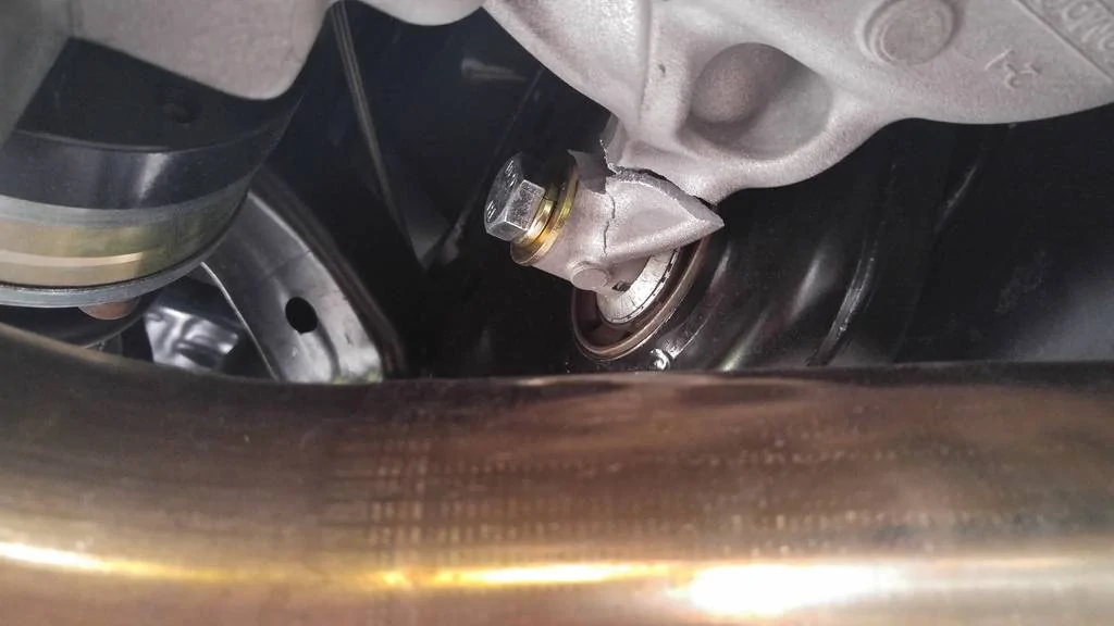

Consider upgrading to the steel differential which is found in manual transmission cars, as the ears have been known to break off on the aluminum differentials. Better half shafts (whether they be GT350 or stronger ones). I think the differential can break with less power than your friend is anticipating under the right set of circumstances.
Guessing this was from some massive wheel hop? The differential had to have over rotated back and forth pretty extreme for this to happen.
Must of been! But, if you can pick up a steel housing, your be ahead of most and I believe there are aftermarket bushings available, as well as other devices to stop the hop and reduce wheel spin.

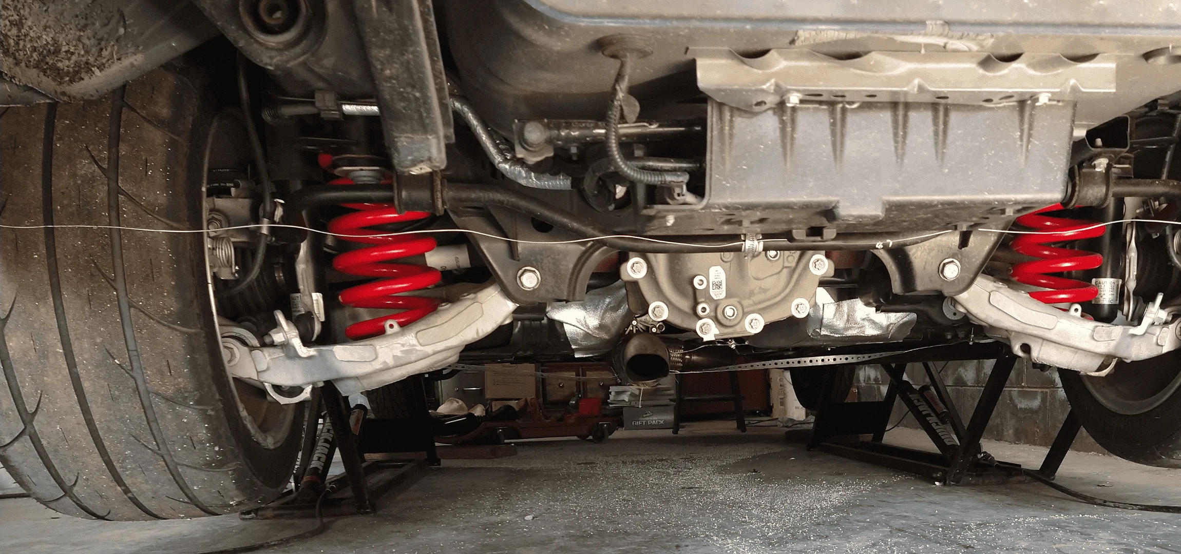

Thanks for posting the video! And that's the way I'd do it, if I had a 3 man Crew and lift... But, I do all my own work by myself and only have a scissor lift (which 1k times better than I've had in the past), so I was thinking of pulling the complete rear cradle out and upgrading everything, in preparation for the possibility of a future 700 HP motor/tranny combination.

It's a bit tight under there... lol
Are those quick jacks? My quick jacks 7000lbs and the thicker pads raise my Stang up pretty darn high. Looks like your is barely off the ground?
Coyote Chase
Sep 18, 2020
515
253
Don
2010/2018 Mustang
Mine only go up one notch, I think they went up farther when they were new. Can't remember! Guess I need to pull out the manual and do some troubleshooting??
