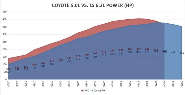

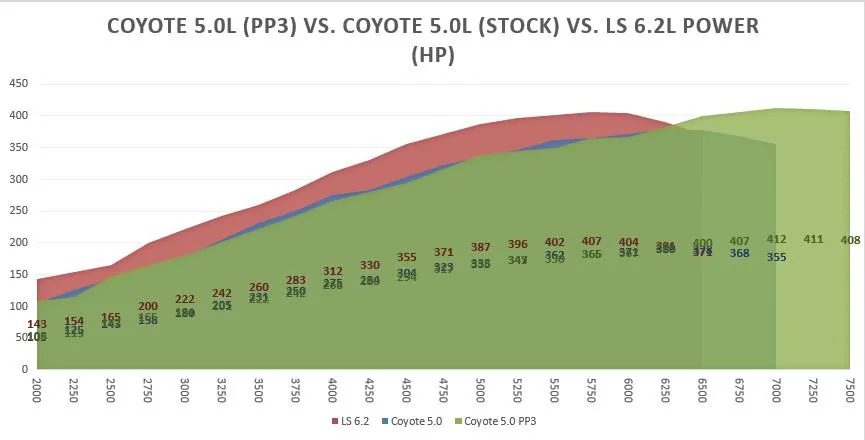

PP2 makes about 6~8% more total power over the rev range than stock. PP3 makes about 13~14% more total power over the rev range. I have not yet integrated the power curve of a PP2 dyno so I'm only estimating it's total power gains, but I did do it for the bone stock 5.0, the LS 6.2 in the Camaro / Vett and a PP3 5.0 from MotoIQ's dyno graphs (they used the same car, on the same day to get all their data, very comparable).
PP3 absolutely makes more power, it has a more linear as the torque curve which is very flat, making it easier to get the power down, which is the biggest issue the first get S550's have. The stock IRS is far to compliant and has very substantial oscillations (aka wheel hop). PP2 is packing the power in a shorter but peakier torque curve = not good for going fast on a car that's already geared super low. PP2 may actually feel faster than a PP3, peaky torque curves give you a sensation of more power because your peak acceleration is greater, but the total acceleration is less. It's that sudden burst of acceleration that people perceive as the faster car.
Case in point, take two engines for example, one engine makes 150 hp from 2000 rpm to 4000 rpm and 200 hp from 4000 rpm to 6000 rpm. Another engine makes a constant 175 hp from 2000 RPM to 6000 RPM. Which engine is making more power? Well if you just quote peak numbers, the engine making two different power levels has a higher peak, so you'd think it makes more power (aka the LS 6.2 that makes 455 hp vs. the 5.0 that makes 435 hp))....yet both engines make the exact same total power over their rev range. Power is work being done, period. Total power (how much makes from RPM A to RPM B) is the total work it can do and that equals acceleration. It is the SUM of the area UNDER the power curve that matters and of course how well can you get that power to the ground (which is where the GT lags behind both it's competitors, it's IRS just isn't tuned very well for power down as it's set up more as a grand tourer with a smooth and quiet ride).
You can compress the work into a lower rev range by using big displacement blocks like the LS or Hemi 6.4 or you can stretch it out over a longer rev range like the 5.0 and many European V8's and inline 6's.
However the 5.0 has an ace up its' sleeve that the LS doesn't. The LS can't rev beyond 6500 RPM, its fixed valve train (limits your optimal flow to a narrower RPM range) and valve spring rates (valve float at high RPM), tension and compression forces on the rods and bearings don't permit a higher rev range without a re-build of the rotating assembly.
The 5.0 on the other hand uses the Road Runner valve springs, valve lift, cams, rods and crank. Headroom for another 500 of extended operation was built right into the rotating assembly. Not only that, but it makes more peak power in that rev range, so the total power gain is very substantial with a PP3. So I'd estimate the PP3 to be another 2/10th's quicker than a PP2 car, everything else the same.
Higher rev range means you can make power in lower gears longer = better acceleration. More total power = more work being done = better acceleration. The 5.0 was meant to rev out and Ford built right into the Gen 2 5.0's all the goodies of the Road Runner variant used in the previous Boss 302 that would run 12.3's down to 12.0's bone stock with just 444 HP, 11 HP less than the latest Camaro SS.

Both PP2 and PP3 work well with 3.73 gearing, but PP3 can make the most effective use of it. You could also run slightly lower profile 285/35R19's to keep it a bit higher up in the rev range as well where the bulk of the power is made.
Ford Performance track GT's run 285/35R19 tire sizes, little more cornering capability and slight reduction in un-sprung mass. Pilot Sport 4S tires in that size are 3 lbs lighter per a tire than the stock profile 275/40R19, but no they aren't a true track tire. Would best be used for auto x.
I think PP2 is better suited to auto x and street where PP2 is better suited to actual circuit track and roll racing. That meaty top end is going to pull on any of the current competitors unless they are full bolt on or FI.
The 5.0's design inherently is a high RPM motor. Trying to push power at a lower rev range like an GM LT1 6.2 or Dodge 392 is just not going to work. It has to rev out to make it's power. Just two different ways of getting there. You can either use a big meaty lower RPM pushrod motor with tall gearing or you can use a smaller displacement high reving motor like the 5.0 and gear it lower.
I forget who, it was either motor trend or car and driver that tested the 2018 GT vs. the 2018 SS. In a 1 mile drag race, the 2018 GT beat the 2018 SS by over 4 car lengths 30 times in a row. But the GT's suspension tuning just wasn't up to the task when compared to the SS, which we know Ford doesn't set these cars up like track cars, but GM does with the SS. Two different goals, but it shows that when the 5.0 is at it's full potential, combining it's 7500 RPM rev range, Direct Injection and Variable Valve timing, it makes more usable power than a pushrod design like in the LT1. Both the LT1 and 5.0 are within about 20 lbs of each other weight wise and similar overall size.
The LT1 6.2 is a great engine, but you can't add DOHC to it without increasing it's size and weight substantially. So it is what it is at this point and there's not a lot of head room in either the LT1 or the third generation 5.0 on pump gas. Both are close to being tapped out from the factory without using more exotic modifications like E85, Nitro, Super chargers etc.
The Second generation 5.0 however that is in the 2015-2017 Mustang GT's is set up very conservatively from the factory. There's a huge amount of power left in that generation that's just not being used. The rotating assembly is capable of reliable operation up to 7,500 RPM. The intake manifold wasn't even set up to flow well past 7,100 RPM...the factory rev limit is only 6,800 RPM even though the factory manifold does just fine up to 7,100 RPM...it's a seriously neutered variant of the 5.0 unlike the first and third generation 5.0's which don't have a whole lot of head room left on pump gas.
PP2 taps into the potential with more or less a tune and intake. PP3 swaps out the whole intake manifold and is why PP3 costs 3x as much. The intake manifold alone is about $1k...
