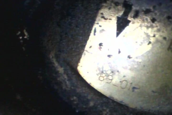

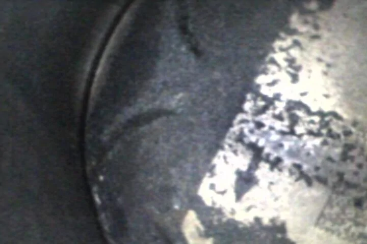

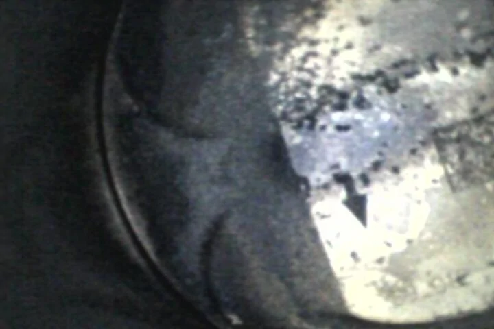

Today the weather was in the mid-70s and I was able to use a bore scope on all 8 cylinders but it was hard to see the intricate detail of each cylinder wall. I should know more once the shop lets me use their scan tool to shut down cylinders to further diagnose the issue. I did a compression test again today about an hour after the car was driven 40 miles and all 8 cylinders were above 168 psi. There is some carbon build on the pistons but i was amazed to see the part number, qr code, and arrow pointing to the exhaust side. I will probably order a new short block next week and document the tear down and send everything into Ford for their situation awareness. Maybe it was the luck of the draw with a bad assembly or me being over protective and not beating the piss out of it every single day. Back when I had RX7s and 8s you had to redline them every day to clean the carbon out. I probably would have ended up with the same issue if I just cranked the car up and held it at redline every morning even with 100 psi of oil pressure.
