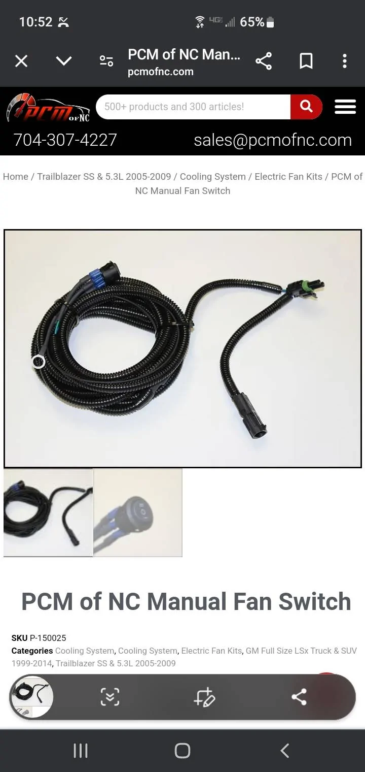

Does anyone make a plug and play manual fan control so the cooling fans can be turned on when needed otherwise they turn on automatically. I had a TrailBlazer SS with this and it worked great for cool down in the staging lanes

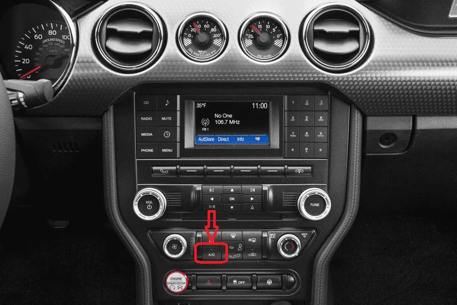

Lucky for us, Ford already thought of it and installed just such button in every car. It can be used to turn the fans on when switched on, but otherwise if turned off it lets the PCM control the fans automatically.

this allows the fans to be on without the car running
Do you have an electric water pump (whether for the engine or an intercooler)? If you don't, then it doesn't really matter. Mechanical water pumps only move water through the engine and radiator when the engine is on, so if you're trying to have the fans on but with the engine on and no water moving through the radiator then it's pointless.

all i know is that it cooled my Trailblazer down really quick
Well unless you changed it yourself to know specifically, I'm gonna go ahead and say you don't have those. So trying to run the fans with the engine off (and the water pump not spinning) is pointless and won't do a lick of extra cooling.
Of course with the engine off not creating heat from combustion, and with fans running plus waterpump spinning it would cool down really quickly. But again you need some sort of water pump that works while the engine is off to make a difference.
