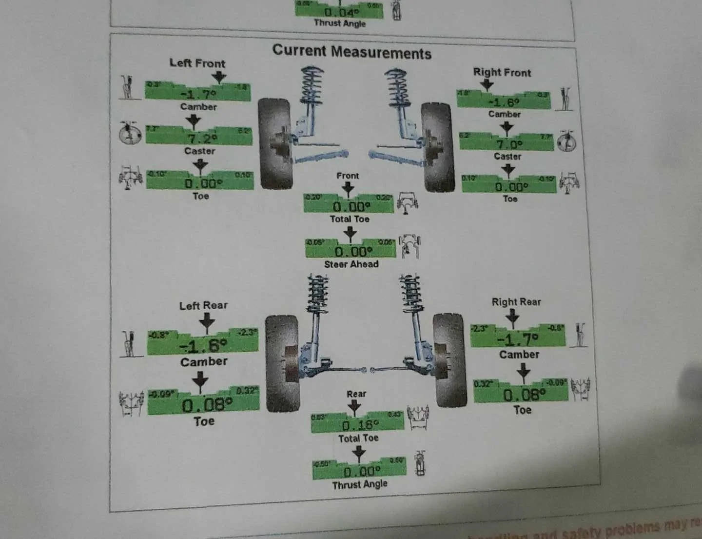

OK, so zero toe up is something I will look at. I def notice the steering in the highway is more darty that I would like (since I made the toe out change), at the same time, I'd hate to kill the turn in.

The GT350R alignment settings are less than you would want to run. For the street, -1.8 front camber is a good place to be. A little toe in can help stability and tramlining a bit. The front camber curve stinks, so you need more for max front grip. Also a stiffer front bar is a good thing to have. -1.5 camber in the rear is good compromise between cornering and rear traction.
With zero toe up front my steering is responsive and good turn in on the street. It's good at high speed but a little sensitive like yours is. A little toe in would make that better tbh. But it's a balance and you have to give up something. I would try 0.00 toe or 0.02-0.03 per side and see if you like that.
Our setups are fairly similar. Our front rates are close enough to be the same and my rears are only a tad firmer. These are the specs I ended up at.
