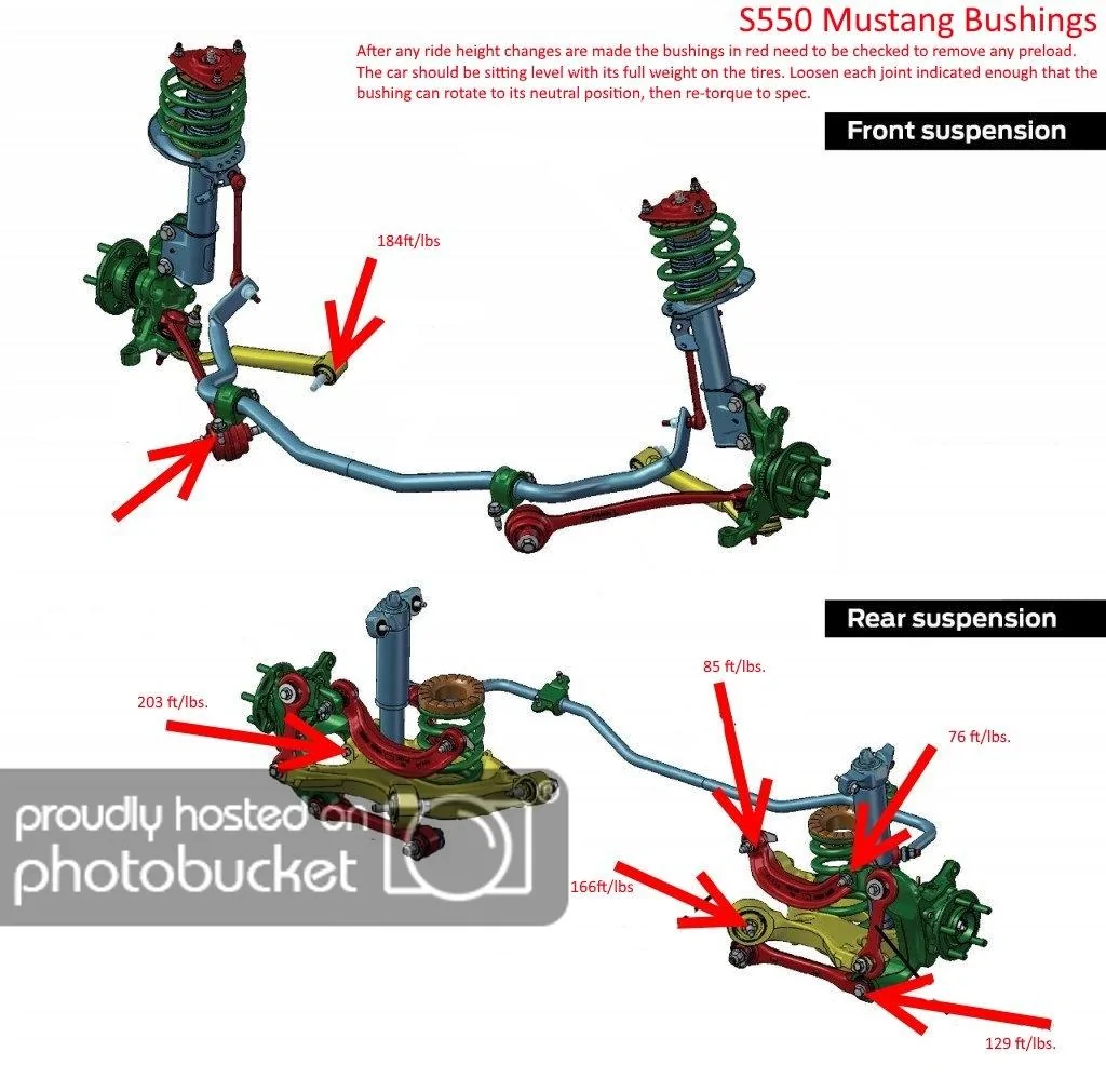

Did you clock the bushings after install, before the alignment?

I personally did not, so I would think not. I will have to see if the performance alignment shop I go to next weekend will do this for me. What issue do you think this would cause ?

Soften up those konis a bit, that combo isn't going to ride perfectly smooth no matter what you do but it should not feel unstable.
What bumpstops are you using in the rear?
BMR discusses the issues it can cause in the thread linked below. From what you're describing, this could be at least part of the problem.
https://www.mustang6g.com/forums/th...hose-bushings-after-lowering-your-s550.44129/
And here's what the shop should do:

The bushings not being clocked could cause the sloppiness you're feeling, it might be a pain but make sure the shop loosens ALL the pivot points before aligning, not just the ones that are easy to get to.
I will have them give this a shot this weekend.
Could this also be a reason it’s “hard to get into spec” or not able to fully get into spec as I heard from the regular shop that did it this past weekend ?
