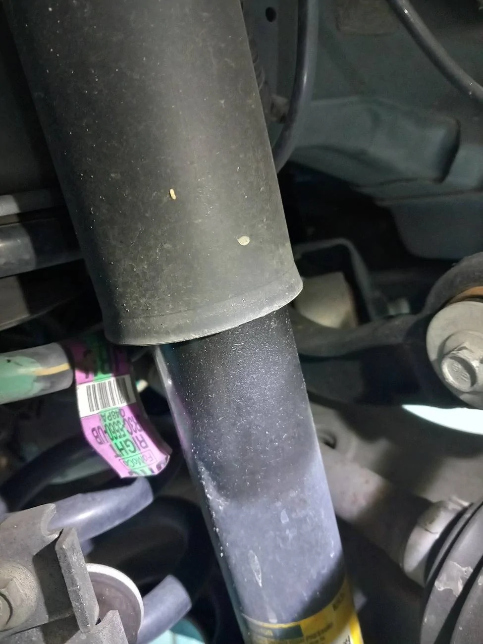

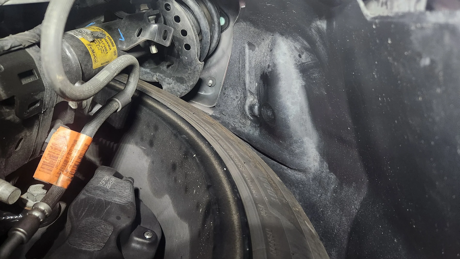

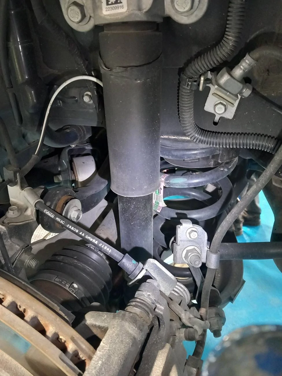

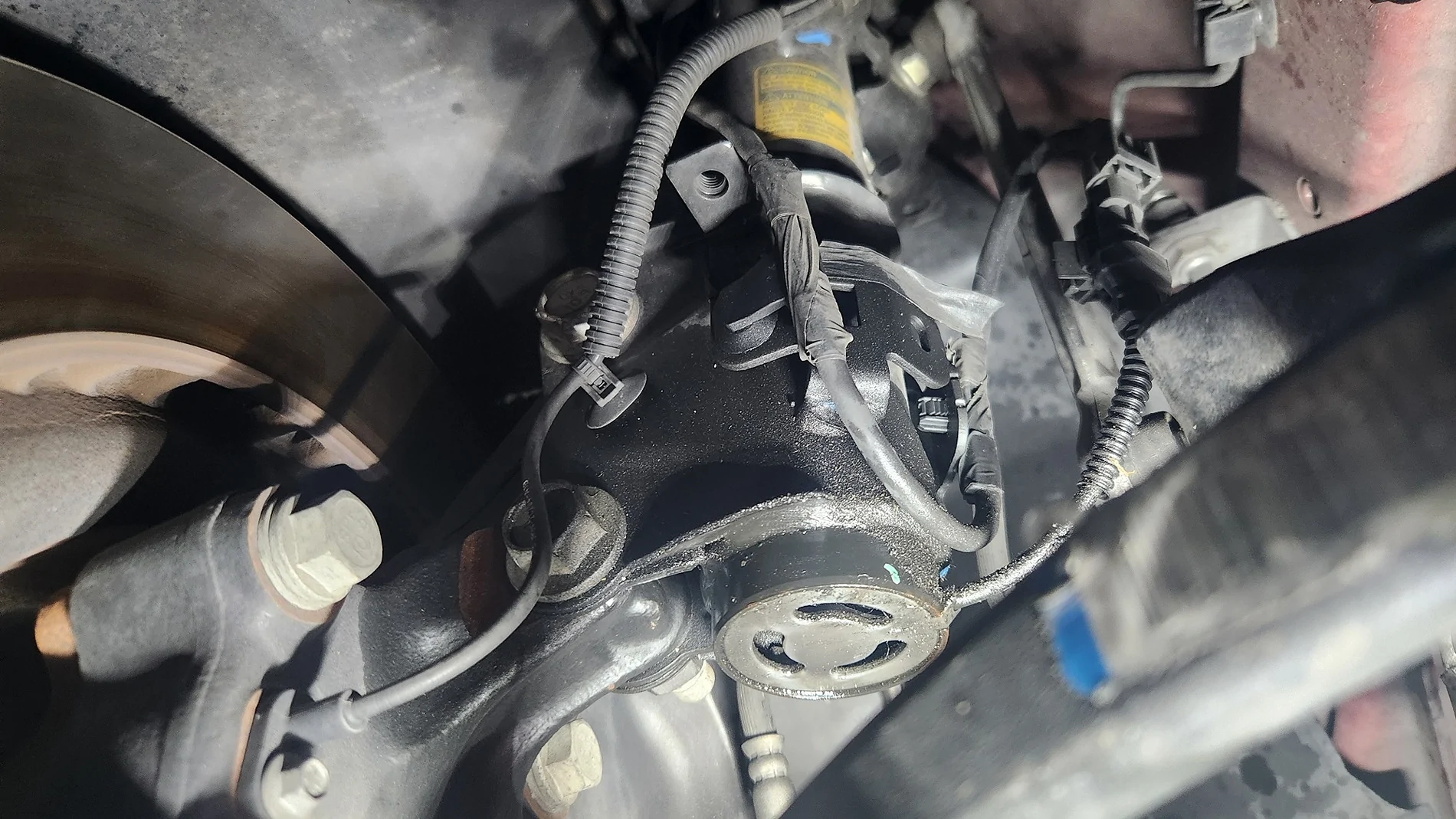

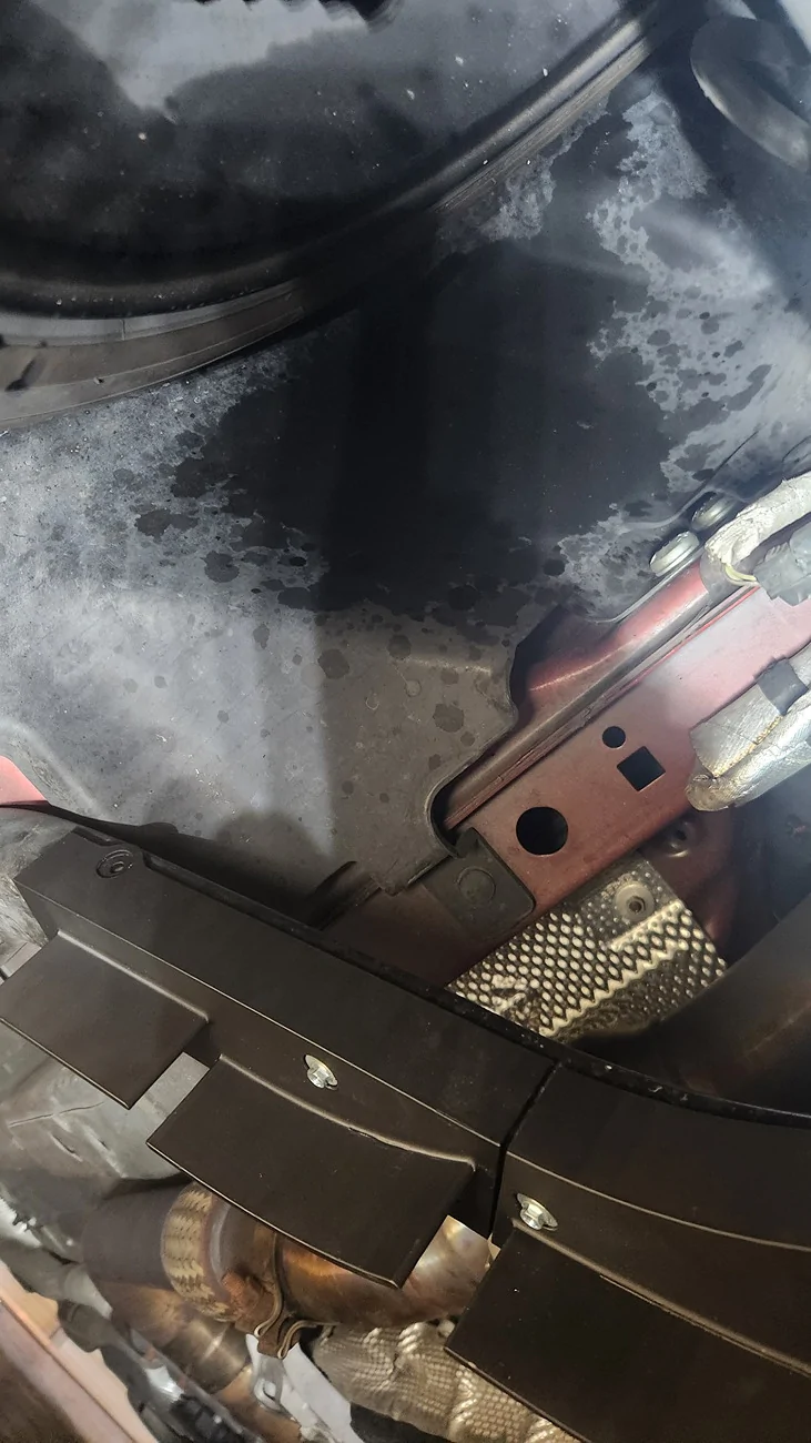

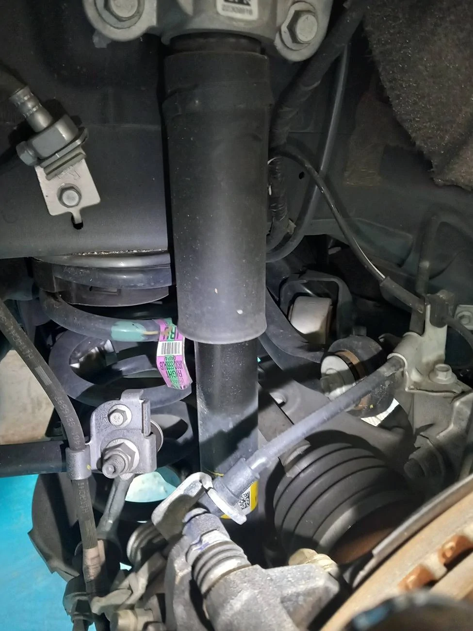

Hey guys! Apparently I got a minor leak at the rear shock absorbers after just 25k miles, so Ford will replace both rear shocks by warranty. Do you know if they are the exact same OEM component regardless of having Magneride? They said there's nothing to do here with MR, it's all the same shock absorber part.
For anyone interested, I got these photos from the mechanic:
