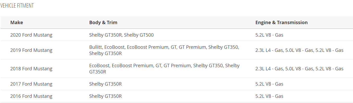

lenFeb
Dec 31, 2019
30
956
846
USofA
Len
2019 Shelby GT350 #K0110
Seems like they change something. Started from 2018, it can be fitted to both base and R.
Then changed for 2020, GT350R and GT500 share the same struts. But not on GT350 base starting from 2020. Contact FP to make sure which one is which.

stanglife
Jul 6, 2014
180
7,046
5,785
Jeff
1993 Coyote Coupe
The part numbers are the same through the years for the hardware on the 350...and again the same for the 350R through the years (but the 350 and R are different from eachother 100% of the time). If the screenshot you posted is from DSC, maybe they are just listing compatibility with software modules only.
