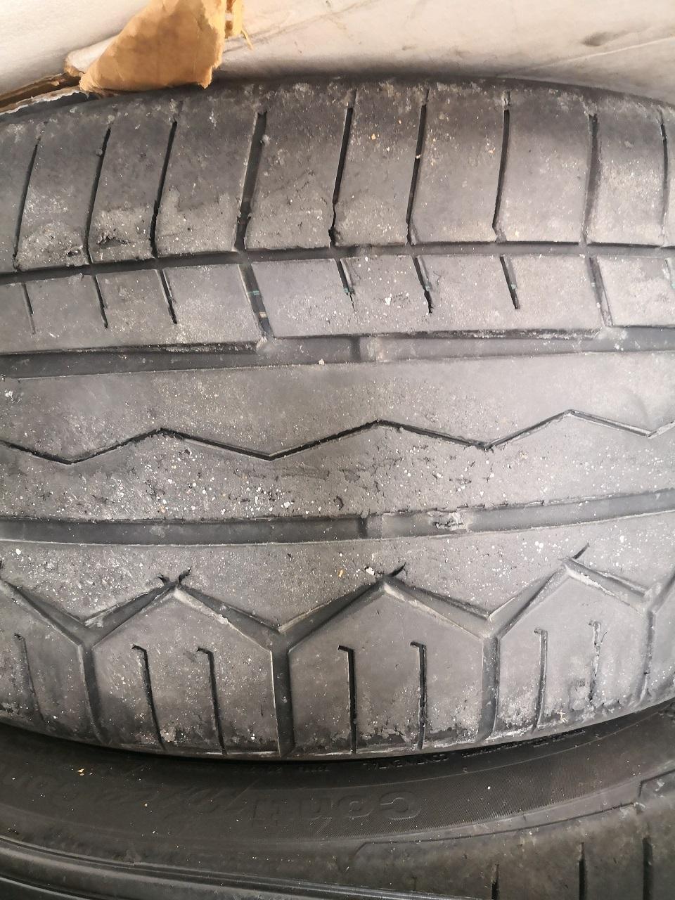

I asked Mike how they arrived at those settings. It was a track test on a GT350R. Presumably, Mike did what he does with race cars - set it up to handle well and go fast. Mike's a pro, and he can get a lot of information out of a couple of laps, so tire life may not have been a factor in his track testing. We didn't talk about that, so I can't say.
But we did talk about the 1 degree limit on rear camber. He told me that setting the rear camber over 1 degree degrades the handling. His words were "the rear end starts to steer the car". To me, that's interesting because the FP Road Course Alignment Recommendations card also shows 1 degree of rear camber for the GT350R. It sounds like DSC tried more camber and decided that FP had it right in the first place.
I have a GT350, non-R, and I'm running about 1mm of toe in at the front and rear and -1.8 front camber and -1.1 rear. I've been running a 2012 set of Conti ForceContacts in 305 square lately and after three track days and one rotation, they're wearing very evenly across the tread - much more evenly than the MPSC2's I ran last year. As an aside, the Conti's are surprisingly good tires - my VBox Sport logger says I'm getting 1.2 lateral G's regularly and I've seen up to 1.4.
The tire in the picture has three track days this year and about 2000 highway miles. Measured in places where there's no pickup rubber stuck on, tread depth is 6/32nds in the middle and 5/32nds at the edges. All four tires measure exactly the same. I'm running April 2018 DSC firmware along with a DSC calibration file dated 01-01-2018.
