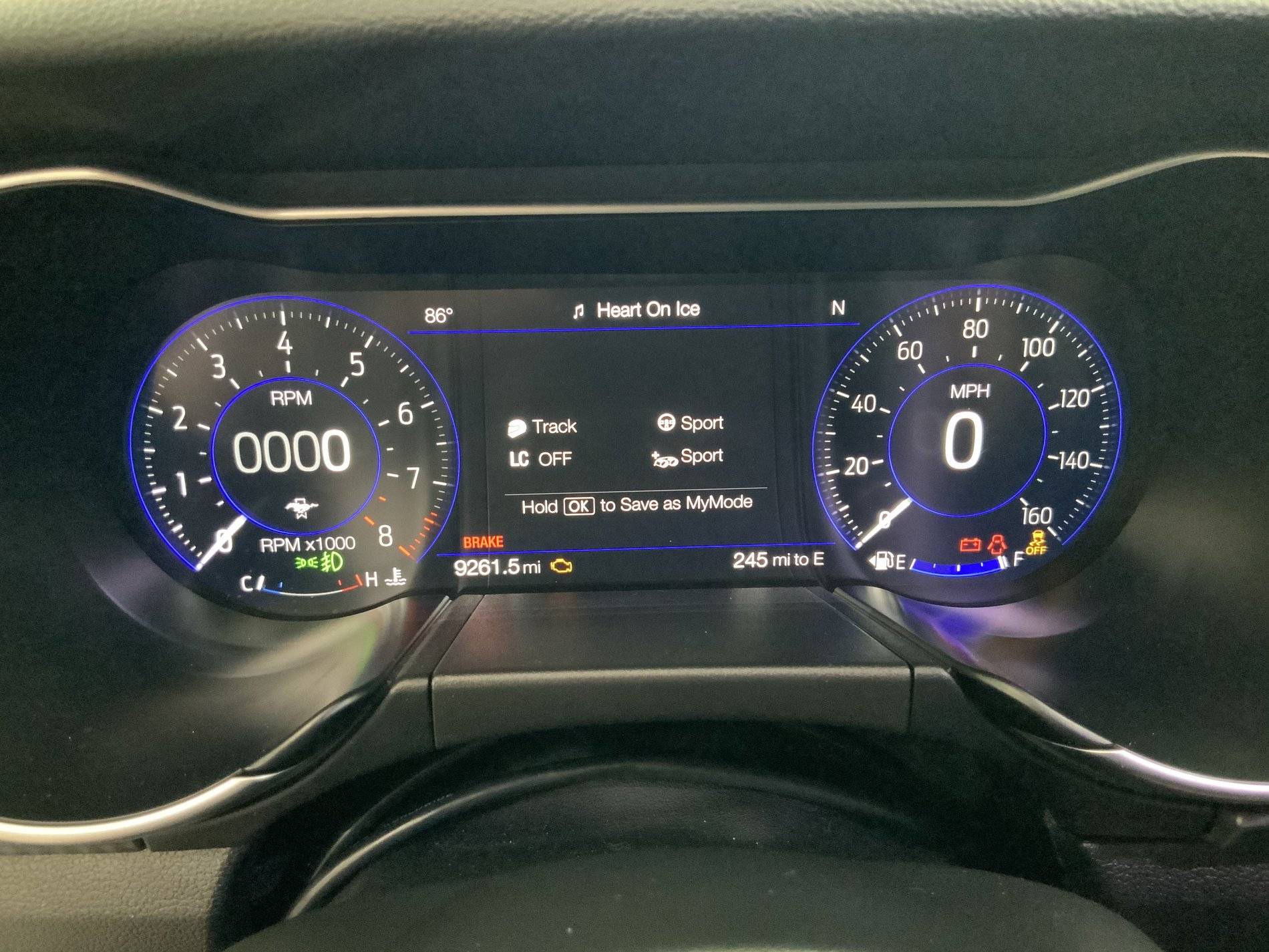

Ha...I'm with you lev 21...I don't feel much of a difference. Quite honestly, not knowing if magneride was working is what drove me to figure out the "shock" icon display via digital dash...to see if magneride was in the correct driving mode. Apparently it is. What makes me believe its working is there are no error codes (DTCs) associated with magneride when I use forescan. If it wasn't, I'd suspect I'd see a few DTCs and even an indication via the digital dash.
Gixxer...did you have the magneride "shock" indicator on your digital dash? If not, did you try the fix above? I want to hear from someone outside of myself that it worked for...
I do not have the shock indicator, I haven’t tried it yet. I guess I can try today, but I can feel the difference so I know for sure mine is working, even my fiancé knows when it’s in track or normal when riding to my friends over the mile and a half bumpy road.

Got a dumb question! how do you guys change the shock mode? is it through driving mode?

How do you guys change the shock mode? is it through driving mode?
Unfortunately, yes. You can only change it with the drive modes. The manual doesn't say, but it's like this:
Wet/snow- normal
Normal- normal
Sport+- sport
Track- sport
Drag- sport
You can change some things within driving modes, but there are restrictions. For example, you cannot select comfort steering on sport mode. You also can't select track exhaust in normal mode; it changes MR to sport (felt it immediately), so it must have changed the driving mode to sport+ or track (probably the latter). So just play with them, and store it in MyMode. Hope this helps.
