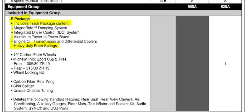

Just sayin'
R "Includes track package content:"

Just sayin'
Yes, but what is HD springs? This says the 240lb springs are only on the R.
Clearly, we have conflicting info.
