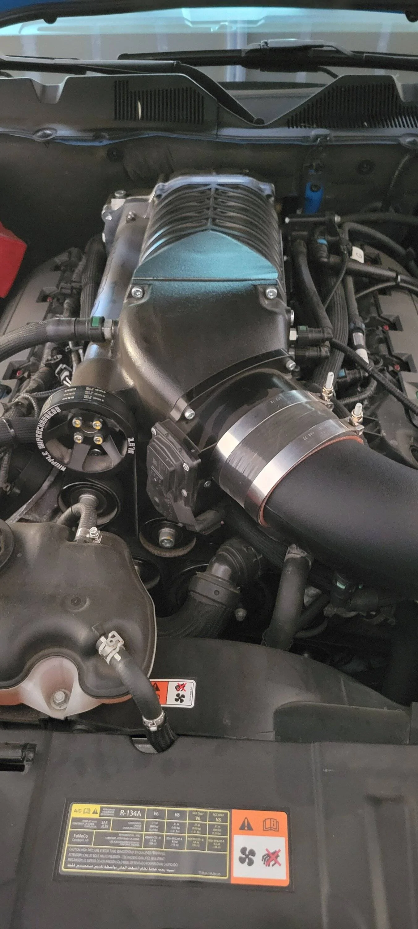

Looking for some opinions on which whipple stage to go with. I have a 2014 gen 4 stage 3 and the tuning with the 132mm TB was a hassle and in hindsight I wish I had passed on the 132mm.
Have there been any improvements on the how the electronics, tune etc for the 132 on the gen 5?
Thanks for any info as this is my first s550

I have a ton of experience with a 132 tb on a whipple. Just not on a gen 5. After 4 tunes from whipple the car still stutters at idle. Has a mid rpm surge. My friend went stage 2 on his 2014. Makes more power with less issues.
Finally turned to the after market to get the car to run as advertised.
