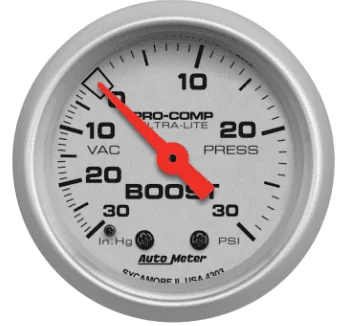

I had this A/F and boost gauge in my 03 M1.
4379 4303
