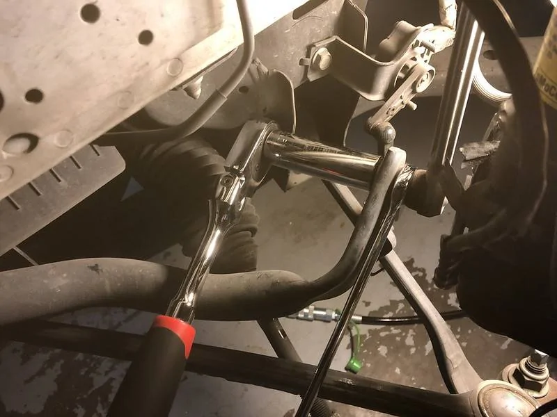

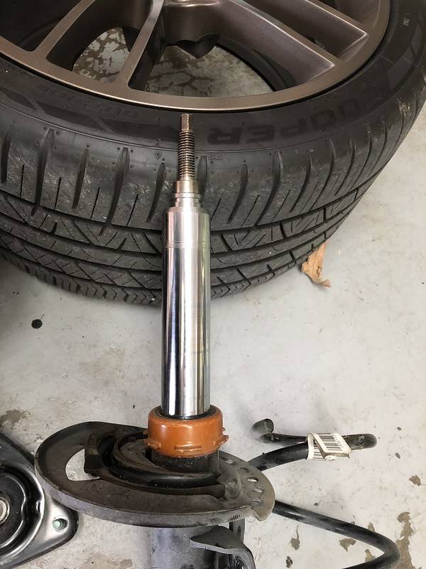

Are you sure about that? According to this thread https://www.mustang6g.com/forums/threads/sway-bar-size-compilation.80809/ the Ford upgraded sway bar is 36.5mm vs 35mm for the BMR. So if the Ford were set full stiff one would think it would be slightly stiffer than the BMR. I have the RTR which is also 35mm and I run it at full stiff. I have not seen any trouble with it. I actually might change it to the least stiff setting for street driving as it is a bit stiffer than I'd like even on Normal mode. When I use Track mode I expect it to be stiffer so that's fine.Magneride cars can only use the 2 softest settings on the BMR front anti-roll bar. The 'stiff' setting fouls the strut. You might make it work if you used rod ends instead of ball-joints, but it gets a little tight...
