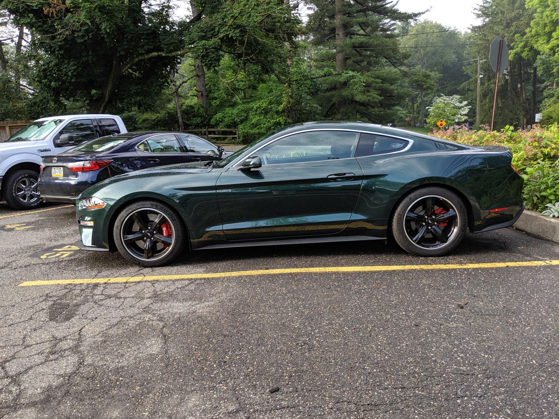

2019 Mustang BULLITT
I just had this installed on my BULLITT. Sport+ and Track are noticably stiffer. Normal only feels a little stiffer. I like the stance too. Only a little lower than stock. I plan to compliment it with Steeda 4pt g-track and IRS braces.
