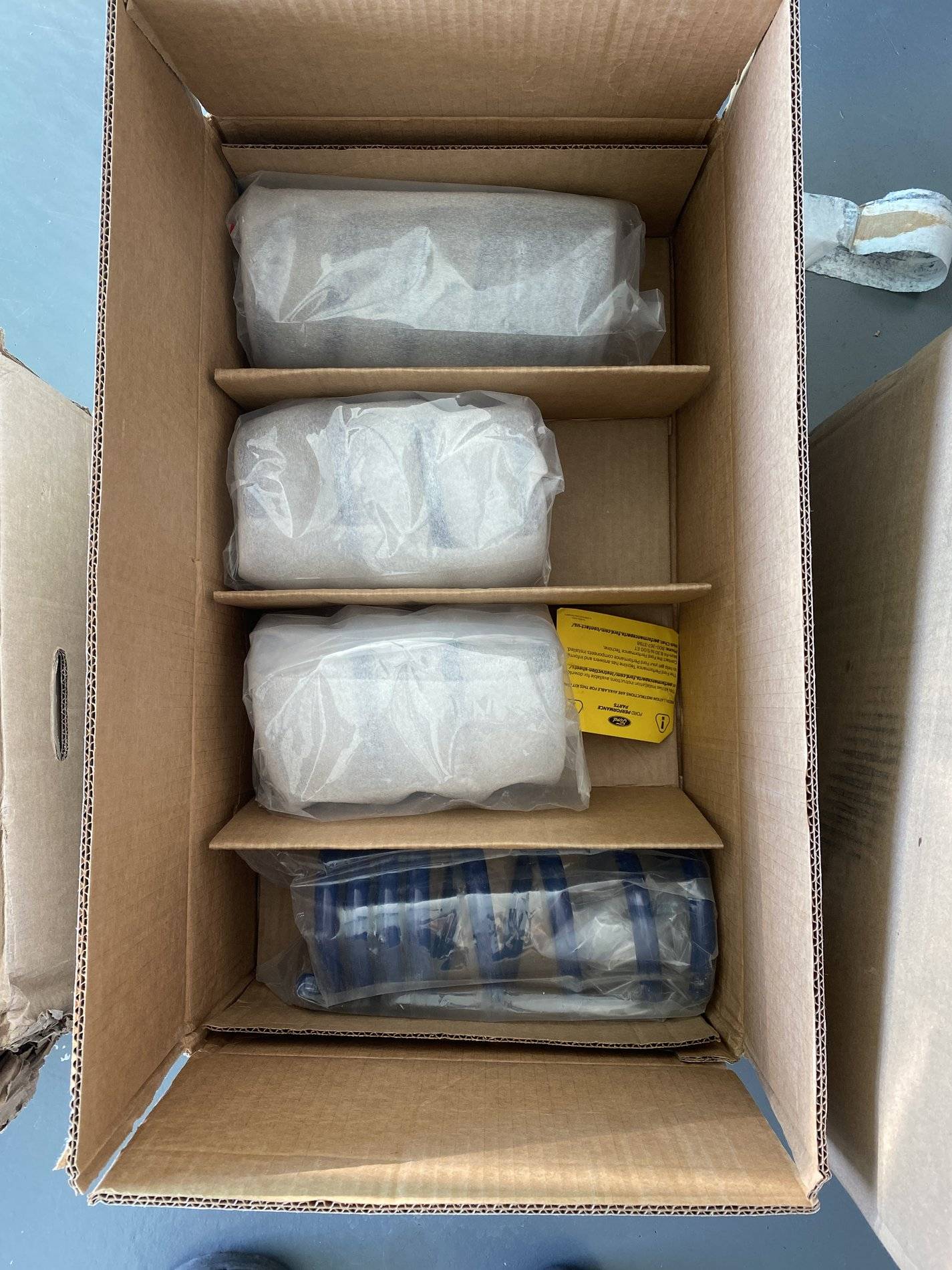

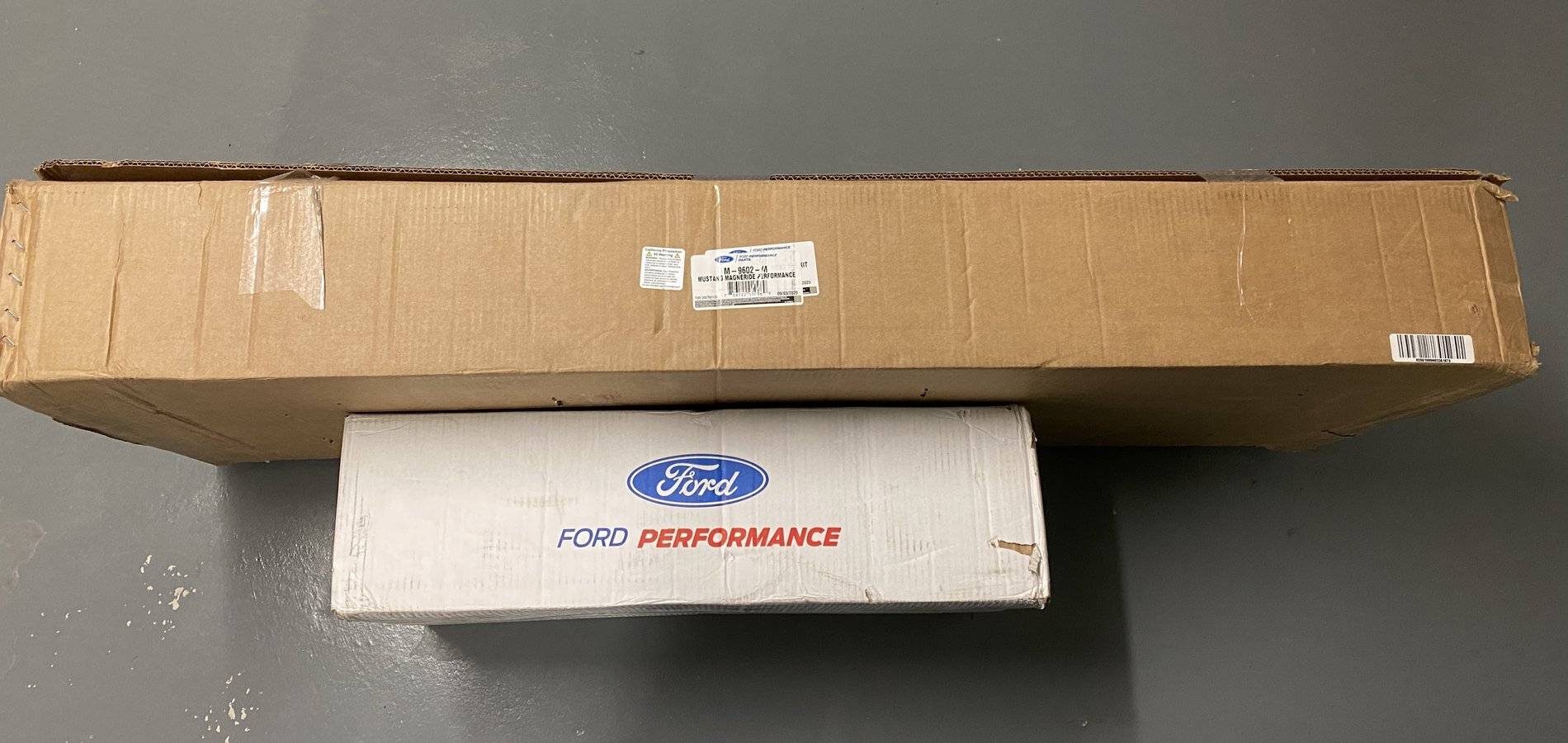

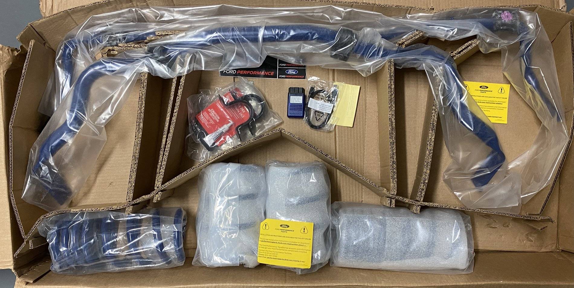

@Chola as @kz said.
Pic’s from my kit delivery.
The last pic is just with all components together. (not delivered packed like that)
The programmer was in the box with the sway bars. Call Ford and get them to resend

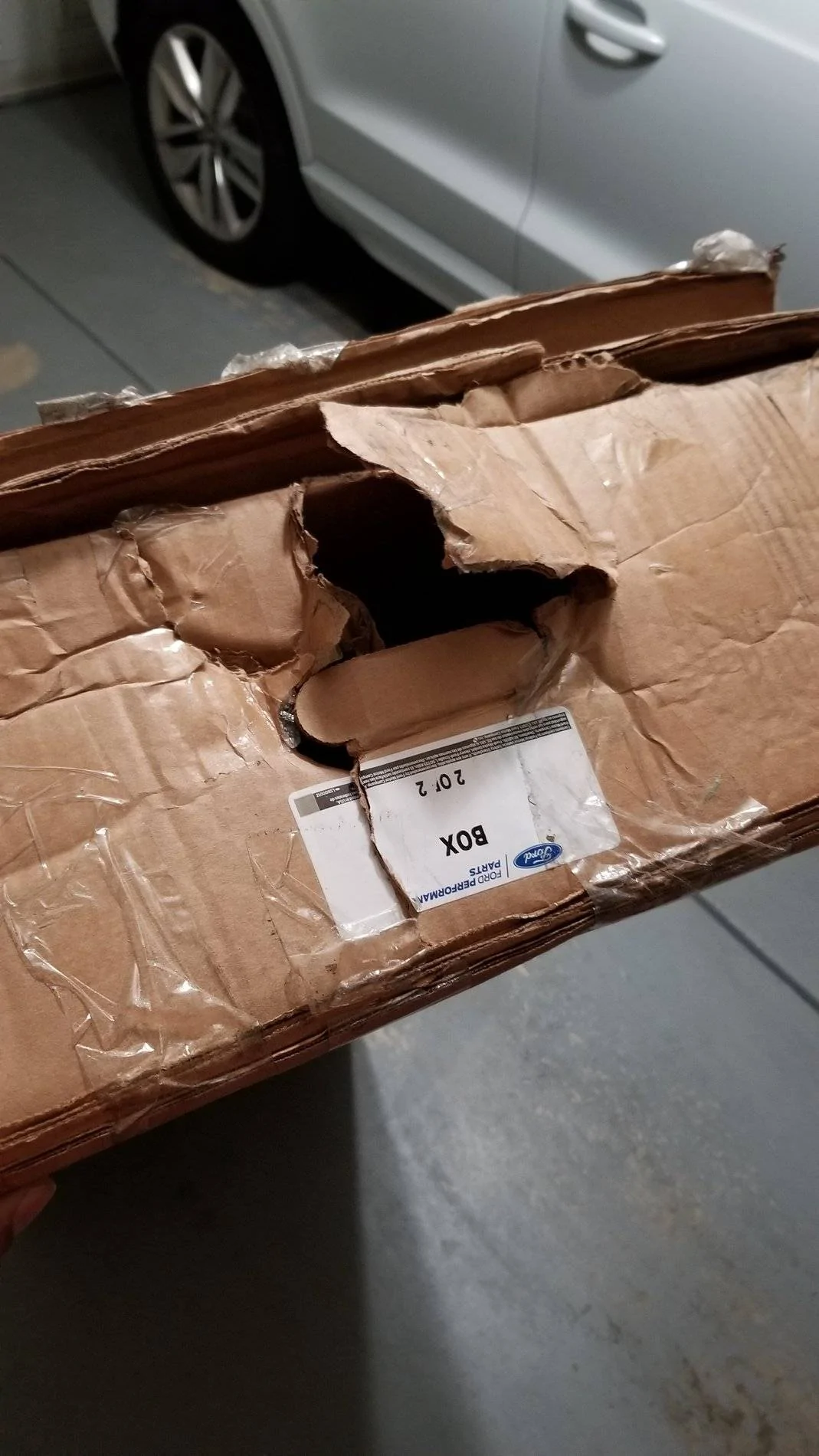

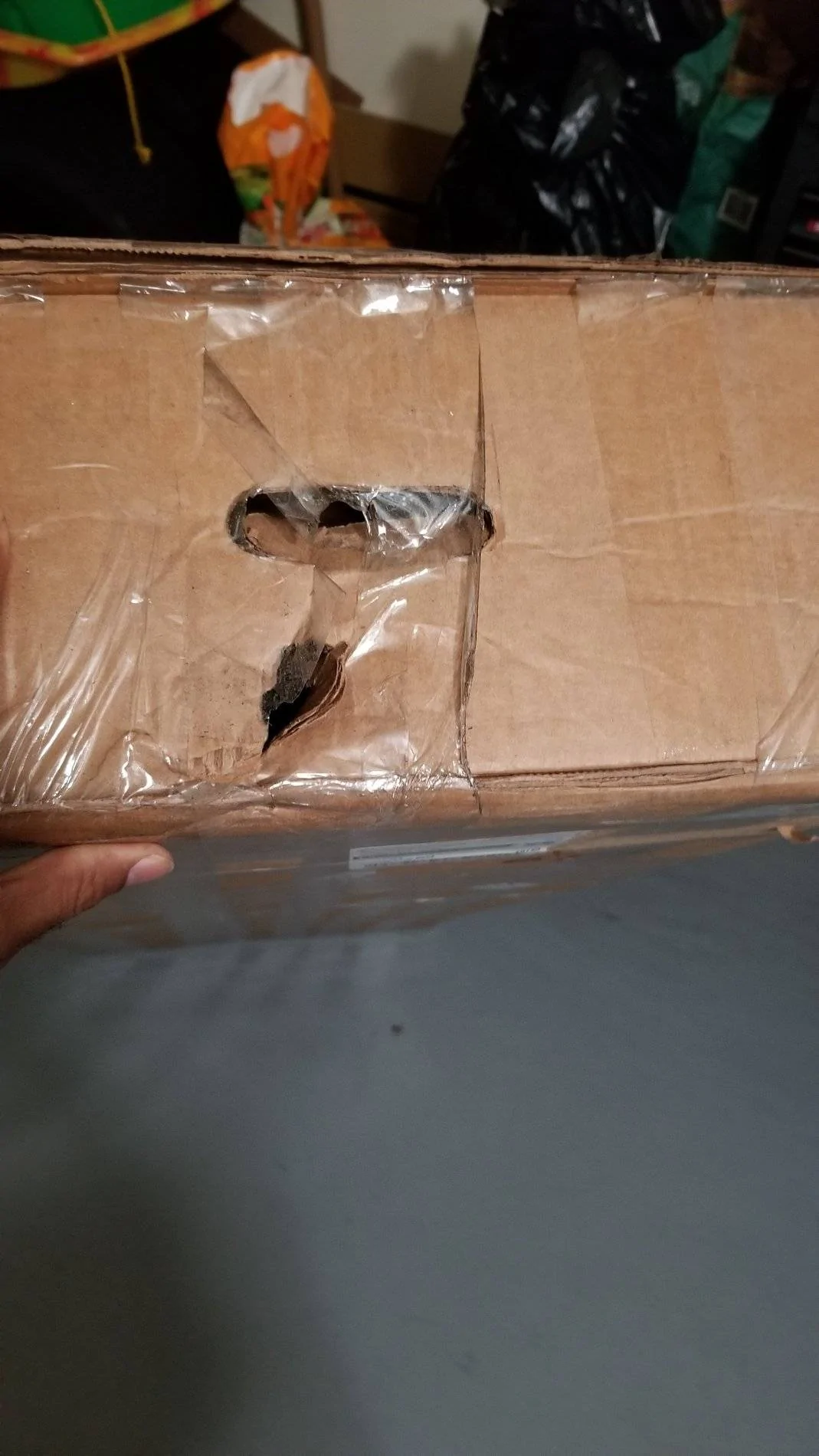

I made the mistake of not opening the small box, just gave it to the mechanic. The big box didn't fit in the trunk and I opened it up. In addition to the sway bars there was just one plastic bag with some nuts, bolts. The larger box was torn on the ends at the handle openings, perhaps due to the package being mishandled by the shippers. Maybe the programmer fell out of that.
